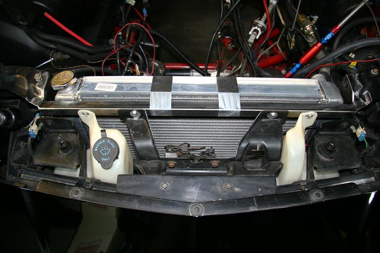

I put an after market griffen in mine, I needed more room to work so I cut the rad support out and welded a 1x1 tube in there in it place, theres a lot of turbo guys doing this with out any problems with cooling
