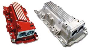

not sure if the runners and all of that are the same, but the outside is not.
the fuel rail crossover(forget what that is actually called) on the front of the intake is straight across on the 93, while the 95 is angled
............95.............................93
Had me worried for a minute.
I bought an extra intake to have it P&P by LLoyd Elliot, so I don't suffer any down time. DUH... for me for not looking at this earlier, but I just noticed the casting mumbers are the same. Mine is a 95 and looks just like the intake I took off a 93 and both have the same casting number (10108630). So according to your pictures they shouldn't have been the same, but since they both look like the picture on th left, I should be good to go.
