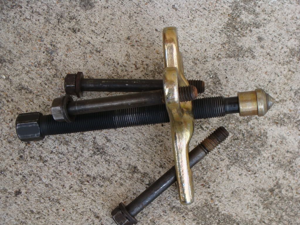

I'm sorry, yes, I removed the three outer bolts and the center (hub) bolt as well. I also read your original post and it got me wondering whether AutoZone gave me the right puller. This is what they gave me:

That's what I used on this Vortec motor. I don't know of any other way to pull one off, since that style insures equal pressure around the hub. Best thing to do is make sure you tighten the 3 bolts down equally, or use shorter ones so they bottom out flush with the hub.

I can try the shorter bolts, but what I am wondering is if the puller is the correct type of puller or not? I'm not sure if it's bottoming out on the crankshaft or the hub and if I'm bottoming out on the hub, which I'm starting to think I am, then I need to get a different puller from somewhere.
Another reason I'm wondering if AZ gave me the right puller is that NONE of the bolts that are included in the puller's box fit in the pulley; they're too small. I am using the bolts off my heads to do this and they are hard to get through the holes on the puller itself.

Pull off the end piece if you think you are and stick on the other attachment. If there is no other attachment, find a small washer that'll fit in the hub on the crank so you don't tighten down the center bolt on the puller and eff up threads on accident.

I used the same tool you are from Autozone to take off the balancer and it came off instantly. It didnt work for me to take the hub off tho b/c the bolts they gave were too small.

i know your problem, its b\c you cant use that kind of puller, you are pulling against yourself. The bottom where the center hole is, well its not very big and the tip of the puller your useing doesnt fit through it.
Old May 28, 2008 | 07:28 PM
93z28_6spd's Avatar
Joined: Mar 2004
Posts: 105
use the puller but leave the center bolt in.. but just back it almost all the way out.. when you dont do this you are actually pulling the pulley against the pulley... so in turn your shimming out the puller with the bolt, that way it pulls it away from the crank... so leave the center bolt in but just unthread it almost all the way ... then when it bottoms out on the bolt... loosen the center bolt .. and repeat.. or hit it with a dead blow hammer ... i hope i helped
