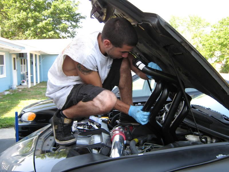

wowwwee. putting headers on lt1 cars is a P.I.T.A! took me 2 days working about 6 hours on it each day. not to bad. these were pacesetter race style Long tube headers. no A.I.R. fittings or EGR. i dont recommend doing this yourself unless you are highly mechanically inclined and have plenty of experience (and a place to throw wrenches and not break anything important!) well im going to do a complete write up on how to install these headers starting from beginning to end. i took plenty of photo's to go with the write up. i did search the forum for tips and tricks to ease the install but i didnt get the details i was looking for. one method i did use to get the passenger header in was to cut a little off the tranny ear wear the starter sits in. the header slid right in after that. did not affect any structure or anything. well heres some pics of me working on it and the end result. ill have better pics up soon. this is just a teaser right now. btw both headers went in easier through the bottom than top.

lol its not installing them thats difficult, its getting all the other junk out of the way! i didnt unbolt any motor mounts. luckily for me the manifold bolts were very loose (unfortunate for the car since it had massive exhaust leaks).
you really need to know what you are doing though when installing these. on a range of difficulty from 1 (being easiest) to 10 id say this is about a 7. not for a novice to try or you'll be scratching your head saying "wtf am i doing?!" haha.

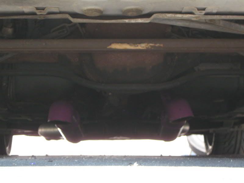

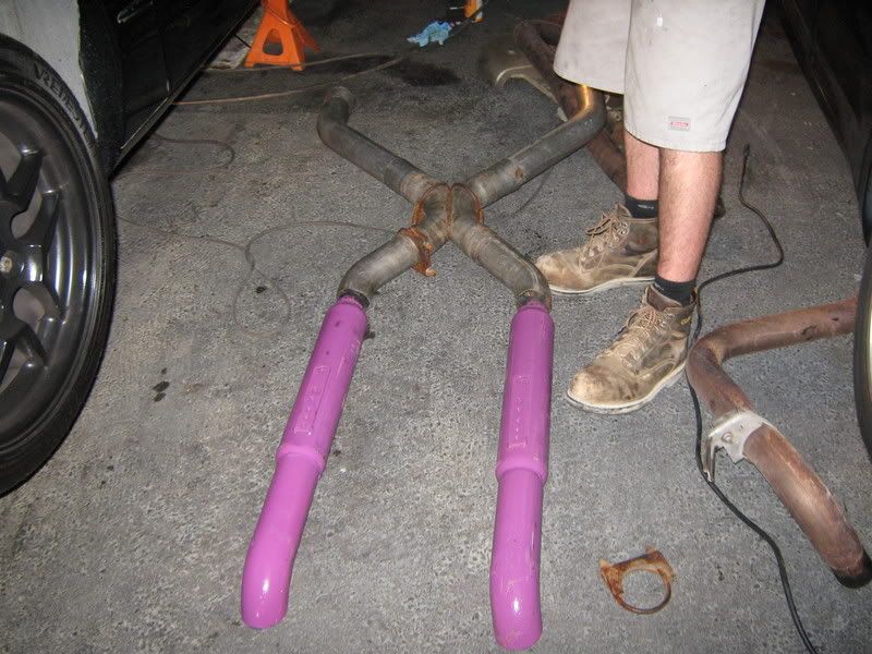

i am always looking to do something different with my cars. i want to lower it but the xpipe is very low to the ground already so i have to try adjusting that. ill try and take a vid of it running and post it. not sure how the sound quality will be.

i took my drivers side valve cover off, the steering linkage and the oil filter and slid the header in through the bottom. helluva easier time than through the top imo. my headers were not coated so i went ahead and spliced extension on my o2's. takes time but worked great and no service engine light (yet). im not going to get into much detail in this thread just wanted to throw a few pics up and some info.

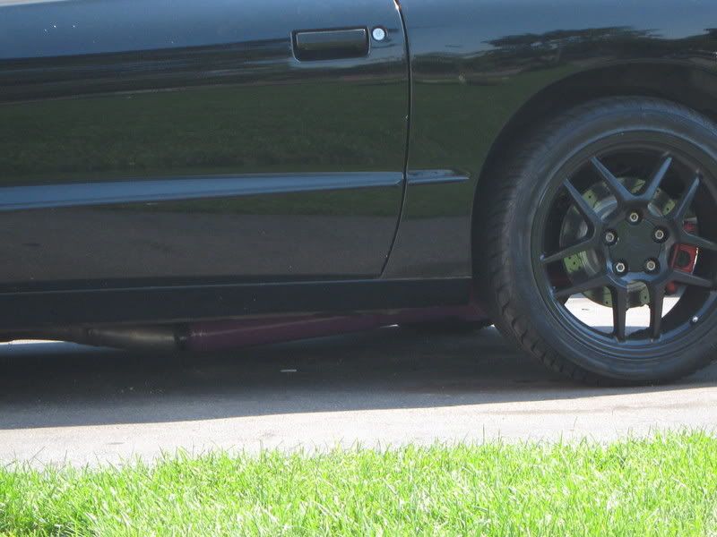

Yes!! they are PURPLE HORNIES!! lol ive always wanted them on a vehicle of mine so why not start with an lt1 car. you can order them at advance auto. $45 bucks a piece. as for fitment so far, the xpipe is sitting a little low i scraped it a few times so far.

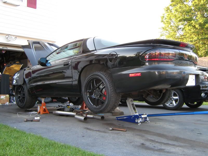

shud be easier with a lift. i had to jack the *** end of the car up to get the right angle for the header to slip in. i dont recommend doing that its unsafe but i only had 2 jack stands so we backyard mechanics use what we got =)

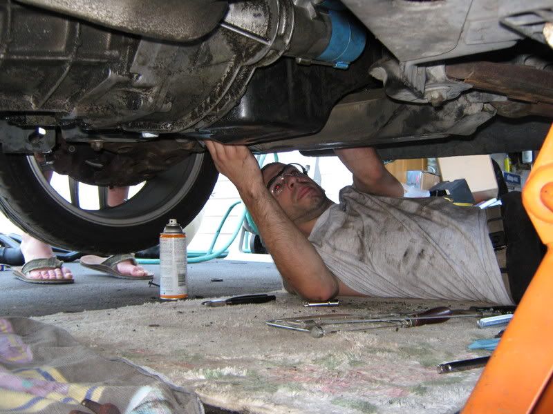

lifted from oil pan.. no cherry picker used
