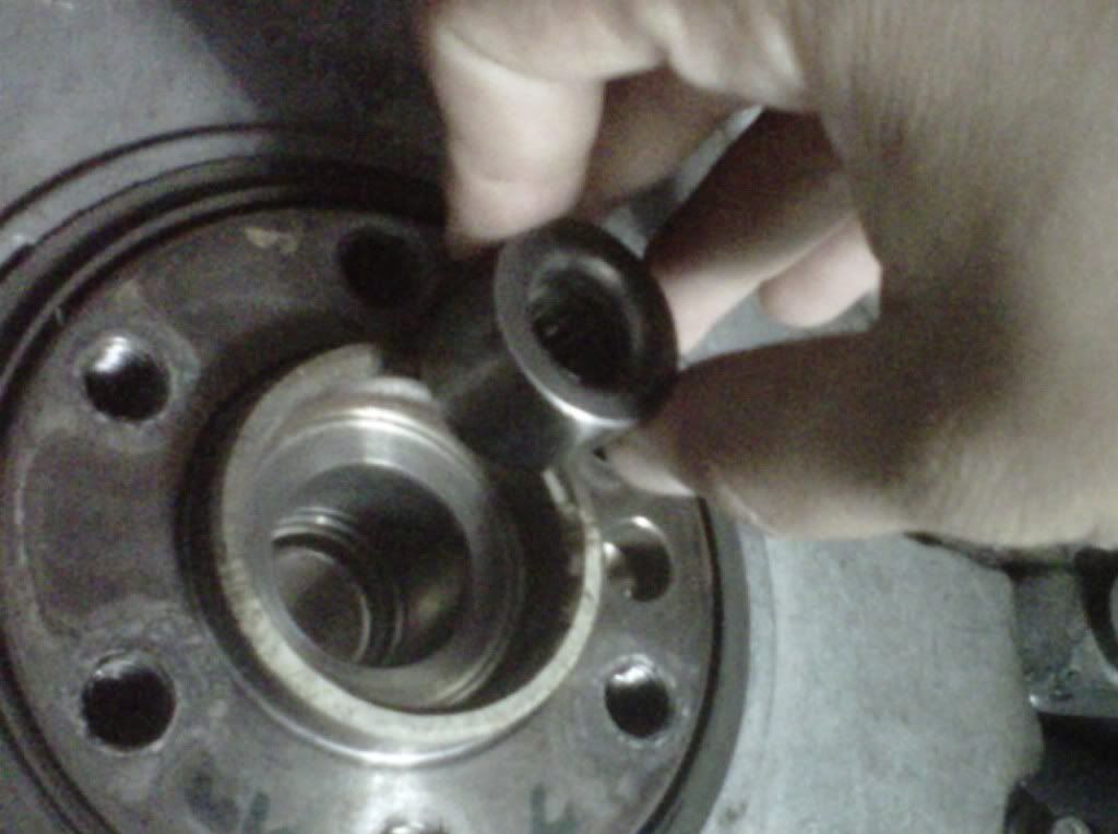

forgive me if this is a dumb question but isn't the pilot bearing missing.? i think you slave is leaking on to and glazing on your clutch assembly. just my .02

well I didn't install clutch first time around and have had no vibrations in vehicle. I will have to check when I'm back to the car tonight but from the pics looks like pilot is gone could be pics though will verify. I know the pilot can cause premature clutch wear. but you think there is anyways for it to come apart. or are you thinking shop that installed originally forgot. clutch has been fine since install other then grabbing higher up in pedal. I will grab another pilot today wondering if this will fix it or if clutch is shot. just still hesitant to go back with same clutch looks like flywheel and pressure ate are scratched up like the bearing might have come apart and got caught in between clutch.

this is what a bearing looks like.
this is a pic i took B4 i installed it. get your bearing from the GM dealership bc from my personal experience, autozone, napa, advance auto parts didn't carry them in stock. there are two different bearings that fit into the crack (big and small) you want the small one. test fit the bearing onto the tranny input shaff b4 installing. this will ensure you bought the right bearing.
but i would deff buy all new clutch assembly and flywheel, as well as a new T.O. bearing and slave.

I'd have the input shaft bearing checked as well as input shaft run out. Without the support of the pilot bearing, that puts a lot of stress on the shaft and bearing.
