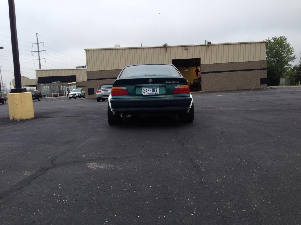

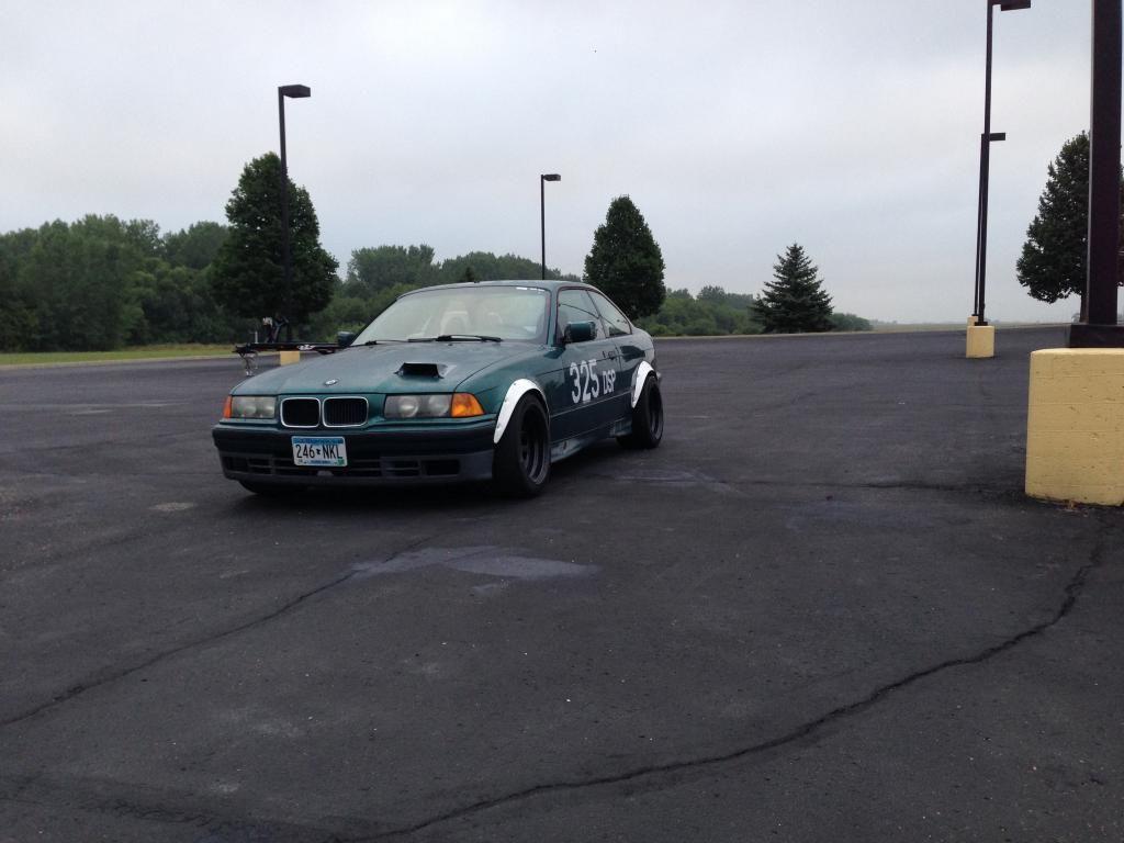

I have a built LM7, makes around 425/425 that I am putting in a 92 BMW 325 that I use for autocross/time attack/etc. Let me start by saying the car was $400 and after getting the suspension all done up I maybe have 3k in it so this next step will also be very budget sensitive. I am struggling to figure out what manual tranny to use for this. the T56 is too expensive and I dont need the the OD either, the T5 I think will be to weak. I am looking for opinions on what tranny to go with and components to to make it all work. so fire away!
