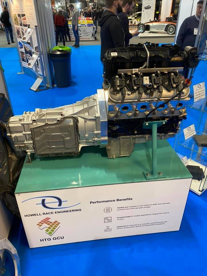

https://www.facebook.com/eliseracing/photos/pcb.2537958293155941/2537953086489795/?type=3&theater
The two main companies offering controllers are DKG and GZRacing with their HTG tuning controller.
But as mentioned both do require re-wiring of the mechatronics unit in order to achieve control. I've spoken to a couple of users and whilst yes they do work....they still lack refinement.
MaxxExu from Sweden offer a standalone ecu that will control the earlier DCT boxes ( not F80 yet ? ) natively via CAN, which seems a better solution.
My biggest concern would be...that if you likely need a clutch upgrade that will cost a few thousand dollars....and control over the clutches is critical, and I've seen posts where people have fried clutches even on stock ecu's, that would concern me. Is that a risk of something isnt just right with these aftermarket controllers ?
The gearboxes themselves are cheap though for what they are.
I think there's another company in Poland also making adapters etc for them at the minute.
From the Facebook link at the top of my post, Howell Race Engineering in the UK.
Another company Autobionics offer a load of options using Porsche PDK transmissions too.

Originally Posted by LSswap
I'll bet the Tremec for the Vette and the Ford will be encrypted. Manufacturers are getting more and more cautious about hacking.
The control aspect is easy....IF there is someone to crack it for a viable market.
Which seems unlikely as even the 6L range is poorly supported for aftermarket swaps...and does anyone do the 8 speed ?
The likes of the https://www.dkgecu.com/l/what-is-dkgecu/ and the http://htg-tuning.com/
Facebook Post
https://gzracing.se/blog/post/htg-tu...kKdvec6pOuC_wI
can control all manner of transmissions as they remove the OEM/CAN/comms aspect, but will require the user to sort the internal wiring mods and the control strategies, if the suppliers have not already done this.
Viable options...maybe not the easiest options
