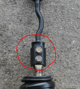

The shift is twice as long with the Tremec compared to the MGW. I think cutting the factory stick down would help but the kink in the factory shifter lever prevents much more than a 1" cut. Also, I think it's worth noting that the rubber isolator (circled below) on the factory shifter really helps reduce NVH and makes for a more street friendly driving experience.

Good to know! I was kind of hoping you'd say its the same throw haha. I do have some NVH that comes through mine without an isolator. I installed rubber shims between the shifter and lever last summer, and it greatly reduced the NVH, but I kept having problems with the bolts coming loose.
