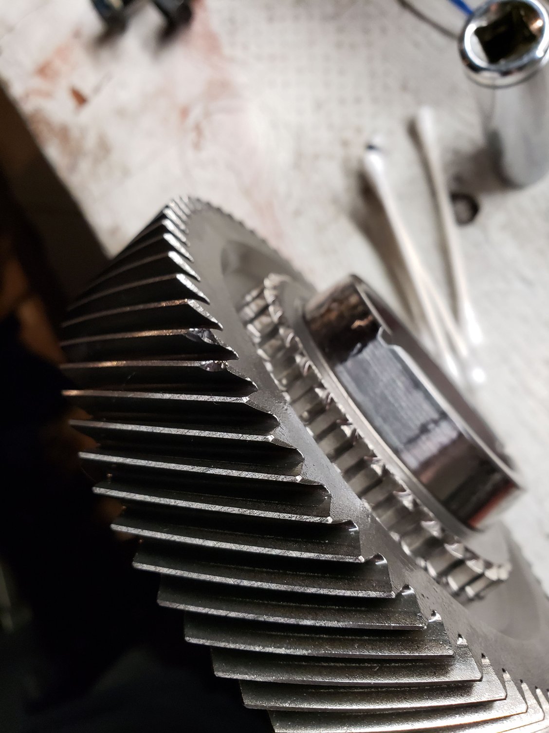

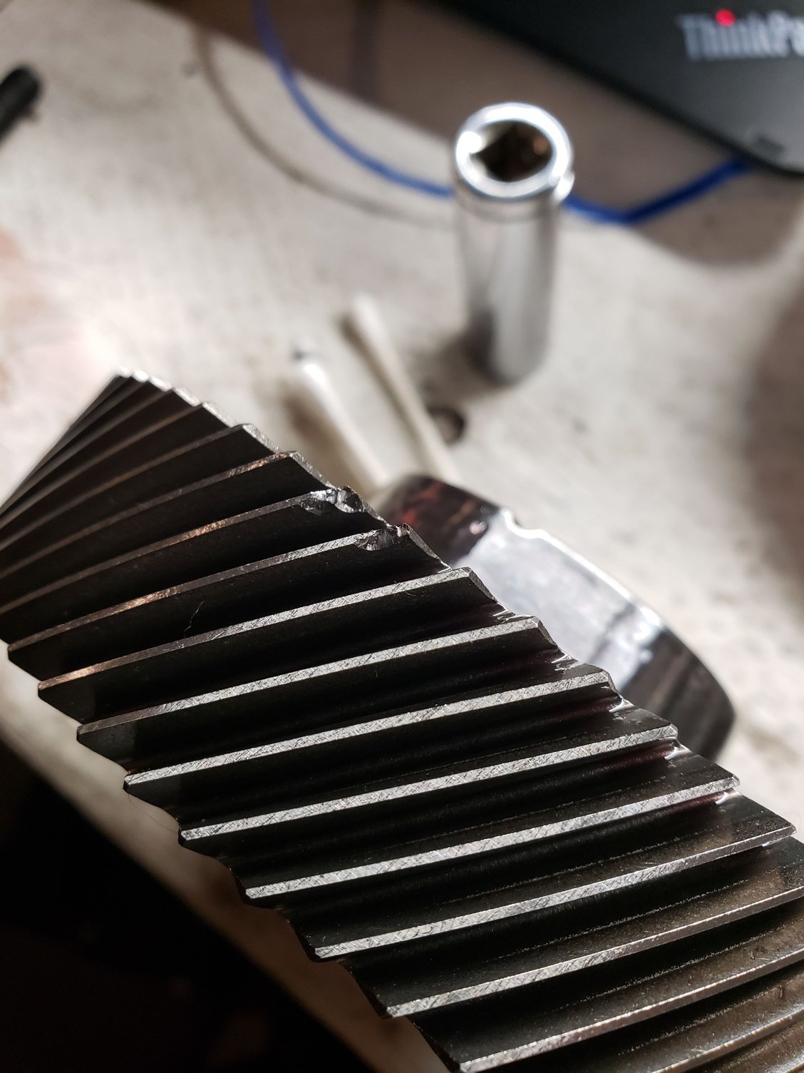

So I discovered a couple chips on my 6th gear on the countershaft extension. Thoughts?

Would probably run fine forever, no one jams a trans into 6 anyway. That being said, if its already apart...

I'm asking cause I've got a high pitched whine in 5/6 (already replaced the mainshaft and cluster) and the trans is bucking when coasting in 5 or 6. Wasnt sure if the chips here could cause that.

Transmissions don't buck. As for the whine, it's possible.

That damage, is maybe from a previous trauma the trans has seen ? Some residual damage not repaired at that time.
But it's 6th...never worry about it. Any "bucking" issues are more likely tune.

Bucking is probably an incorrect term to use. What is happening is that in 5th or 6th (and only in these gears) when I am coasting I'm getting a loud... "thumping" noise, for lack of a better term, that I can feel and hear through the shifter. And the car jerks slightly, as if I was tapping on the brakes.
Only other mod I've done was an adjustable torque arm.

That gear should be smoothed out and reinstalled. Inspect the syncro engagement teeth, if they're good use it. That gear is in no way causing any problem that you've described.

A gear chipped like that could cause a thumping sound as it rotates but that's it. It could have been caused by poor handling at teardown/ rebuild of something / debris going through the mesh in operation. If from debris, there should be a witness marking ( or other chips ) on the driven gear. You could clean up(grind with a die grinder) around the chips to relieve any high spots of the tooth. This should reduce the thumping/noise.

No it wont

Appreciate all of the input guys. Ended up getting a new 6th gear at a decent price. I figured it would be cheap insurance (and I'm never gonna beat on 6th anyway).
