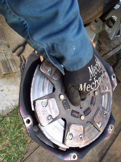

This just happen to me about two weeks ago. It's going to be your clutch. The spring came out of my clutch disc and it would not disengage. Was the clutch makeing any noies before it happen?? I have the same clutch,spec stage 3.
I thought that would be the case...Yeah the clutch was making noises... I have about 25,000 miles on the clutch with it being in three different cars getting beat on all the time...first one was a camed/ sprayed SS, then a heads/cam Z28, then my procharged Formula. Its taken a beating.
