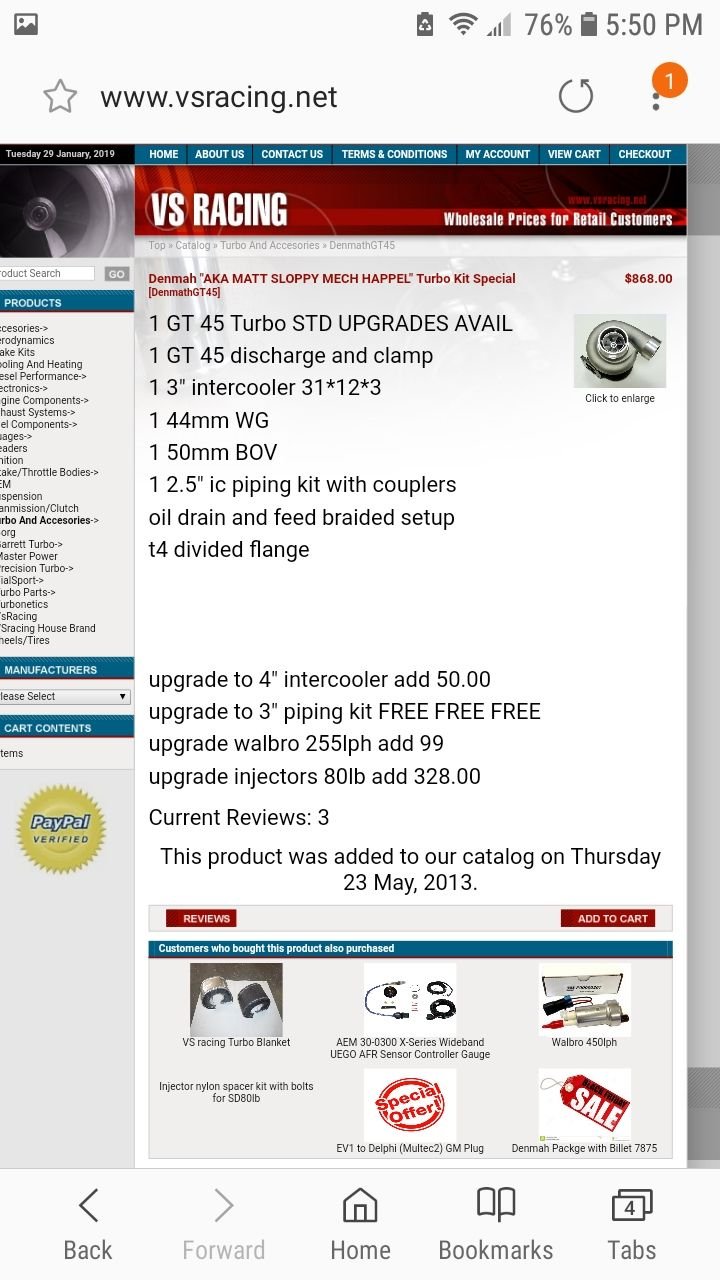

Old Jan 29, 2019 | 04:48 PM
Budget Build's Avatar
Joined: Jan 2019
Posts: 18
Found this 🤯🤯🤯

Old Feb 4, 2019 | 11:43 AM
JoeNova's Avatar
Restricted User
Joined: Mar 2014
Posts: 7,192
Likes: 109
From: Ohio
You can piece on together for cheaper than that. That GT45 turbo is only $180, and its not the greatest turbo. It will make 550-600 at the wheels on a 5.3 though.
