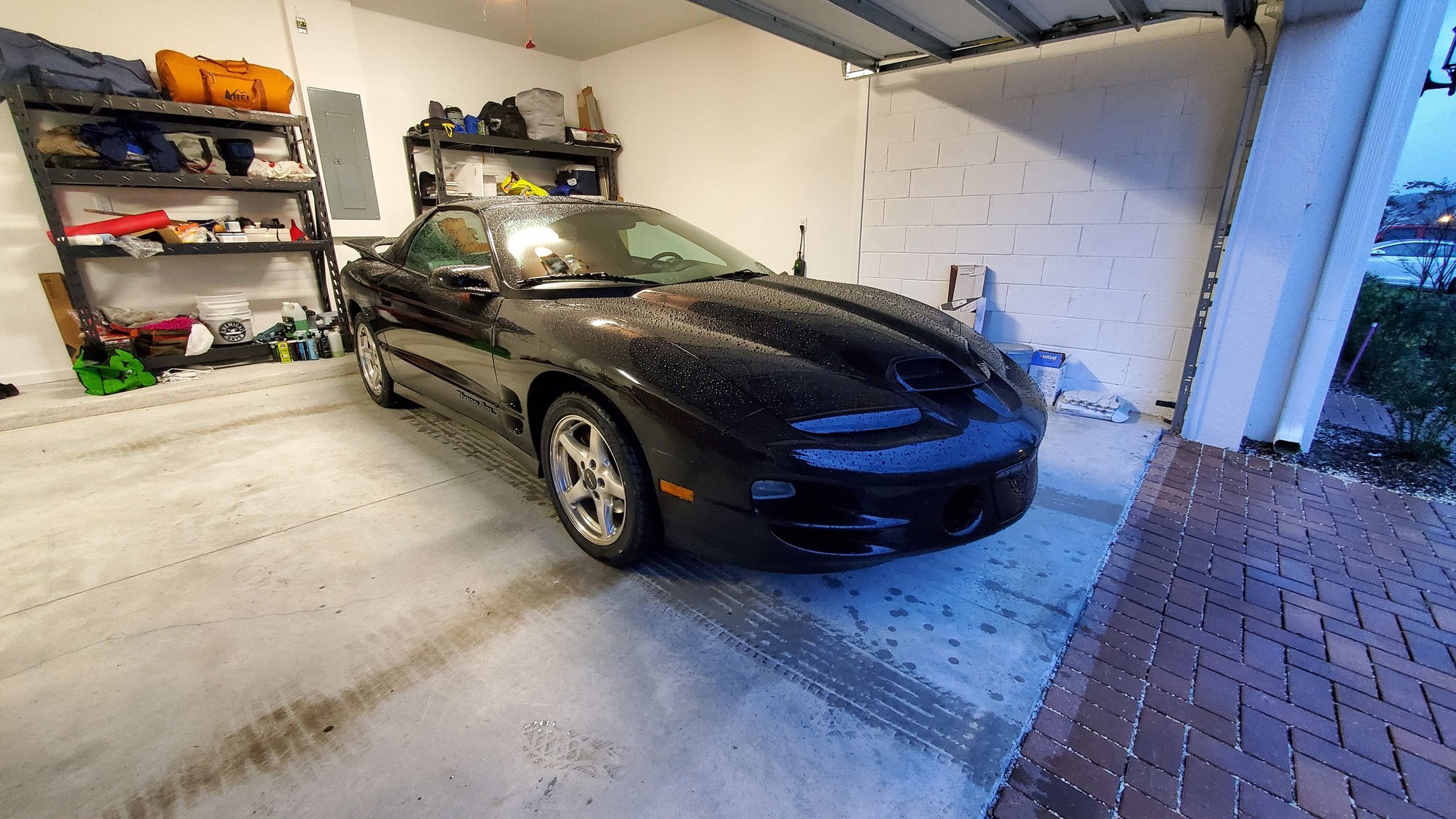

Hey all,
I am somewhat of lurker in these parts but recently purchased a 2001 Trans Am WS6 A4 from Sherman Texas, I actually drove it back home to Florida (just arrived this morning at 7am, long drive!) While she handled well, I did notice she ran a little rough (mileage is 29k), I have some very good recent service records from the previous owner (I put them in excel format and will copy paste them below). Question for you all? What are some of the things I should be looking out for and swap to make this a more smooth running car? It has door panel cracks which I expected and was disclosed prior to the sale (I had a mechanic I hired to check it out before I bought it). He gave it very good reviews both mechanically and cosmetically but did note it ran a little rough. The drivers side headlight seems like it gets stuck against the hood and won't come up, when I open the hood then turn on the lights it will opens and the lights work, I can then close the hood (when I turn off the lights they go down without issue or rubbing on anything).
I will post some better photos later, it's still raining out here. I've attached the maintenance records via excel.

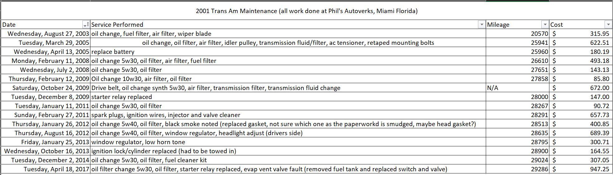

Apologies, I may have gotten the color code wrong, but it's black, ha.
I took a screenshot of the excel file I made for the maintenance, this will probably help others out if they can't open the excel.

Not much point in replacing the plugs and wires based on what's listed on the spreadsheet (thanks for attaching the image above). Looks like that was done about 1k miles ago (I realize that was a decade ago, but these items don't go bad from age alone). I see that injector cleaner was used at that time as well - wonder if the rough running was a problem starting back then, and the previous owner tried some of the same methods to fix it? Looks like another injector cleaning was done 800 miles later, again, probably for the same reason.
It's curious that the starter relay was replaced twice in the last 1200 miles (though ~8 years apart). Wonder if the issue was actually related to something else? It also seems that the bulk of the mileage was done in the first couple of years, after which it mostly sat. And apparently someone tried to adjust the problematic driver's side headlight before (sounds like they were unsuccessful).
There is no "normal" reason why a head gasket would ever need to be replaced on a 28k mile LS1 engine, so if that is in fact what was done (I know this is uncertain based on the spreadsheet comment) then it's concerning to think about what sort of event would have occurred to lead to this outcome. Perhaps some residual consequence of this event is the culprit for the current rough running condition. But, no point in going too far down that rabbit hole if the paperwork is unclear.
Overall, I think more in depth diagnostics needs to be done regarding the rough running. The questions I presented above are a good place to start, but a comprehensive scanner would also help (to watch fuel trims, O2 data, misfires, etc.). Since a plug & wire swap plus multiple injector cleanings have already been done within the last ~1k miles, I wouldn't toss more parts at it without doing some further evaluation and diagnostics first.
