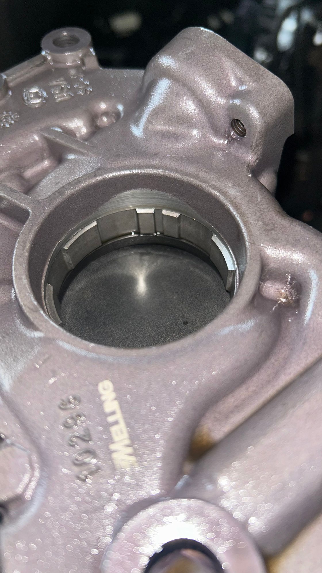

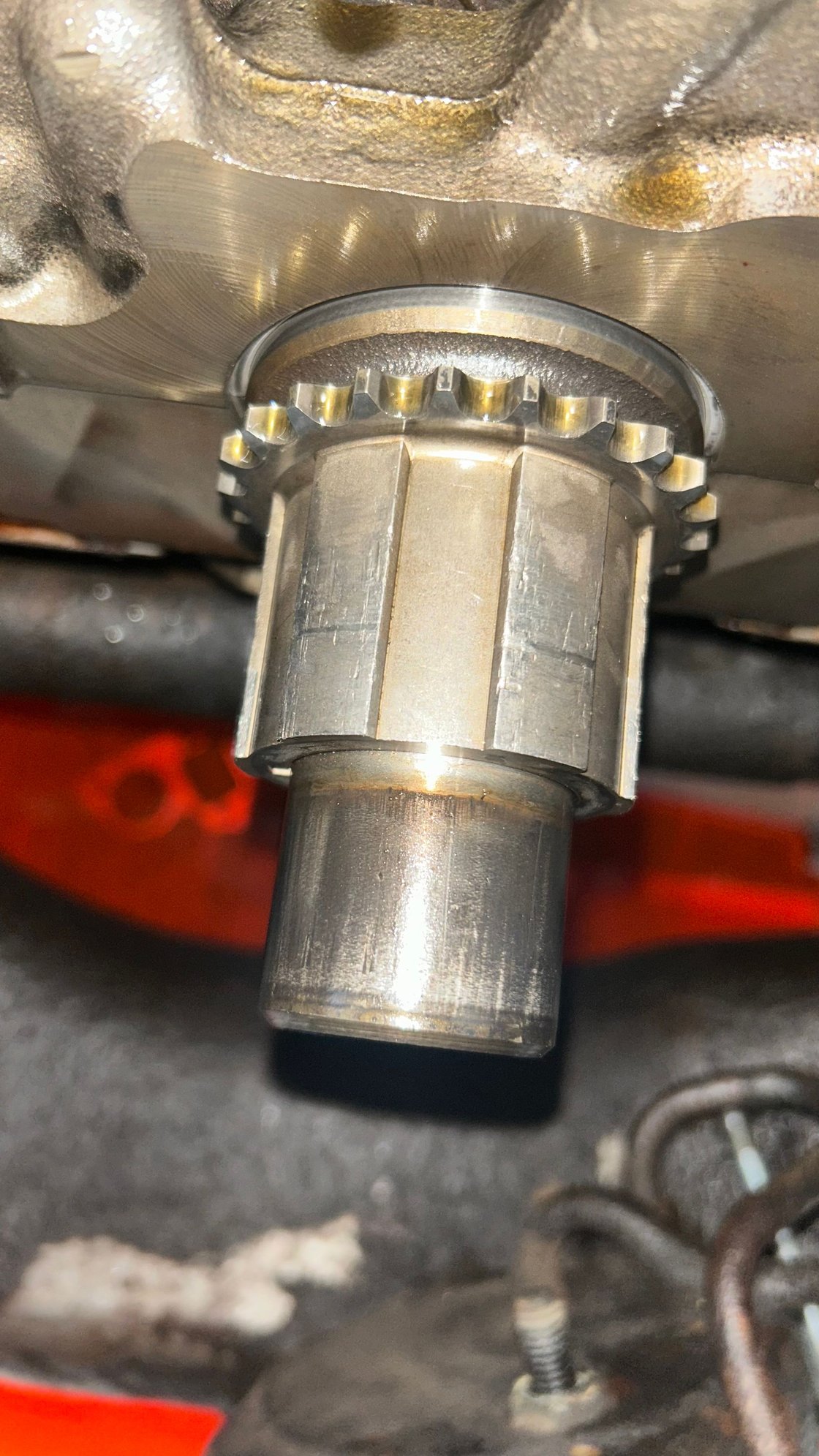

Default Figured Out the issue
To anyone that is/was wondering what the issue was. My oil pump bolts backed themselves out, and was causing the oil pump to back off the block. Not sure how the did, has I did torque them correctly. I’ve attached some photos to show the damage.
I’m thankful that it wasn’t a bearing issue, like what I had originally thought.

What was the damage? Sprocket doesn't looked wrecked, the Pump might be.
Old Dec 29, 2024 | 05:12 PM
doriansm442's Avatar
Joined: Nov 2024
Posts: 9
Pump is is cracked, can’t pick it up on the picture. And the sprocket is worn down with lots of scratches and dents. It is also allowing the oil pump to slip a little bit in some spots. Just taking some precaution and I’m just going to replace most of it.
