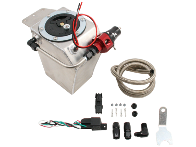

http://www.nitrousexpress.com/15004-...-methanol.html
Here is the one we sell. It uses an Aeromotive regulator that comes with a low and high pressure spring, it returns right out of the tank. If you have us make a note we can configure it specifically for an F-body to fit in the battery tray. It will handle e85, race fuel, or pump gas. Let me know if you have anymore questions!

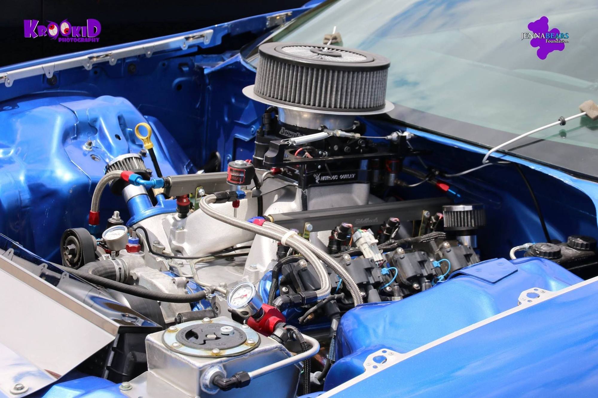

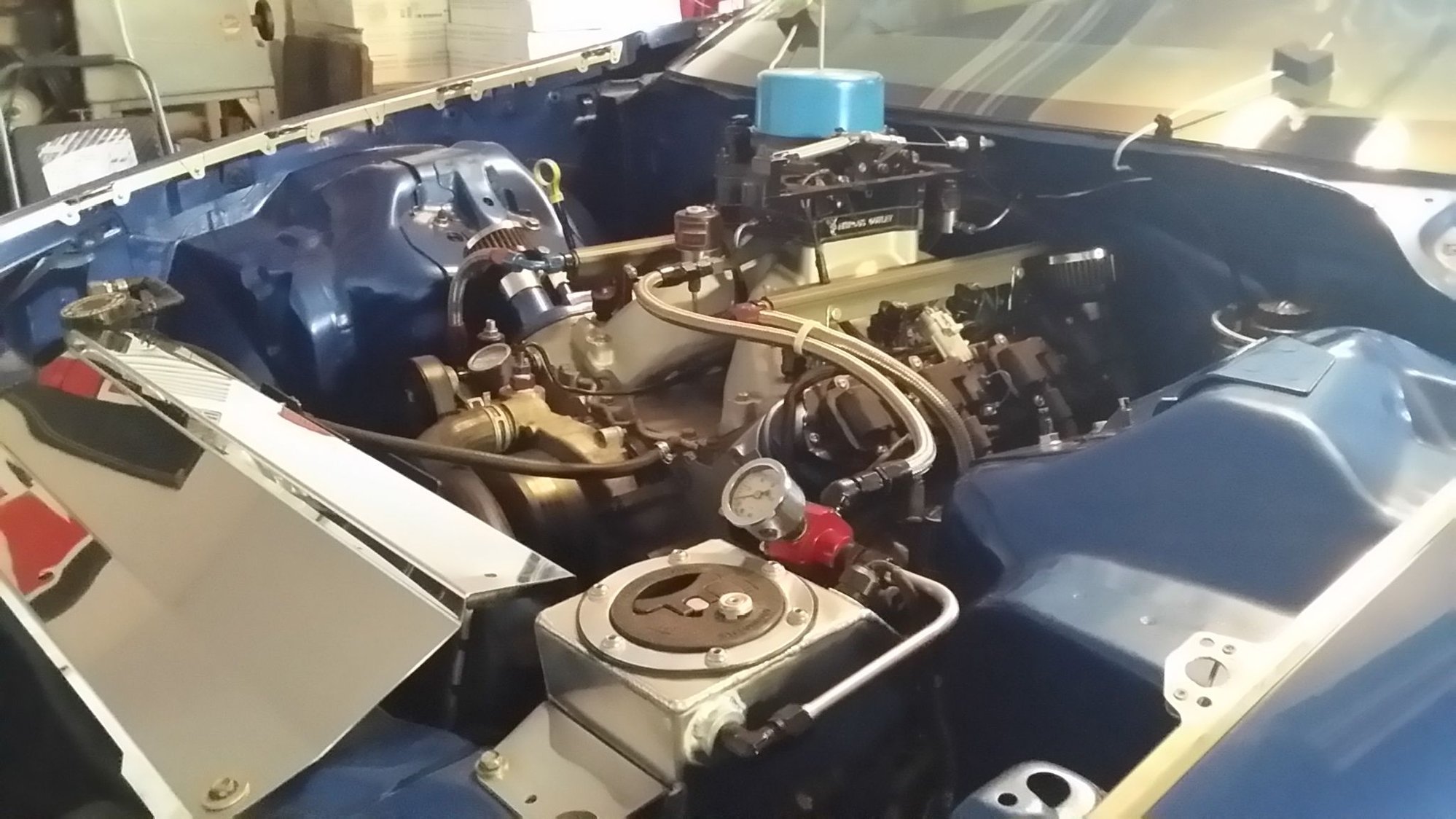

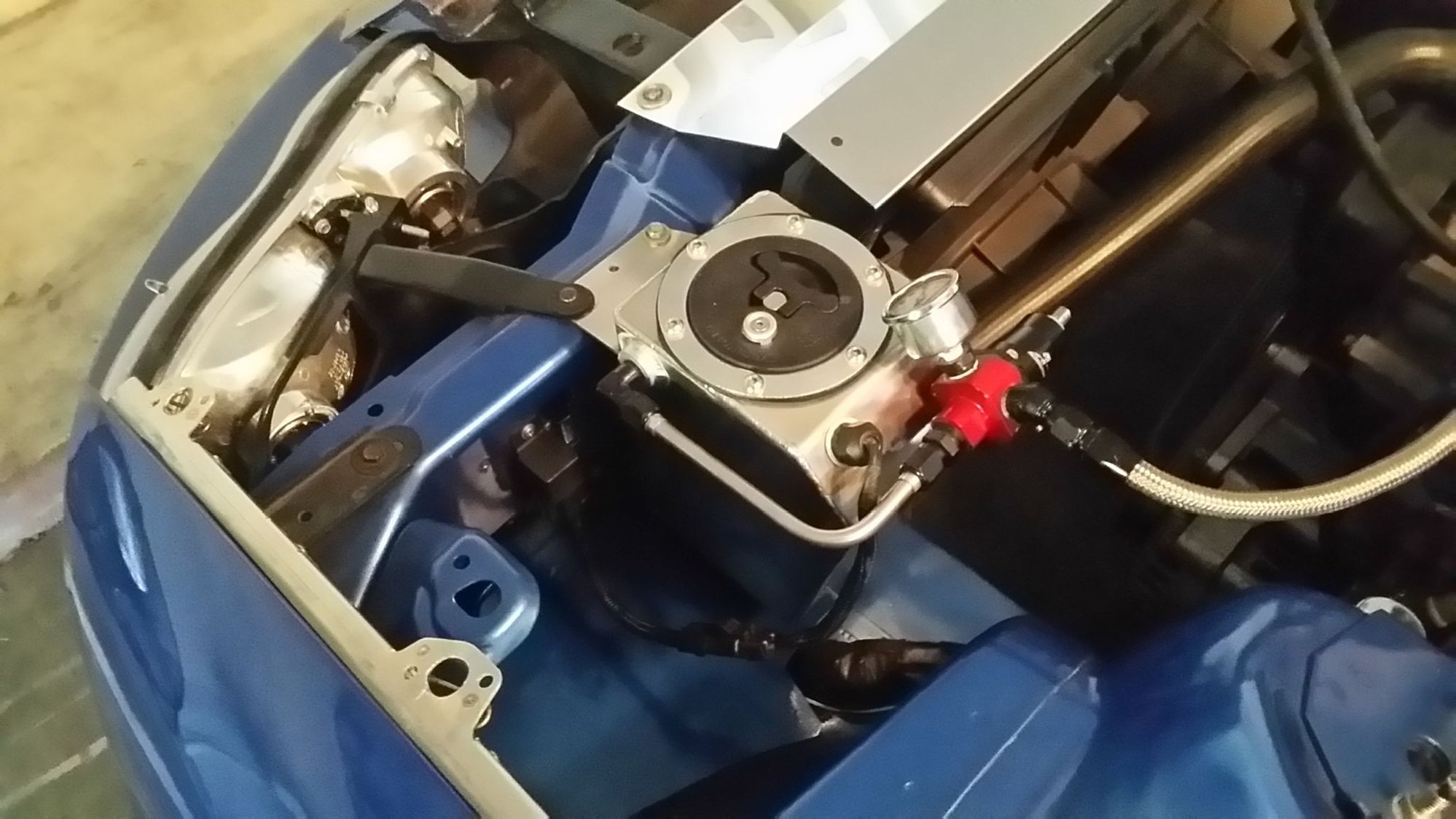

Here is a stand alone fuel cell made specifically for the 4th gen camaro. No need to move your battery. We have it available in plastic or metal. Check out the links below.

I know I'm bringing up an old thread but can we get pictures of this mounted in a car?

No problem! Check out this thread showing it installed:
https://ls1tech.com/forums/nitrous-o...lled-pics.html

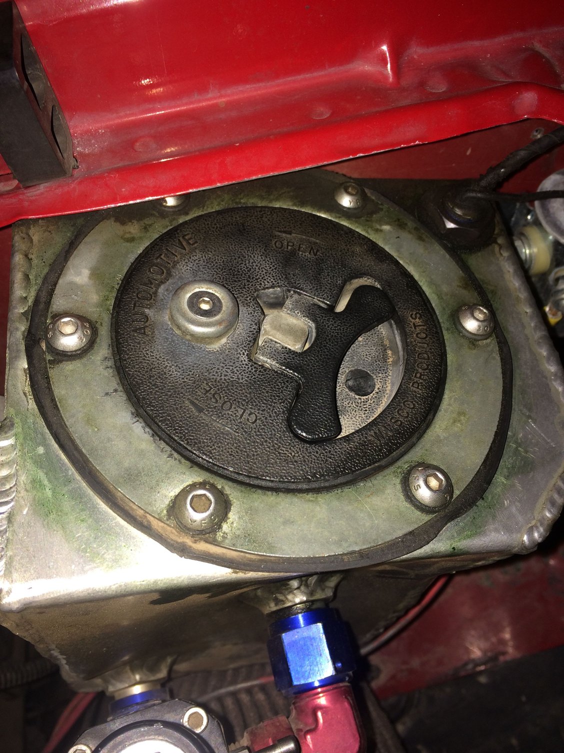

I have aluminum version. The aluminum looks better when new, but the seal around the lit seeps fuel out. It eats away the paint below the tank and discolors the hold down ring and screws. The plastic has a screw on top that probably won't seep and costs less. If I had to do again I might consider plastic, but do really like the look of the aluminum when new.

Call me and I'll get a gasket sent to you.

Thanks, to Brandon and Nitrous Outlet's great customer service mines back to looking new again.
