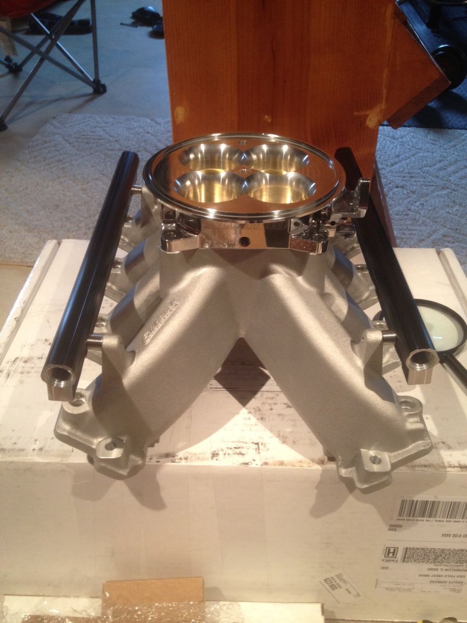

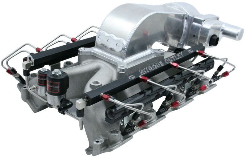

The only reason why i'm going with the elbow is because I have a ls2. I have a electric Throttle Body. I would love to run the carb style but i think its to much work to change it over.
I like this setup but electric TB

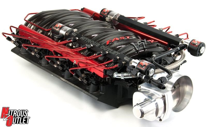

See i have the fast 102 with nitrous outlet direct port 2 nitrous, 2 fuel jet with purge hard lines never been used yet. I just have the fear of the intake blowing up and there goes over 3k in nitrous and intake. What i was wounding if i took all the parts off my intake because nothing been used and have u guy install it on super victor intake what would it cost?
I know u cant re-use the hard lines and fittings no more
