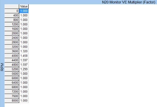

For smaller shots, you are ok on the rail. 150 is a smaller shot. If you put a rail safety pressure switch on, then its going to shut down when fuel pressure drops. NOS makes one that is adjustable from 50 to 70psi. I'm sure NO and NXExpress also have similar. As stated, with a fuel pump upgrade, Racetronix, you should be good to go. I use a remote, but I did it at the time because I had a stock fuel pump. Remember, the FP switch is going to shut down the nitrous if pressure drops. Thats a good safety net.
I have setup a basic stock vette file for EFI Live and COS5. I can give you a link to download COS5 for a C5Z, maybe minor changes for the C5. The tuner would simply flash the file. IMO, EFI Live is just another part I bought for my car, that helps me tweak all the others ones I have. I say, forget the remote tank, and buy the EFI Live tuning setup and do it yourself. There is no magic to it.
I have a 15lb bottle in that same compartment and it fits fine.
I would go 15lb bottle. I used to run a 150 shot on a 10 lb bottle years ago and I must have got at least 5+ runs off that thing.
BTW, here is what you tune in COS5 for nitrous:
