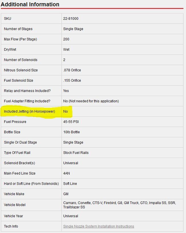

what does mean Included Jetting (in Horsepower) no ?

Mine included jets.

Are you asking what do those different jets mean in terms of horsepower? I'm not really understanding your question

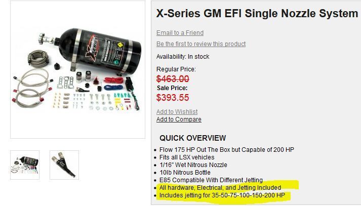

is there anyone using the x-series nitrous system ?

I was using that exact nozzle setup at 150 last year. It worked well. Mine came with jets.

We do include the jets with the system.
