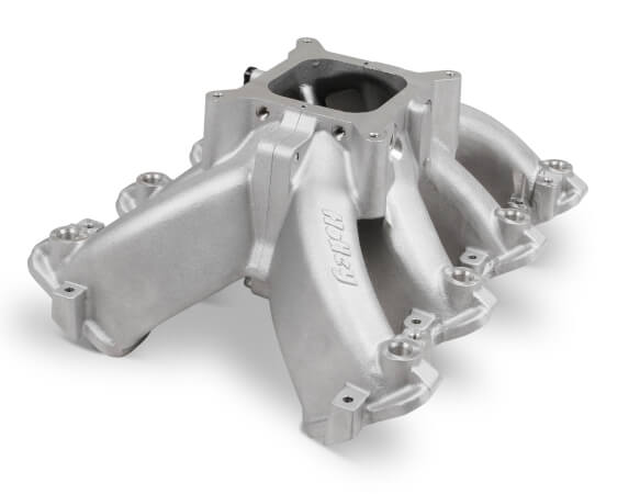

Another option to throw into the intake hat you could go with would be this one....
https://www.holley.com/products/ls_p.../parts/300-255
Curious about that one vs the CID, I think the Holley falls between the Super Vic and CID in height plus Holley comes with fuel rails and bolts right on for a good bit cheaper. Having to pay more for a CID and then send it to another company to make work doesn't sound like fun.
I'm right there with you. I'd be curious to see how it would stack up. If I didn't have a bunch of money in my Vic Jr [ welding and porting etc. ] I'd probably go with the Holley intake and bite the bullet to cut the cowl.
