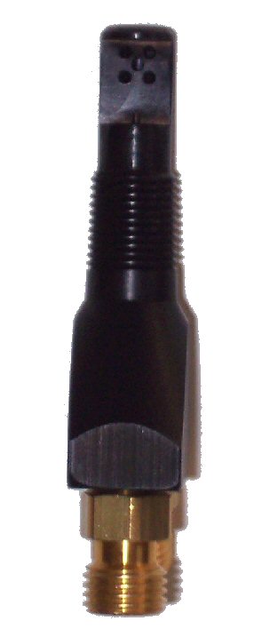

Let start by saying my post is not banging the product nor is there any sarcasm.
Ok been an intesesting thread thats for sure. lol
Now the whole flowing thing is correct a larger orifice will be less restrictive but your .125 orifice hole has a least 6 turns in it.(one at the end where the fitting screws in, and those 5 holes at the tip. And turns make for restrictions also.
Now my question the nozzle has 1 .125 orfice hole for nitrous, and 5 .054 discharge holes. That surface area is = to .1207. Now that large orifce in the nozzle has a restrictor down stream.
Now I am not saying the nozzle does not work. In fact I would be most interested in in being present on the dyno day, ( If possible (your ok needed)and IF I can get away, or have one of my guys there).
Strictly as an observation!!!
Ricky
Originally Posted by NitrousDirect
This Patent Pending 90 Degree Annular Nozzle Hands Down makes more power & earlier than any nozzle tested using identical jets.
1/8 Thread
(fits/replaces 1/8 nozzles stand alone)
90 Degree Style Nozzle
.125 nitrous Orifice
5x.054 nitrous outlets
.125 Fuel Orifice
w/ .125 Fuel Outlet
Reason why it makes more power
Breaks nitrous into 5 smaller streams so the fuel can penetrate and atomize more completely with the nitrous

Thanks for the answer. I have NO problem believeing that. The Multitude of questions and replies by some pitching the nozzle where saying the power increase was due to better atomization. Which I did not buy. I can definately see that if it flows more then more power will result. But again as we covered in the other thread the nozzle is but one piece of the puzzle. Many other things can affect HP including just changing jets. Thats why I dont get the hype of one nozzle being "better" than the next simply because it makes XXX amount of power with XXX jet sizes. As long as the entire combo will flow enough to make the HP you want...its a moot point IMO.
As I said before i would be interested in flow characteristics over a wide range especially towards max flow.
In other words...if you have a kit with decent noids that flow 250 a good -4 line and a nozzle that will spray up to 250 rwhp. It makes no difference what jets are in the nozzle when you achieve your desired HP level of say....150 rwhp.
I can see where a nozzle like yours may be benifical in race classes where they limit the jet size. that could be helpful.
Anyways...i think originally in this thread the hype got a bit sidetracked and misunderstood on what was being claimed.
Nice nozzle. Im sure your customers will enjoy them

Thanks for the clear up Albert. And I agree with Al, this nozzle would seem to work well in classes with certain limitations. But it is a piece of a much bigger puzzle. I'm still very interested in your guy's upcoming testing.
