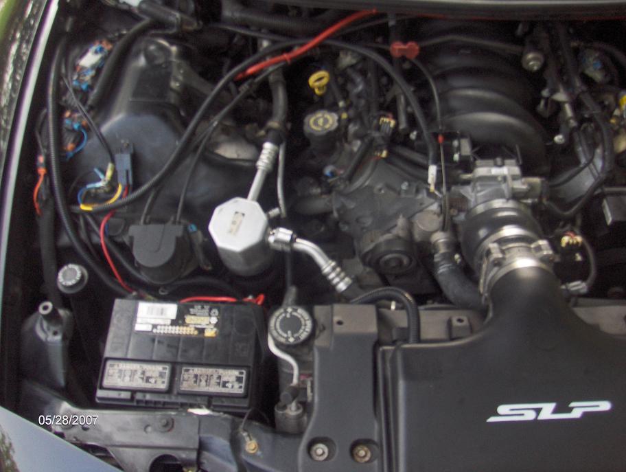

Old Jul 9, 2007 | 03:18 PM
WPBTA's Avatar
Joined: Jan 2007
Posts: 50
From: West palm beach
I have the same kit this is where i place the nozzle here are some pics
Old Jul 9, 2007 | 06:17 PM
its turbo time's Avatar
Joined: Jan 2007
Posts: 914
From: wentzville, MO
thanks for the pics^ i used the diagram that came with the kit from Harris. According to their diagram im right in the middle almost rich. But i don't know. I tried to get the picture up on here but i can't get it to work since its a .pdf
http://www.harrisspeedworks.com/inst...n%20Manual.pdf
not sure if that link will work but the diagram is on the 11th page
Old Jul 9, 2007 | 11:13 PM
BriancWS6's Avatar
iTrader: (18)
Joined: Mar 2004
Posts: 3,910
From: The Garage
Originally Posted by its turbo time
where is a better place?
Use a 90*, in the neck, about 3-4 inches from the MAF.
Old Jul 10, 2007 | 09:11 AM
Joined: Jan 2007
Posts: 914
I moved it last night, Its about 2.5 inches off of the opening of the lid. While the sensors are about another inch into the MAF, so total is 3.5 inches from the wire sensors(hope thats how i should have measured it). I searched pictures of nozzle locations and this was the most recommended location. I'll hopefully get a picture up in the next couple days.
Didn't get a chance to spray it yet, but as soon as i do i'll let you know how she does...might be going to the track tonight
thanks for the good info fellas
Old Jul 10, 2007 | 10:13 AM
ShiznityZ28's Avatar
Joined: May 2002
Posts: 2,554
From: GB MD
theres no exact measuement. get an af reading and if its lean move it closer to the maf. if its rich move it farther away. you can also adjust the angle to either hit the sensors more to richen it up or less to lean it out.

Old Jul 15, 2007 | 07:31 PM
Robert56's Avatar
Joined: Aug 2003
Posts: 9,557
From: Tacoma, WA
Correct amundo, and dual nozzles are better than single. Why, cause at this distance you will likely start out rich, you then rotate one nozzle to miss, or partialy miss the wire with the spray and thus adjusting a/f. Also, duals or singles should go in the neck. You can also turn one of your 90* nozzles back into the air stream. On mine, i have one 90* and one straight shooter (goes back into the air box, and a/f is 11.5:1 across the board and no lean spike what so ever. Now when my 2nd stage kicks in, two more staright shooters into the center of CAI, allows the a/f to go richer. This can also be fine tuned by changing out the size of the jets in the 1st stage nozzles, meaning a bigger jet in the 90* nozzle starts a richer mix compared to the 11.5:1 I have currently. You can see my dual nozzles and quad nozzles in my web sites in sig. it's A Z06, but neck is realative to MAF, so same as the F-bods.
