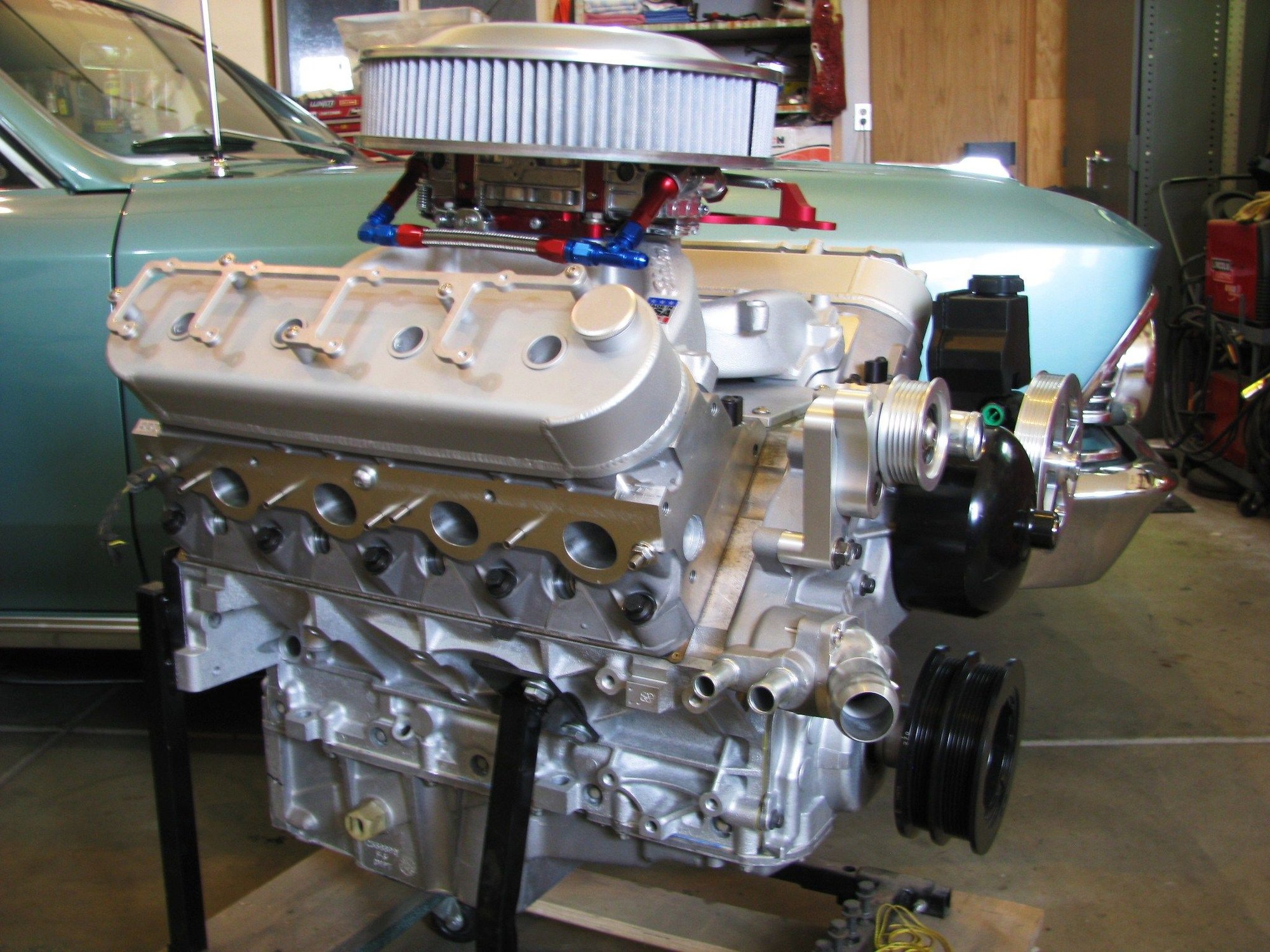

I'm doing a carb'd L-33 with Texas Speed heads and bunch of goodies to go into my 66 Malibu.
This is the engine:
That pan will be swapped out before install.
My end goal is to build a single turbo LS engine for it.
I have an LQ4 short block, 317 heads, and a Victor Jr. carb only intake.
I'm near Spokane FWIW.
Thank you Sir,
Stu
