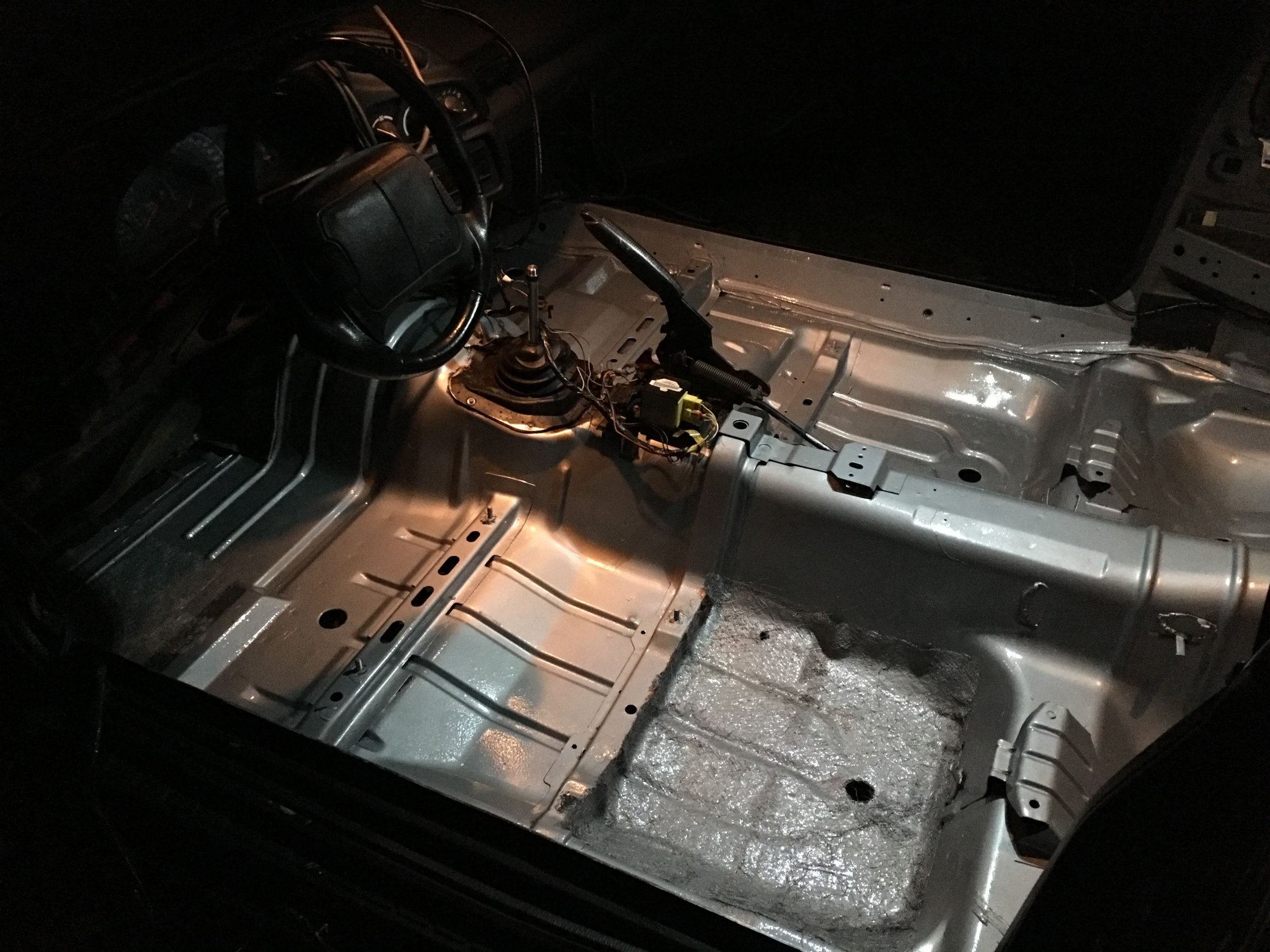

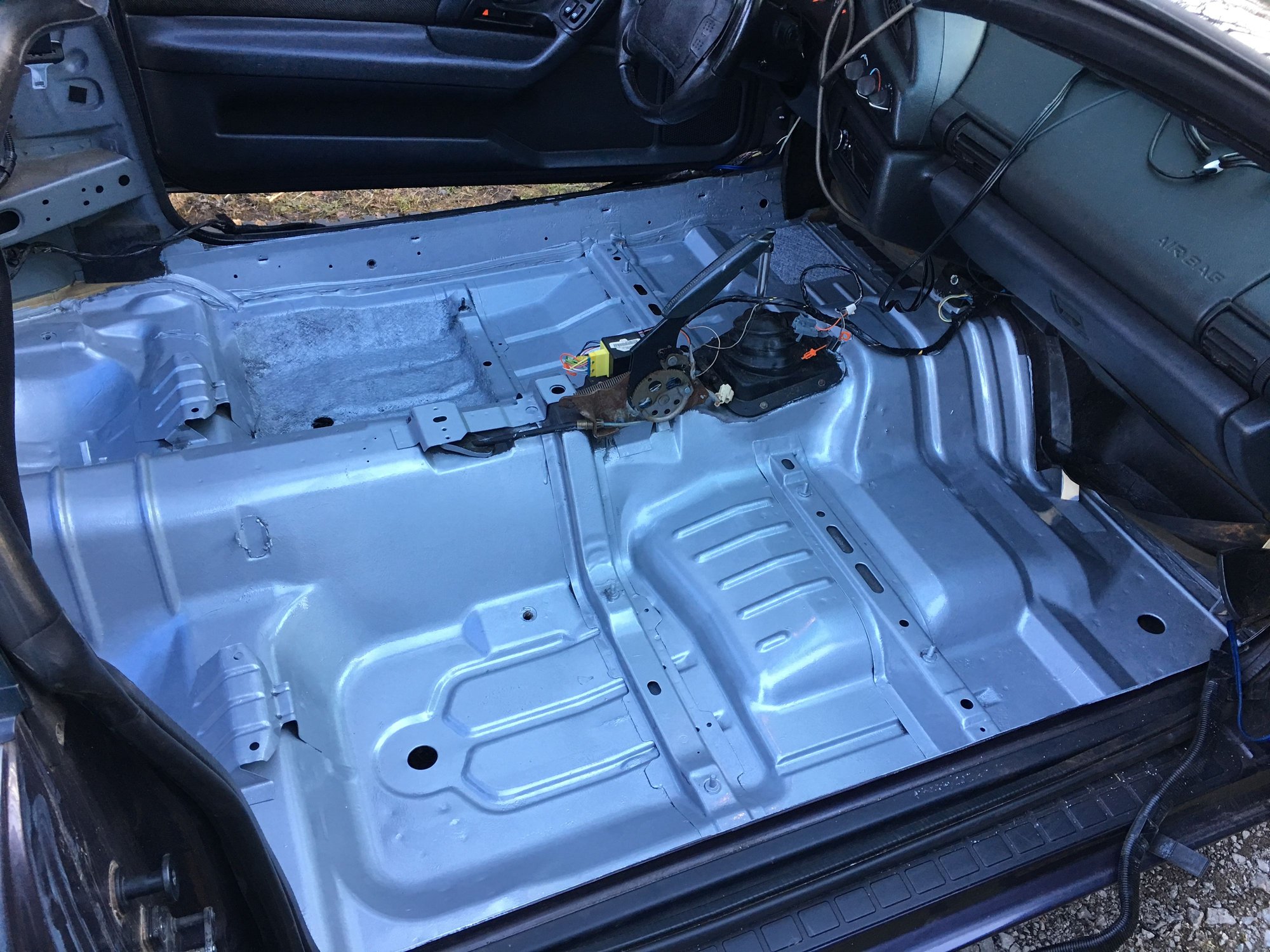

Fiberglass cured the next day. DS shot of the whole floorpan.
PS shot of the floorpan.
Sanded and wire-wheeled under the pedals on the driver's side. There were a few more small holes here.
Same procedure on the passenger's front foot well. This side wasn't as bad as the driver's.
Rust attended to and ready for the Rust Bullet prep.
Passenger front footwell after being treated with the Rust Bullet metal prep that came in the undercarriage kit.
Same treatment on driver's side. I let everything soak for 20 minutes before wiping it dry.
PS shot of the first coat of Rust Bullet. RB was applied with a 4" roller. I was very happy I chose to roll it.
DS shot of the first coat of Rust Bullet. You will notice that I also rolled over the POR-15 and Power Mesh with the RB.
Fiberglass cloth applied to WET 1st coat of Rust Bullet. Soaked with more Rust Bullet on the top.
PS shot right after the second coat. I waited about 2 hours before applying the second coat. The instructions say that after the 2 hours passes and there is no transfer, you're ready to lay the second coat.
DS shot right after second coat.
DS shot the next morning. About 12 hours of curing.
PS shot at same point.

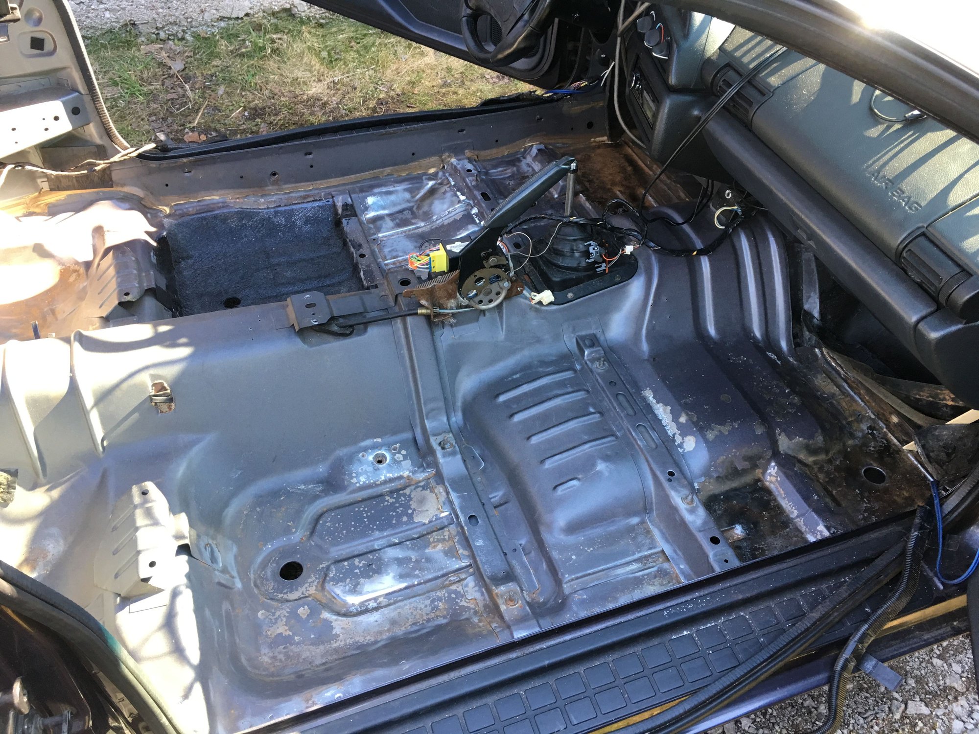

That really came out cool. I used POR-15 on the underside and inside of mine. I also ended up welding a floorpan in as the old was pretty rusty. I like the color the rust bullet came out compared to mine. Pics are mine before repair.
Thank you so much for the compliment! I'm really pleased with how it turned out. I can understand why you ended up welding, that hole is pretty serious!
