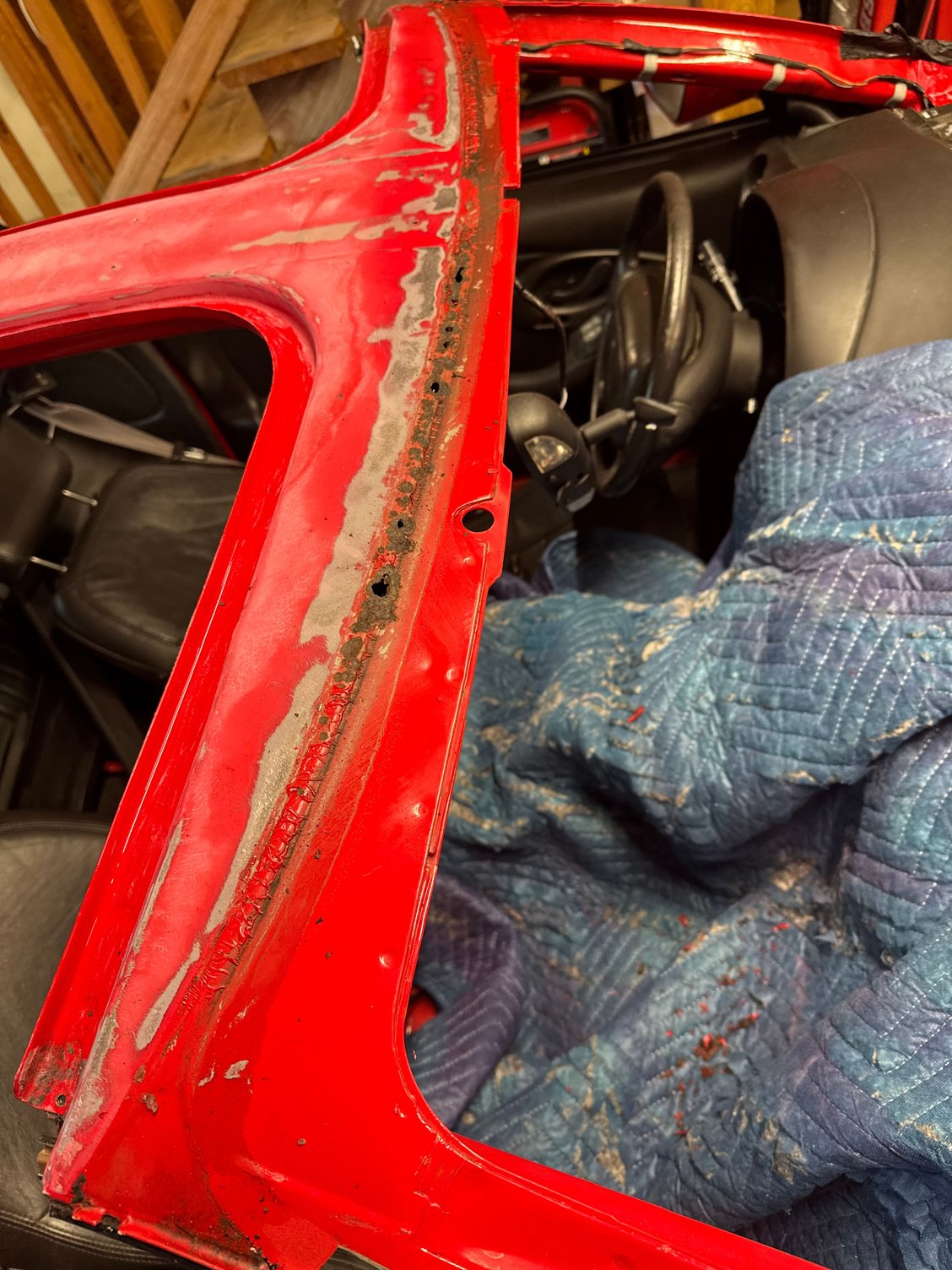

Hey. I was building my car and there was no rust anywhere. When they took my windshield out, they found rust all across the front where the windshield meets the roof. I halfway freaked out. I took it to a guy that had done some work on my Squarebody and he fixed it for $300. Zoom in on the pictures and you can see how good it turned out. He sliced out the rust and welded it a new piece and painted it up.

Pretty sure I have this problem with my 01 trans am after finding this. Mine keeps leaking right above the rear view mirror and water pools up in the ABS headliner that came on the car. Figured I’d try silicone on the hole in some sealant I seen near the T Top bar that meets windshield. Did no good. Wondering if I have a bigger problem like this. Seen some bubbling on the paint in the area but don’t see rust. Guessing I need to remove the moulding or even the whole windshield to see something.
Old May 2, 2026 | 10:52 AM
