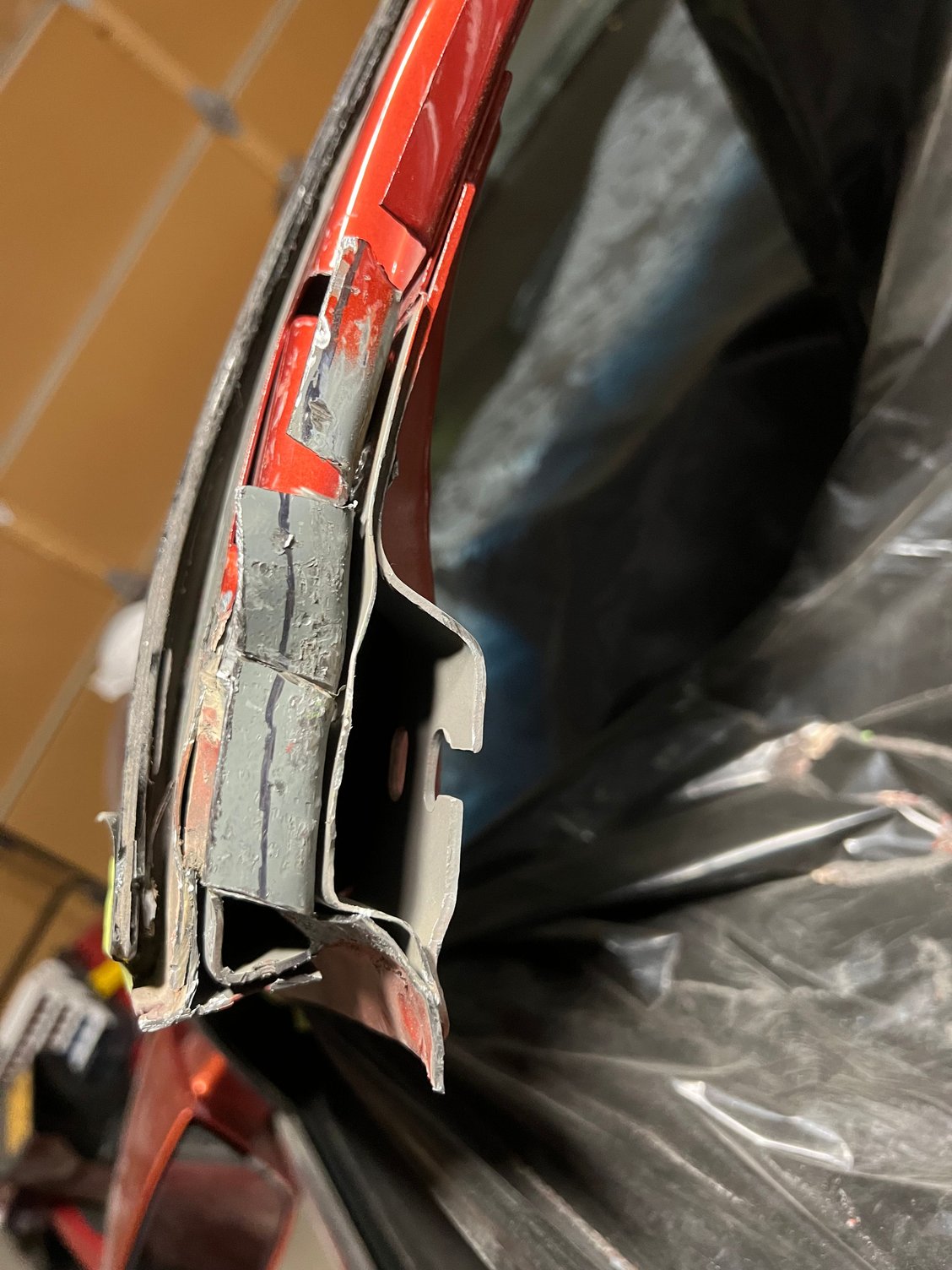

For those who have done this conversion, am I just notching slits in the side and bending the metal up to create a channel for the weather stripping for both the front and back here? I am also trying to determine how far back I need to cut and what exactly I need to drill out with the weld cutter bit?

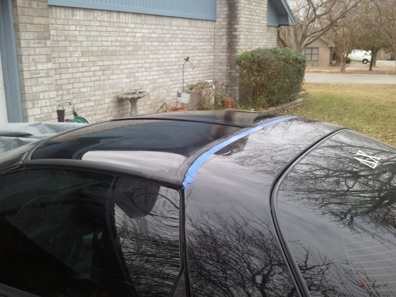

No worries, I have done this conversion on one of my old cars and helped a few friends with theirs. I'm about to do it on my 93 Formula this winter as well. I'll help as much as I can.
1.) I never really did too much EXACT measuring, I just made sure to leave more material than I needed so I could bend the metal up and form the rest of the lip for the weatherstripping to rest on:
2.) I only reused my sail panel on my 99, on my friends cars (and on my 93 that I'm about to do) I removed the whole roof skin and swapped on one from a donor 93-mid 98 car that was repainted. On my 99, I just tried to sand the line that I cut as straight as possible and then painted the edge black to match the roof. I never liked how it looked with the roof off, hence replacing it on the other cars.
3.) If you can, get a donor panel from a 93-mid 98 car. I see you're up north, it may be easier in the summer months when the glue is more malleable. Some wire saws make the job go relatively easy, you just have to take your time and get into a couple different yoga positions to avoid cutting the panel, haha! But as far as needing one for reference, you should be fine. Everything is adjustable, you'll see once you start getting it together.
4.) I always use the 3m black weather strip adhesive in the corners and never had an issue.
5.) Honestly, it's pretty easy to figure out once you get the roof off and start cutting. Use your weatherstrip as a guide when forming the channel ends, I usually go on and off with them multiple times before I'm happy and start the body work. When you're done, get the windshield replaced with the proper windshield rubber for T-Top cars. It makes a world of difference on the looks imo. On my 99 I tried to cut the black metal trim piece to approximate the look of the molding for T-Top cars and I wasn't happy with it.

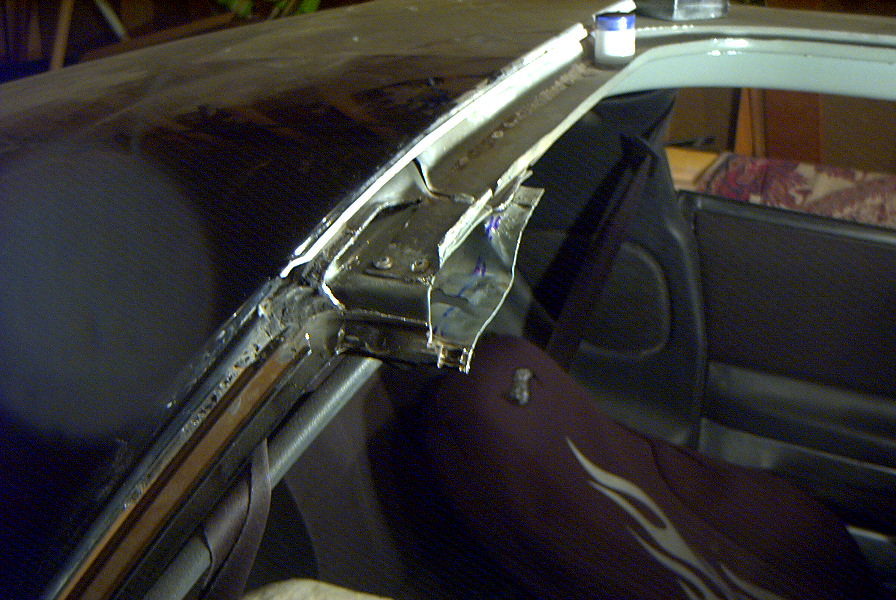

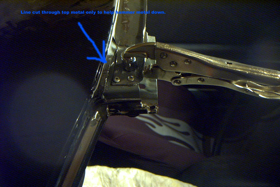

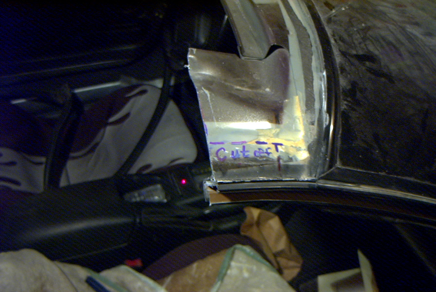

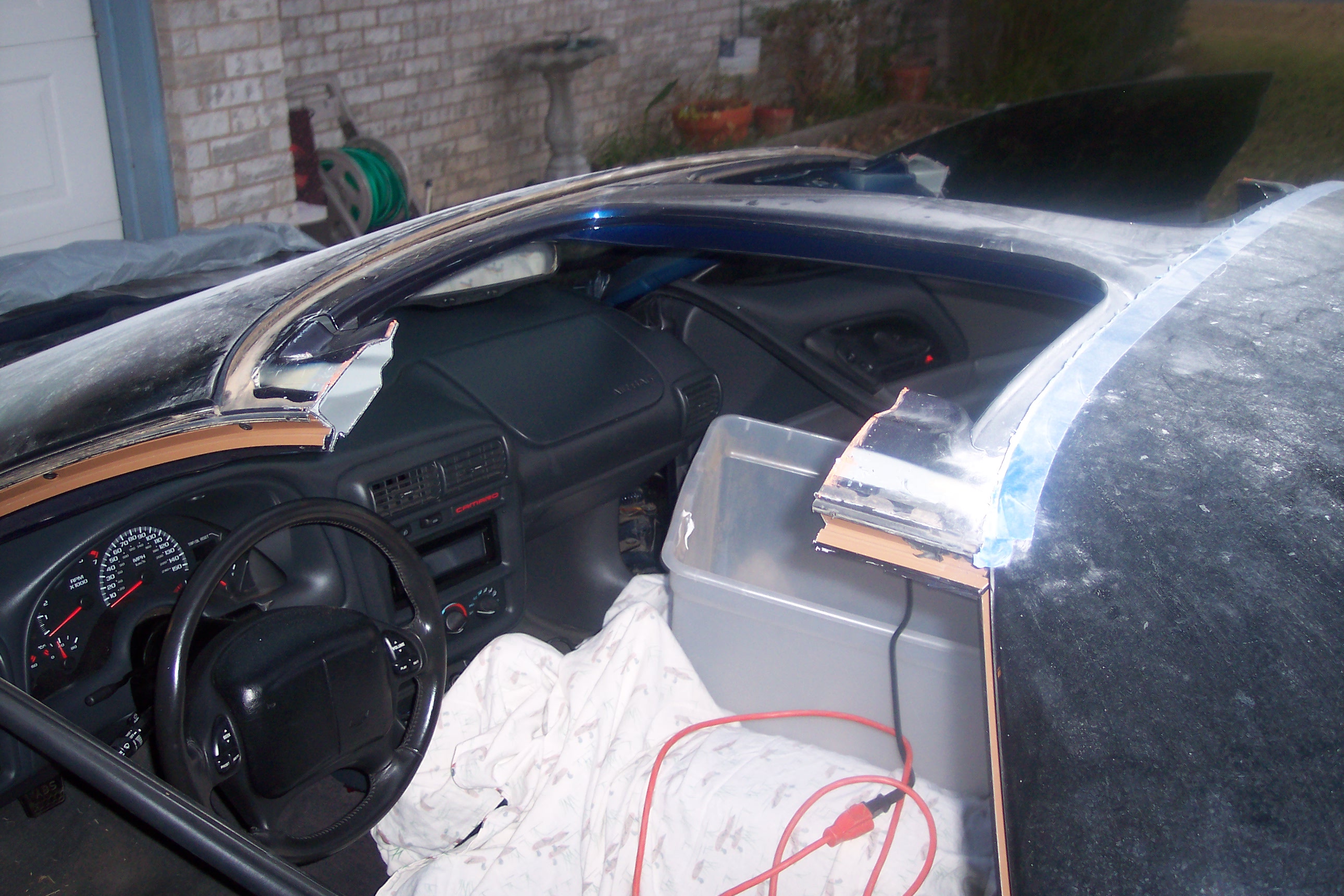

This is how I shaped my corners:
Take your time and do a lot of test fitting with your weatherstip and T-Tops, you'll notice when it all starts to fit and feel nice.

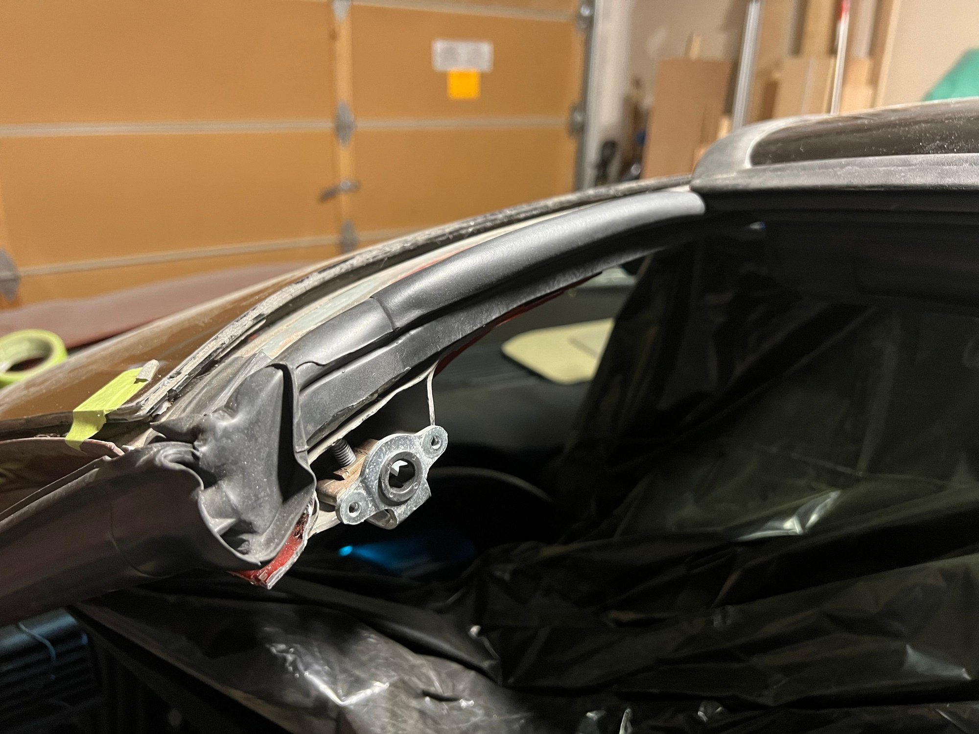

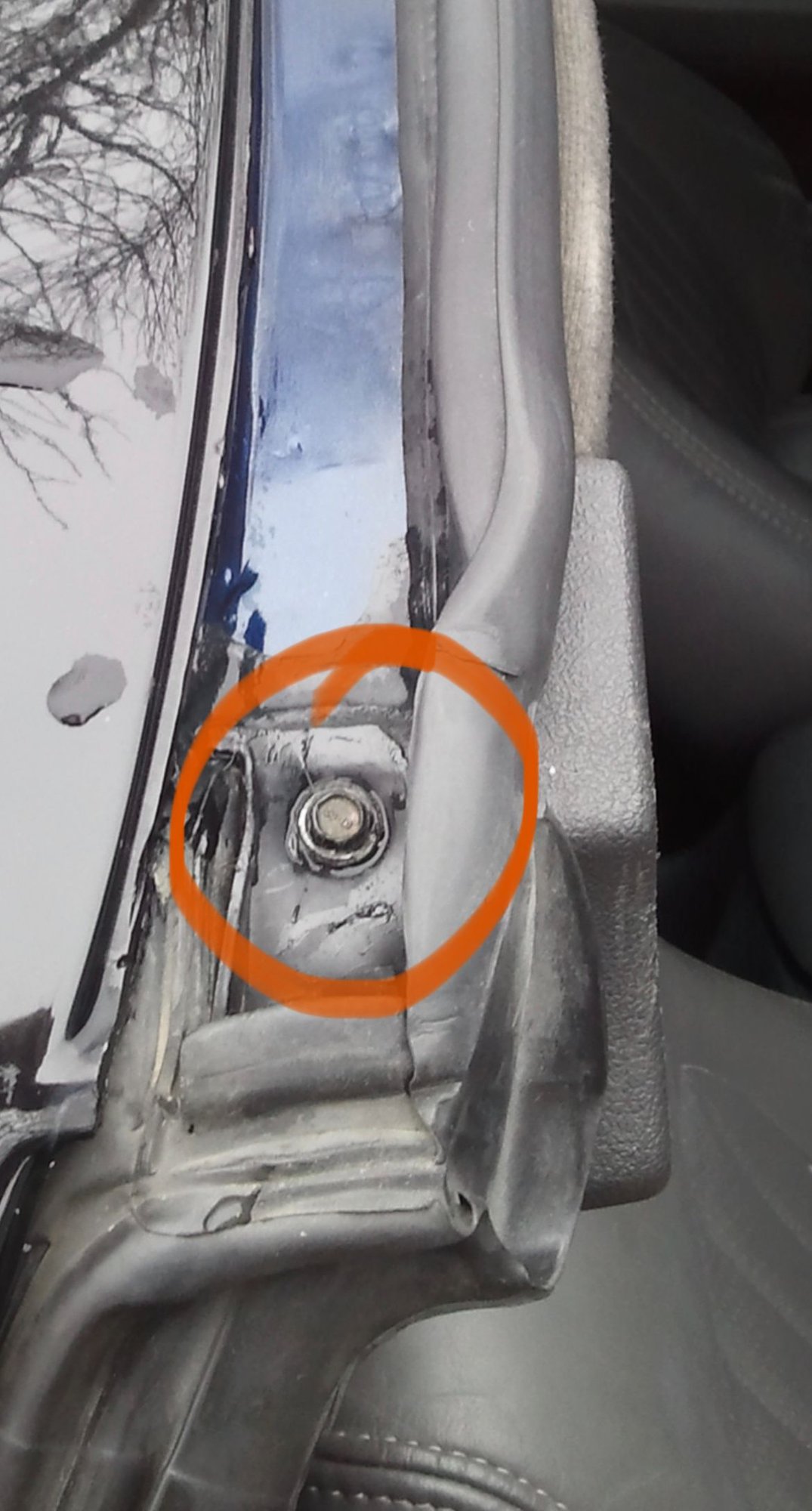

Also, what is this screw screwed into? I don’t see any holes in mine for a bolt?

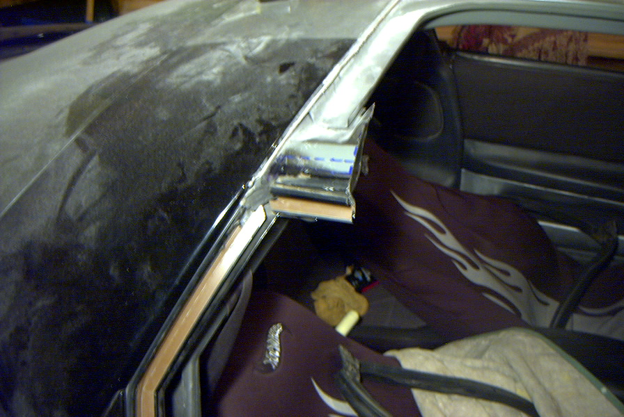

Thanks those pictures are way clearer than what’s out there.
what area are you using the spot weld cutter on and when I see guides talking about patching all the holes in the existing roof so water doesn’t leak, what holes are they referring to?

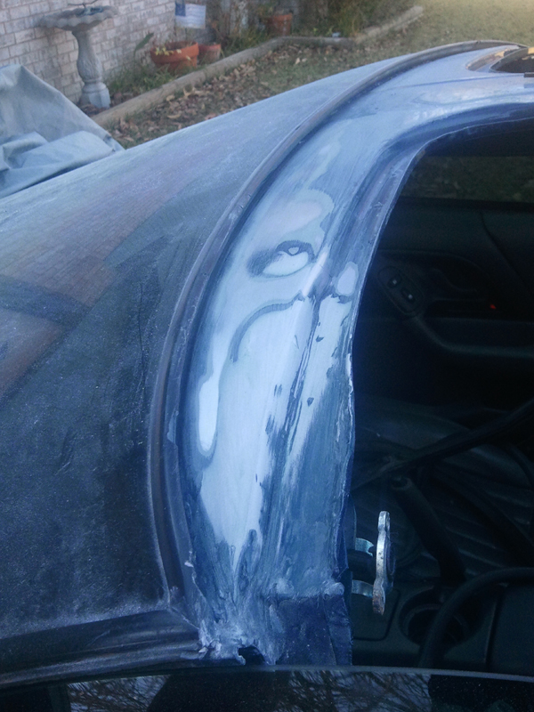

I didn't use a spot weld cutter, I would just take my cutoff wheel and make small cuts in the shape of a square around the spot welds and then pop the unneeded piece off. The holes they mention are all of the spots where the hardtop metal roof skin need to sealed, like so for up front:
Here is what my front corners looked like before primer and paint:
I used Bondo Metal Reinforced Filler.
They aren't there, you will have to add them. I lined the weatherstipping up and then drilled a small pilot hole. I kept the factory style bolts and they went right in and snugged up tight.

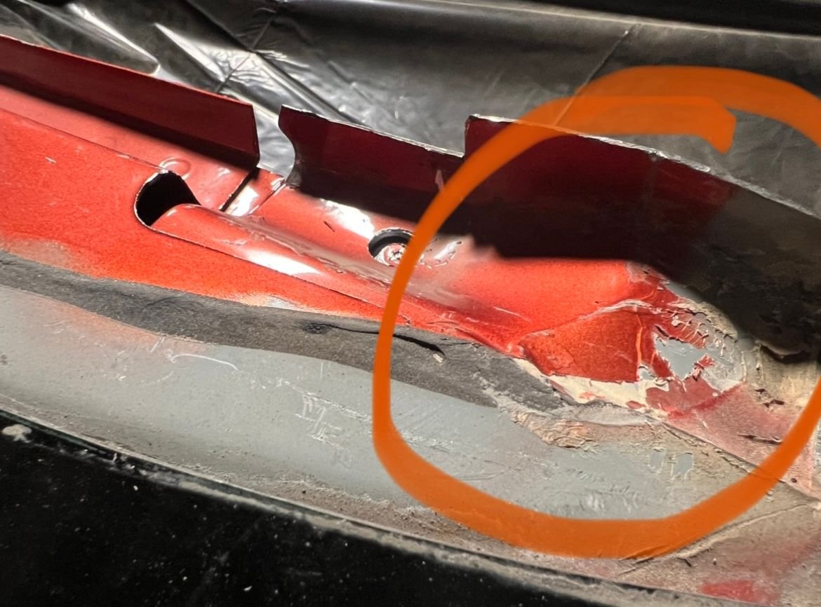

Do we have to remove this little corner hump in the front corners?

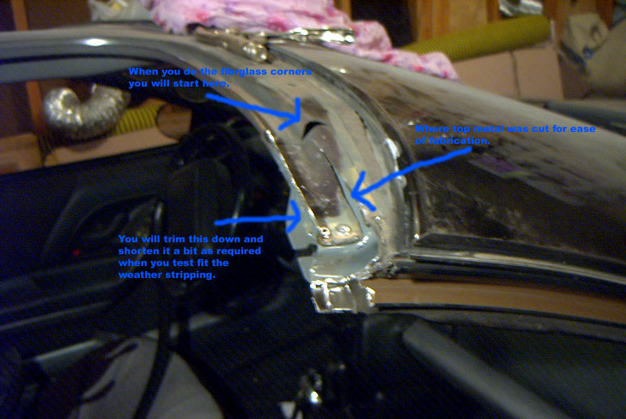

That is the front corner, correct? Yes, you will want to cut a slit and hammer it down. Here are some pics from Gripenfenlter's guide:
And here are the pictures from his guide for the rear:

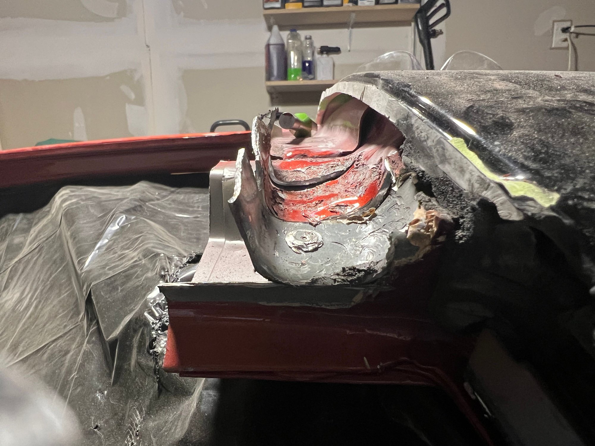

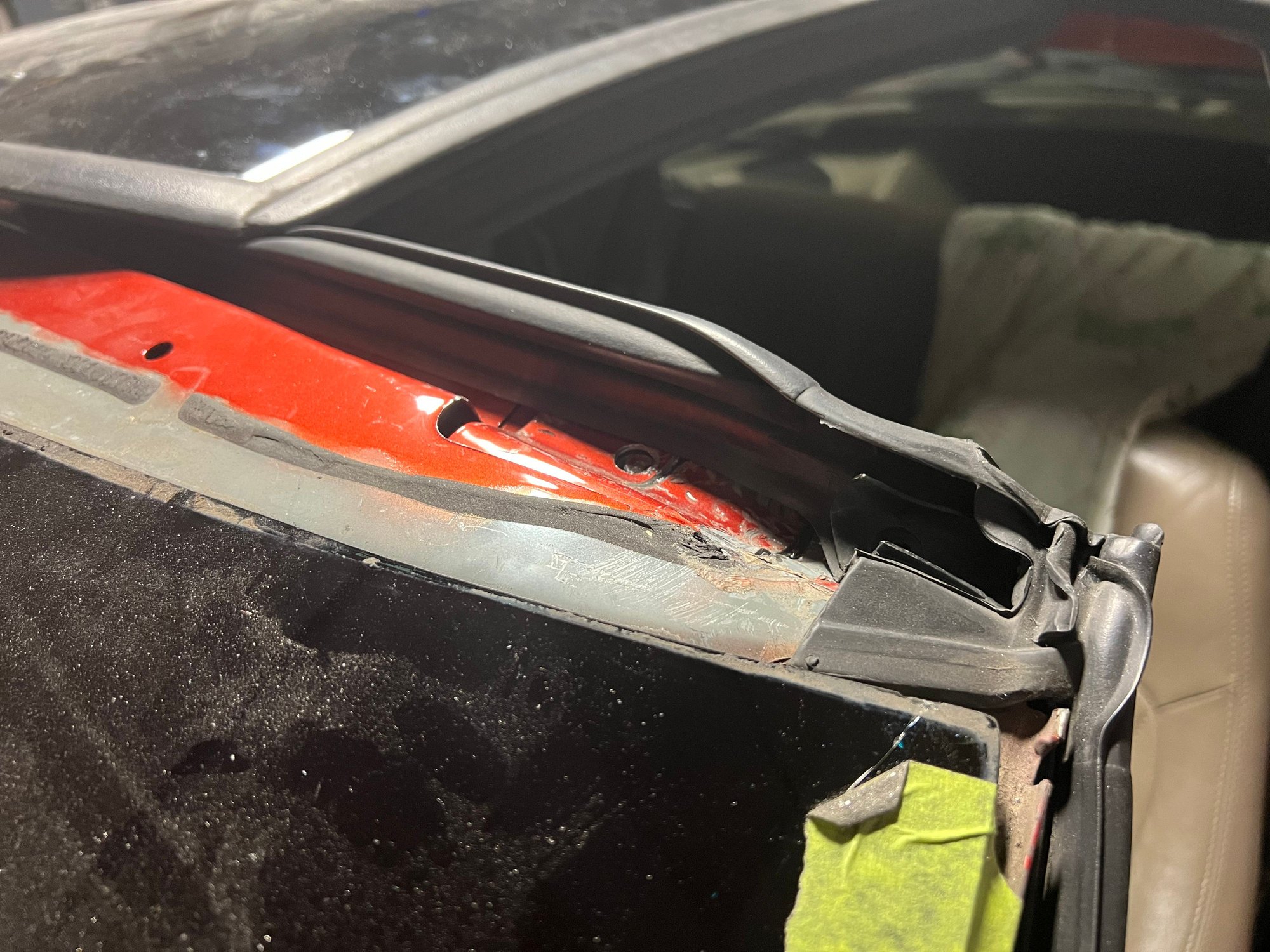

This kind of looks ugly as hell, but I tried to make small slits and use a hammer and punch massage the humps down and level it out. I figure the ugly will be hidden with fiberglass. I want to try to avoid rivets if I can as you will see those.
Hopefully I am still on the right track here. This is the back…

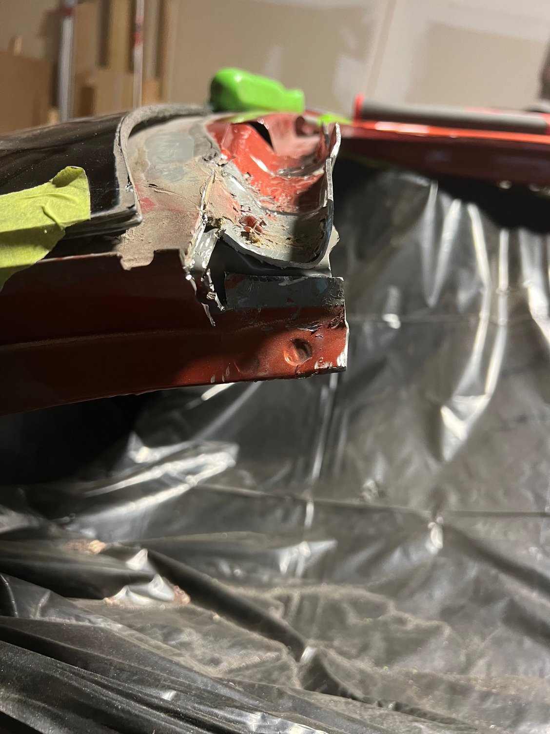

This is the front:

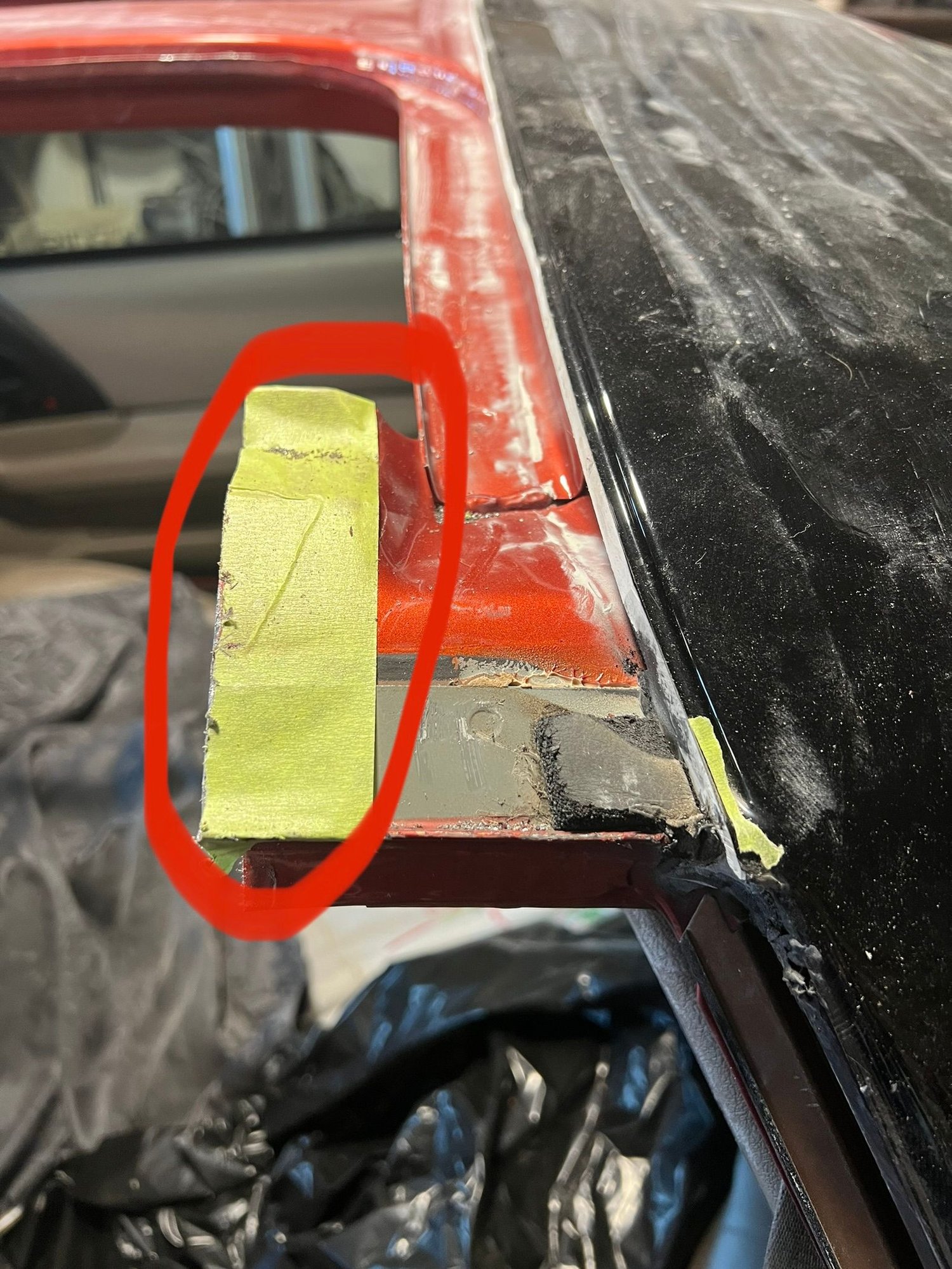

I am thinking that my next cut is this yellow line straight down. Then I can start fitment of the gasket and place the brackets into place.
Does that make sense? It’s hard to see in some of the old photos.

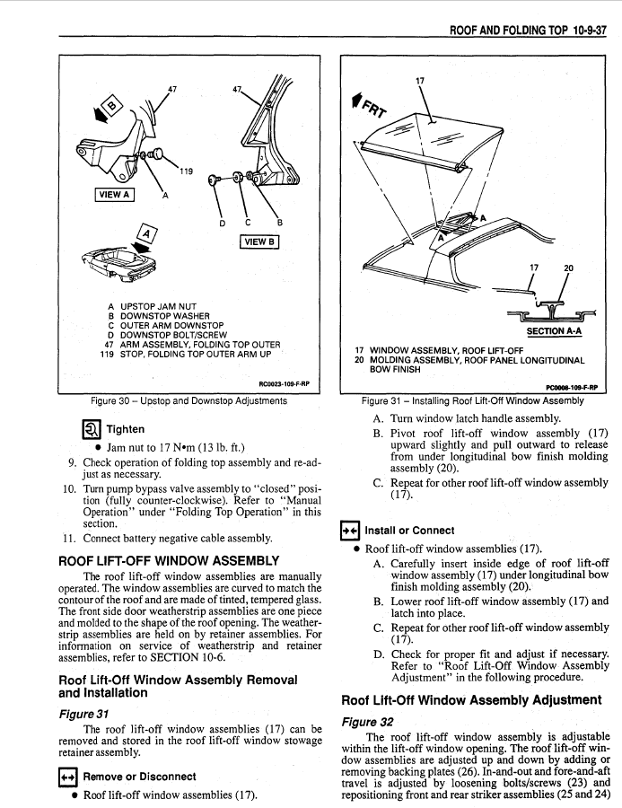

Also, is there a proper procedure for how to adjust the ttop brackets so that you get a nice tight seal and engagment? Is there torque specs on the bolts?

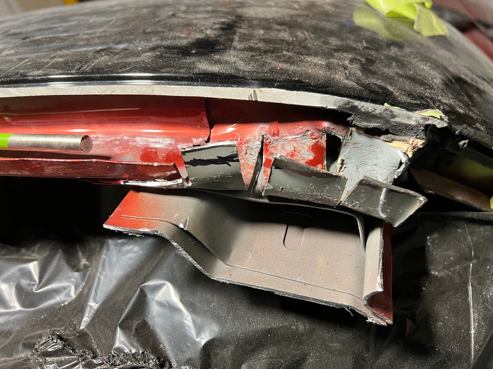

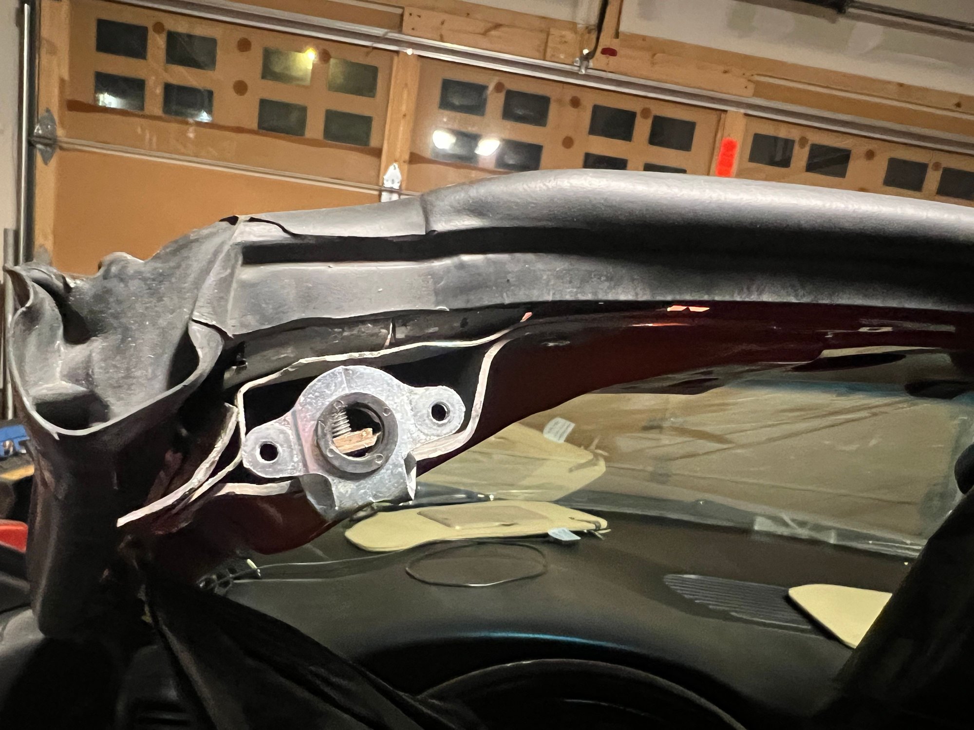

Weather stripping seems to be fitting pretty decent. Might have a few more spots to adjust. But this back gap is concerning to me. Shouldn’t the ttop be sitting on this lip? I feel like the ttop needs to push back some? Doesn’t appear I can do that though?
I have a bit of play up and down on the top, but I was thinking I still need to trim a touch more off the channel, but maybe not… need to figure out how to adjust the ttop brackets properly… don’t mine the gap at the windshield, I have the windshield weather stripping off
I think it's starting to take shape! There are many different ways to get the shape you're looking for and you are right in that your fiberglass / filler will clean up a lot of the ugliest stuff.

This is the front:
Looking good so far!

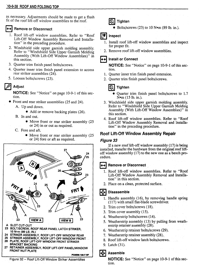

Yes, that would be a good spot to cut. Here are some adjustment tips from the 1994 Factory Service Manual:
That doesn't look too far off from what mine looked like:

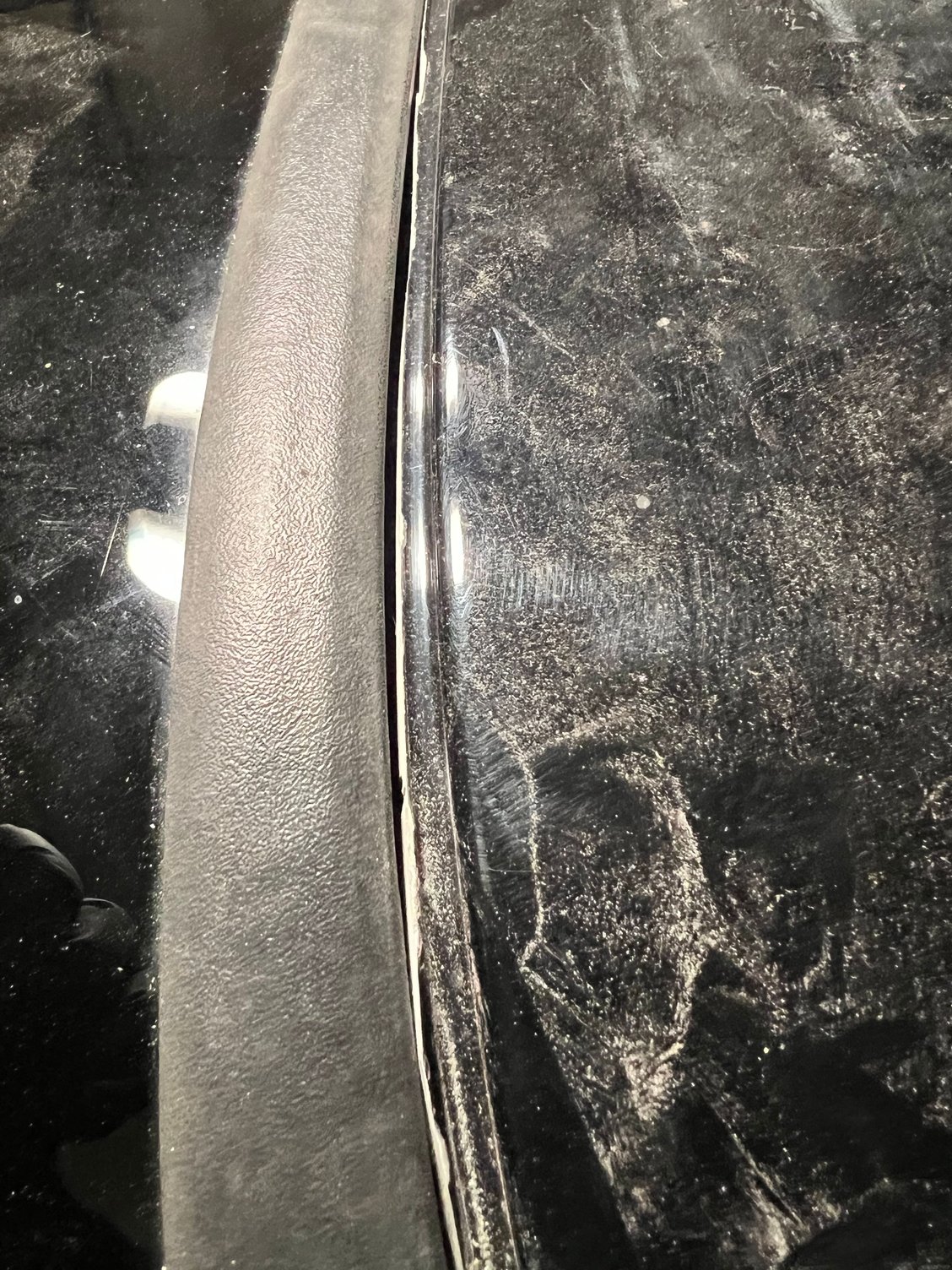

Thanks! Is it ok to have a gap between the glass and back sail panel? Or is the glass supposed to sit right on top?
