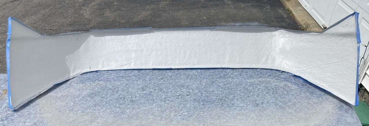

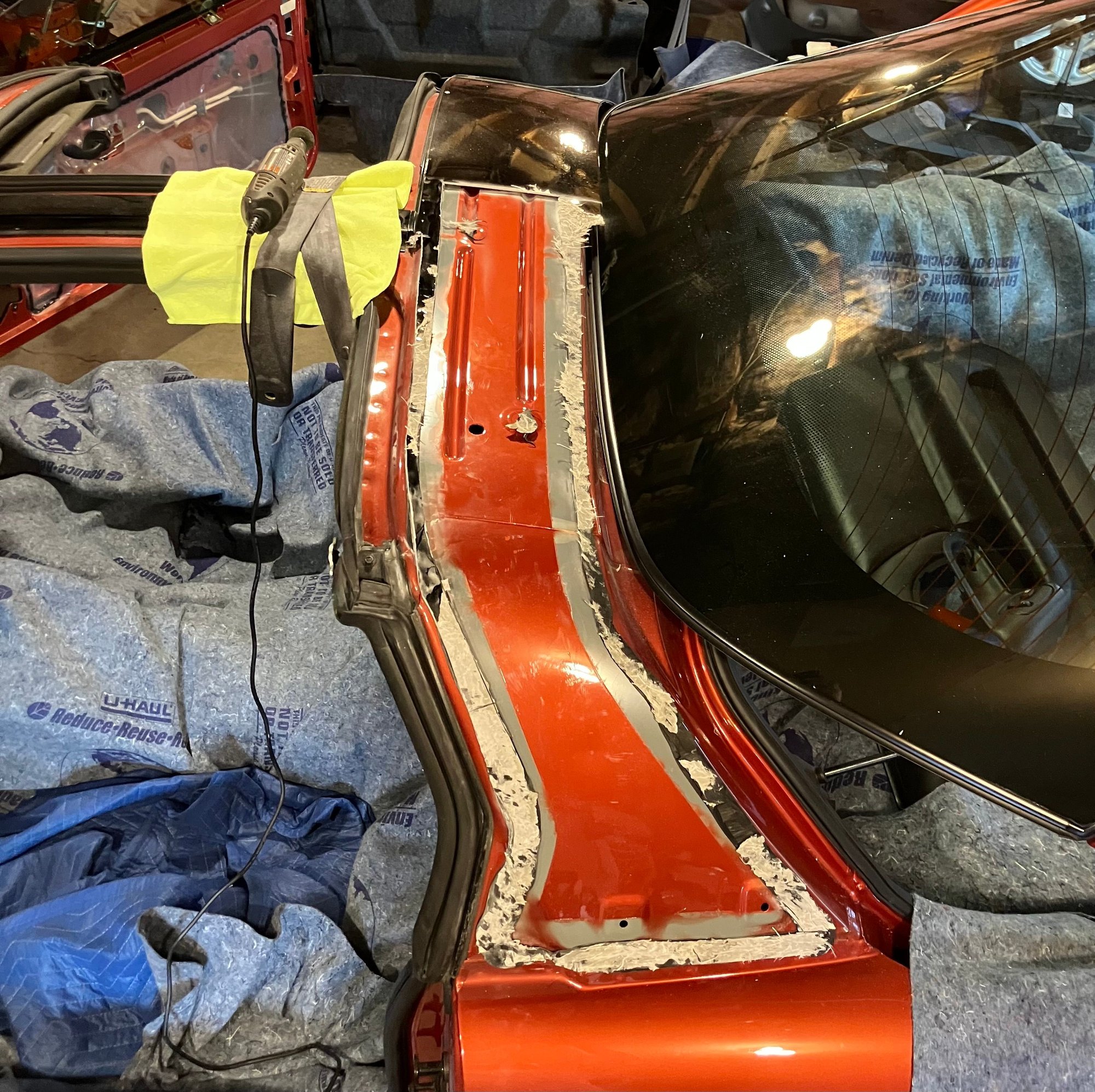

i removed the sail panel a few months ago using a dremel and shop vac. I’ve seen a few different methods but dremel worked best for me.
You’ll need for installation
Caulk gun
2-3 bottles of 3M 08690
2 cans of 2k epoxy primer
You have to spray paint the bottom of the new panel. Use both cans even though it looks like you only need one. Allow paint to cure for 24-48hrs depending on temp.

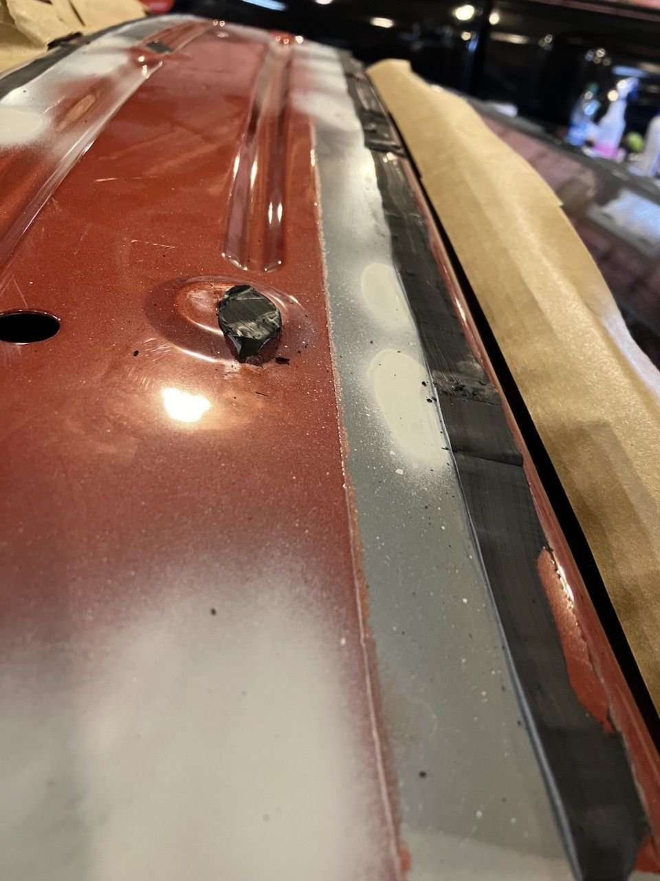

Remove most of the old adhesive but not all.
You’ll need a helper for install
The adhesive drys fast, ya might have 2-4 minutes to install and line up before the adhesive hardens
Start of removal
At first I did the pry method, but it dented and scratched the sheet metal, I didn’t like that.

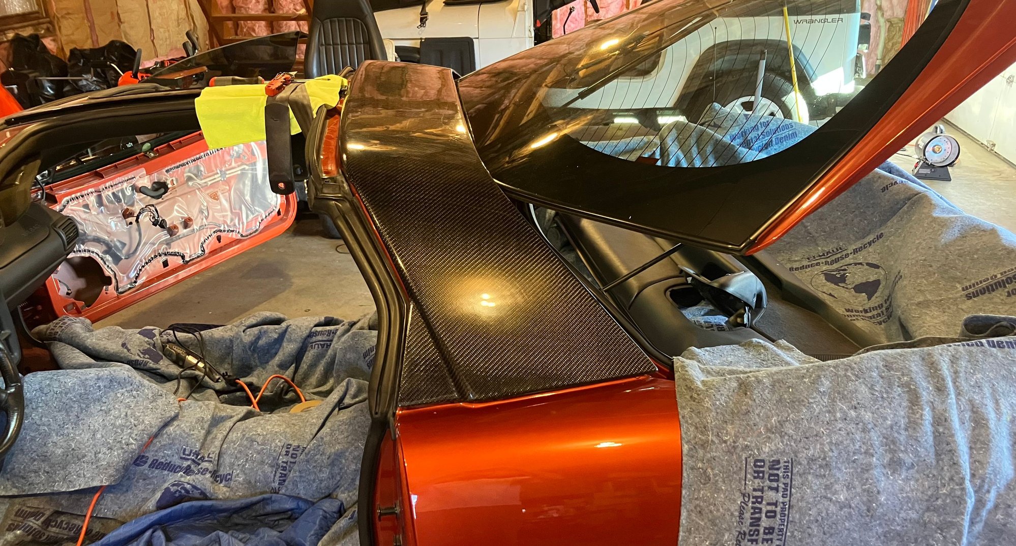

test fit
This job isn’t for everyone, once you start u can’t go back on it.
install this weekend. Very excited

^ I typically don't like the carbon fiber look on these, but it actually seems to work quite nicely with the SOM paint above.
Post some pics when it's complete.

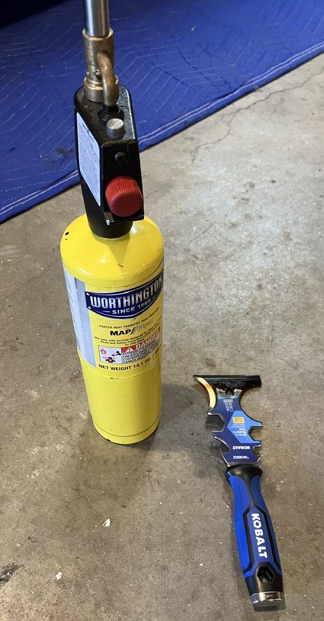

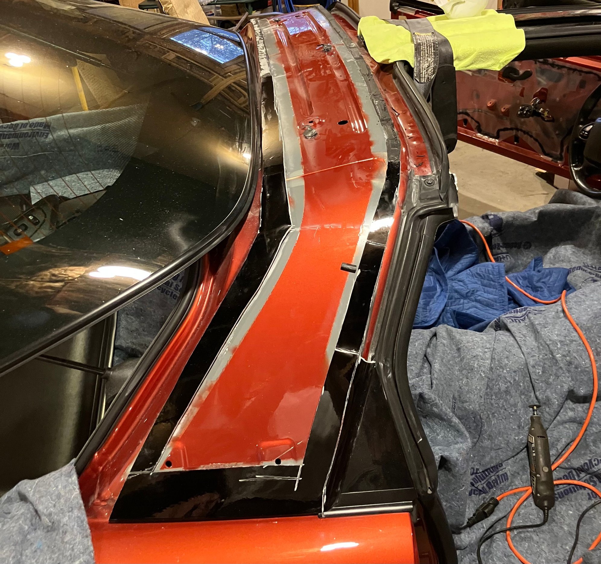

Used the torch to heat the scrapper, made removing the adhesive super easy. You have to reheat the blade pretty often. I also sharpened the scrapper before I started. Ended up cutting it down to the width of the adhesive. Also I tapped off all the rubber gaskets, seals and covered paint where mistakes could be made.
Started working on it but got wicked sick suddenly and had to go lay down for the weekend.
hopefully this coming weekend I won’t get sick and I can finally install this thing.
