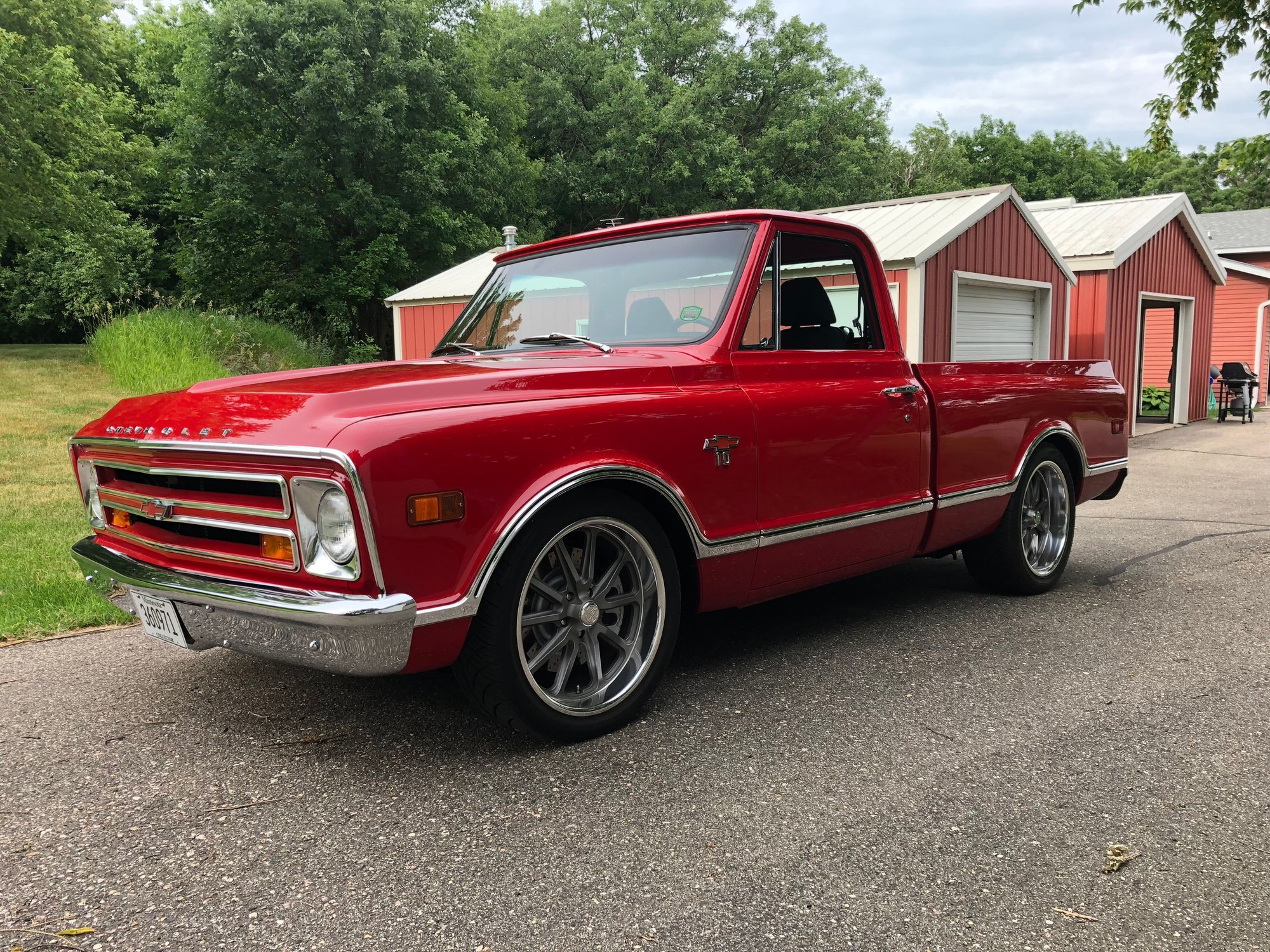

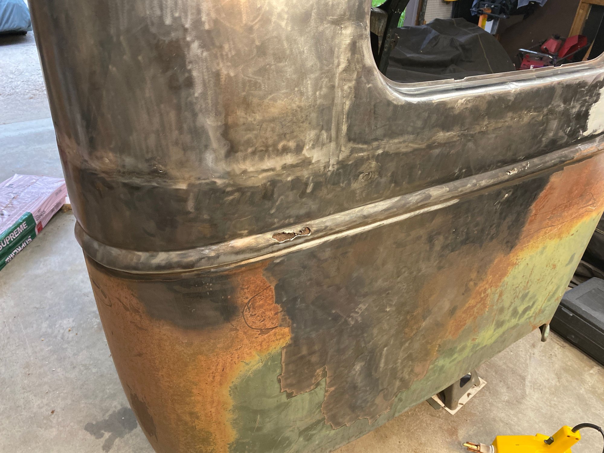

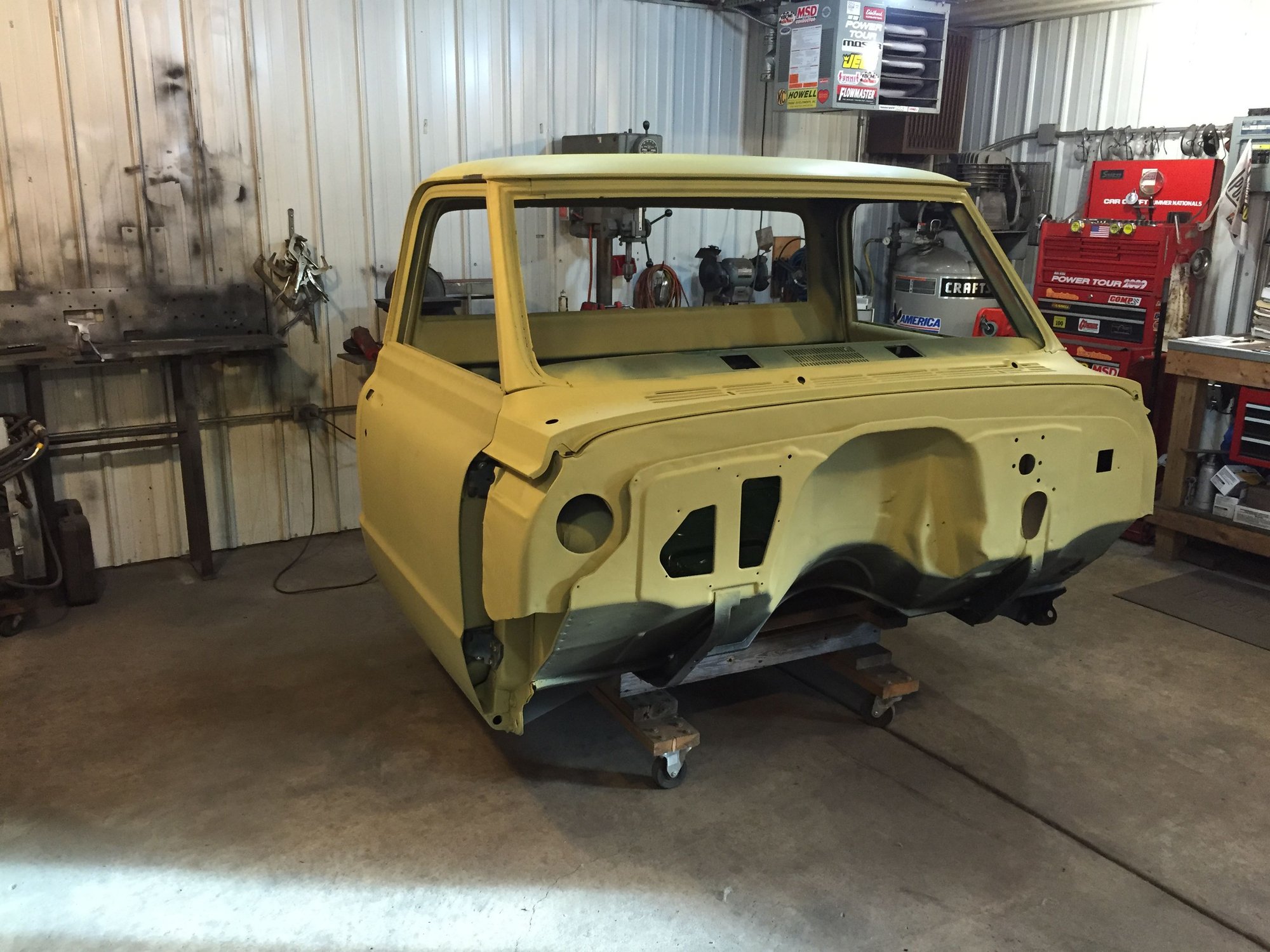

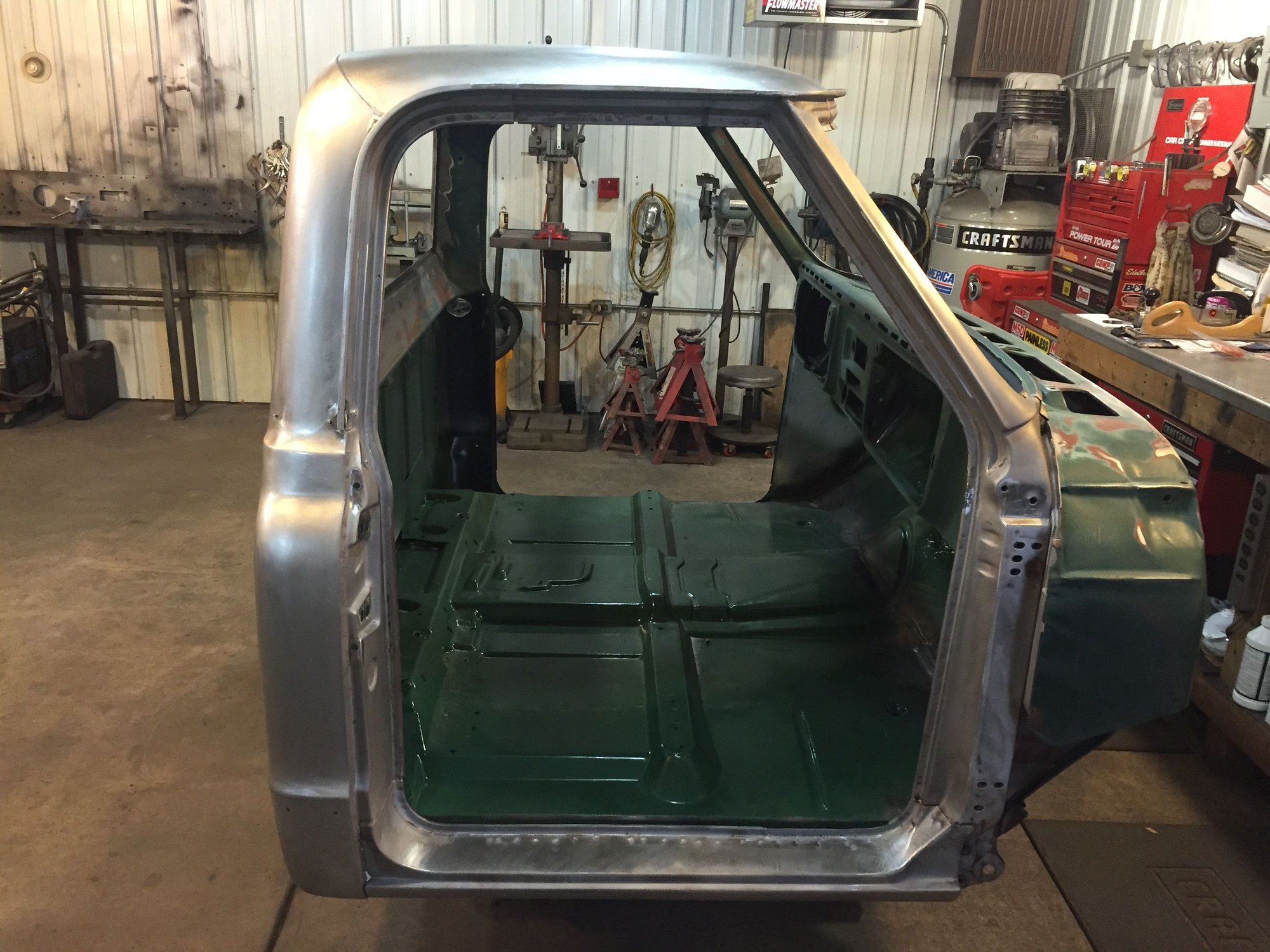

Depending what is going in your life I can offer this.
I retired about 7 years ago and was in the middle of a frame off 68 C10 build.

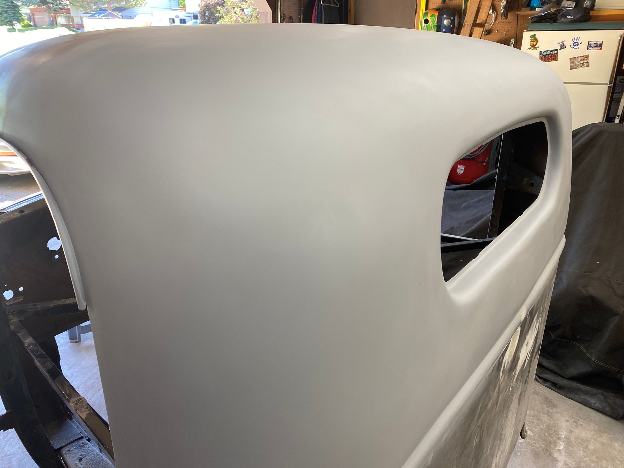

So I went down to a local body shop that has body worked and painted a few of my hot rods and asked if I could do the body work under their supervision? The owner said yes. He said there isn't anyone in the shop standing in line to block sand filler or primer.
So as I removed body panels and stripped them to bare metal in my shop and I then took them to the body shop and they 2K primed them. Then filler with a ton of block sanding. Then two rounds with 2K sanding primer. Then I stored them until all painted parts could be sprayed at the same time in the body shop booth. I did the color sanding with the shop guys looking over my shoulder. The shop did the cut and buff.
Before and after pics

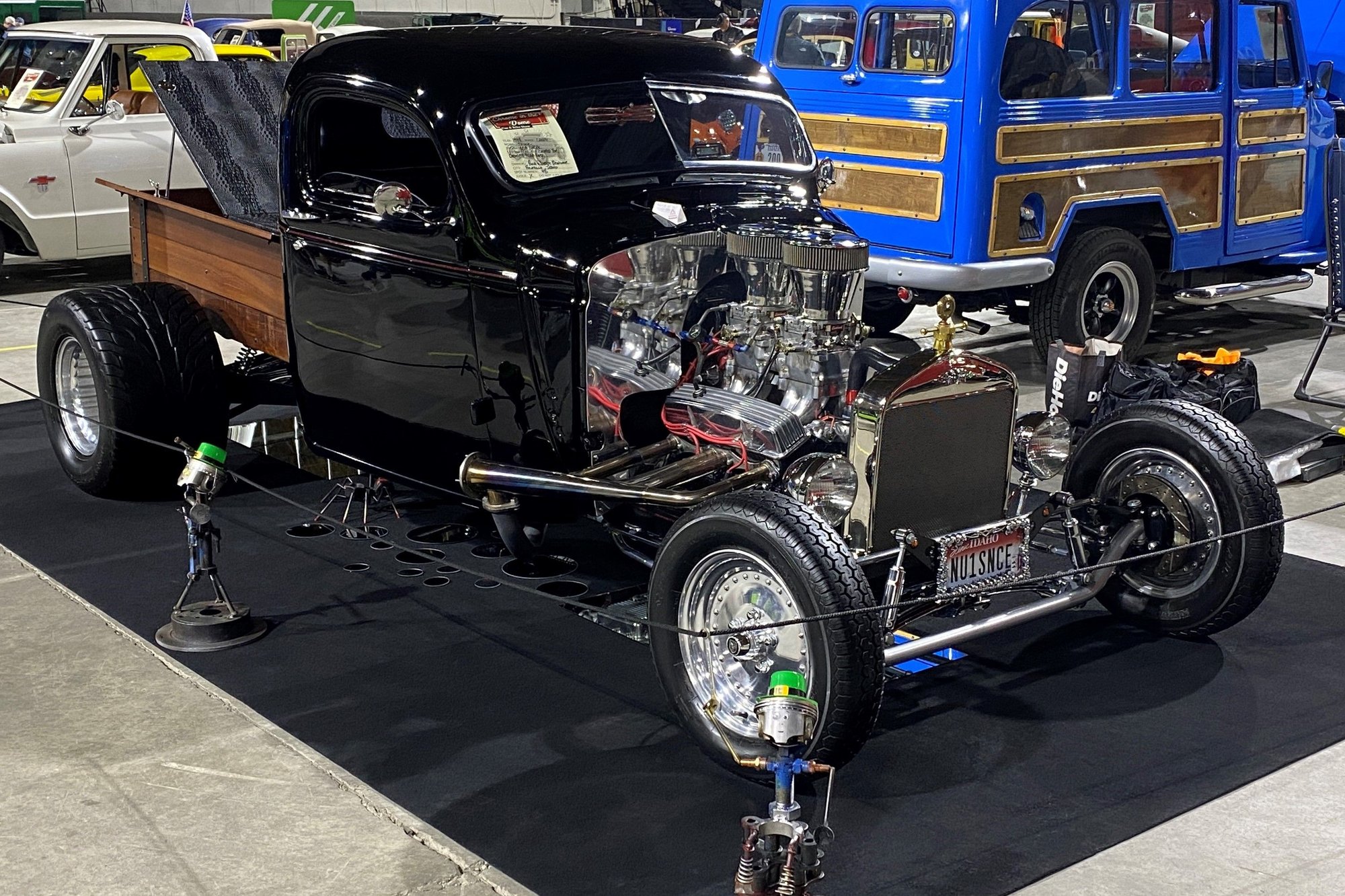

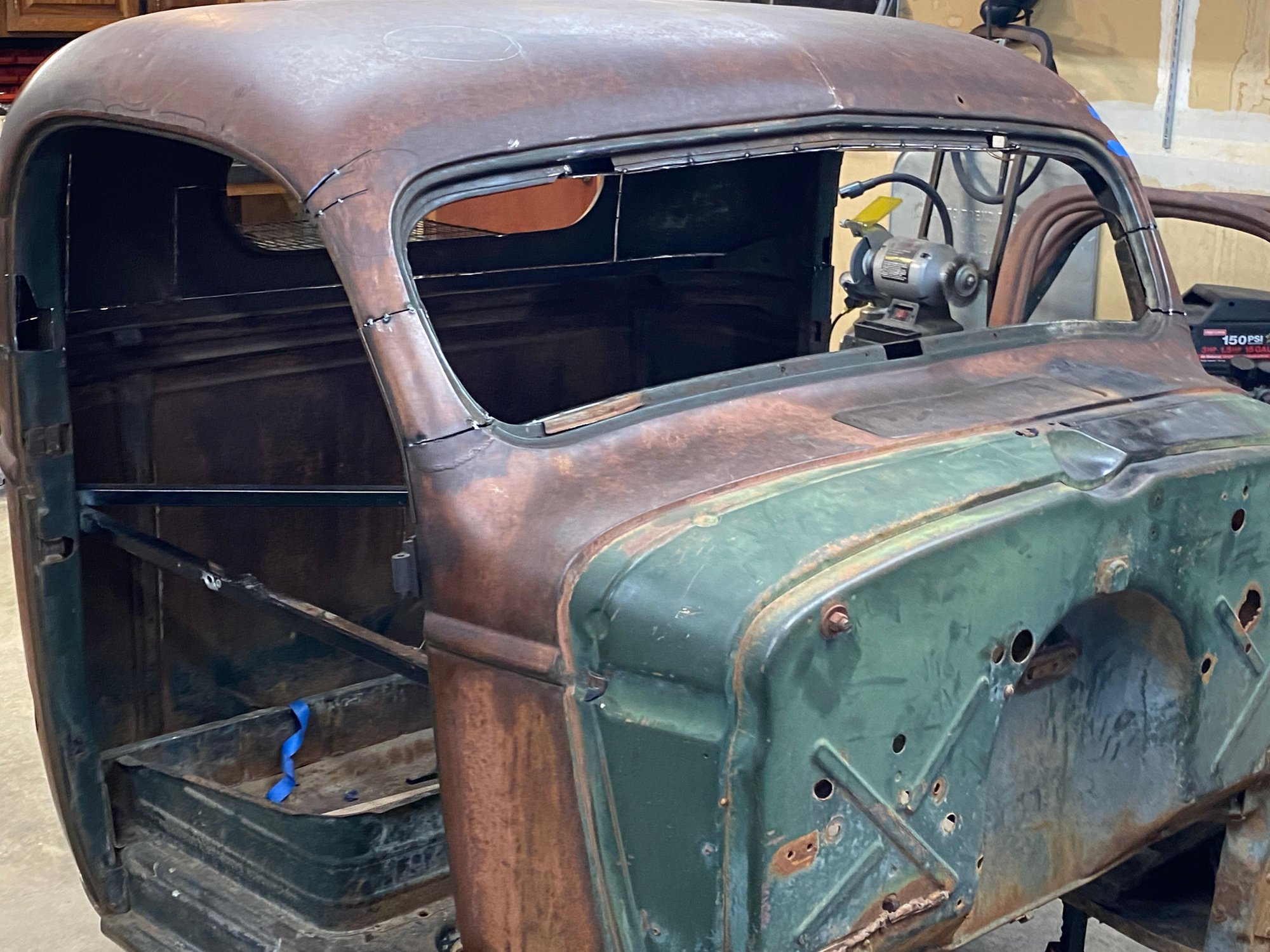

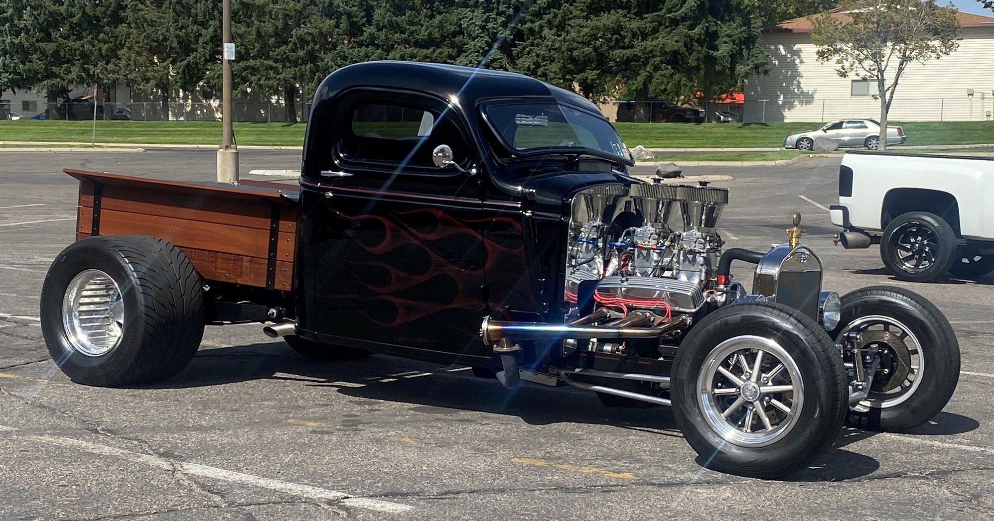

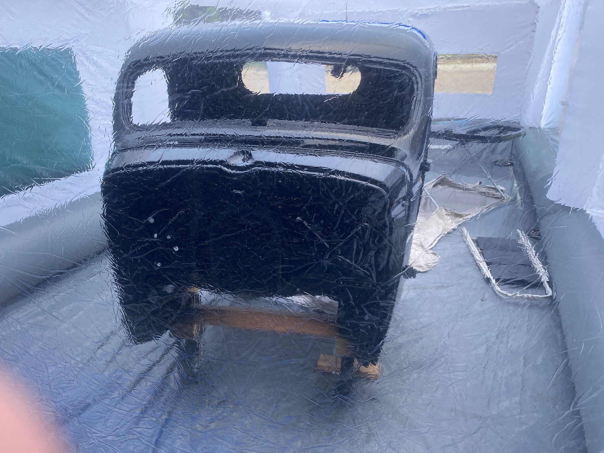

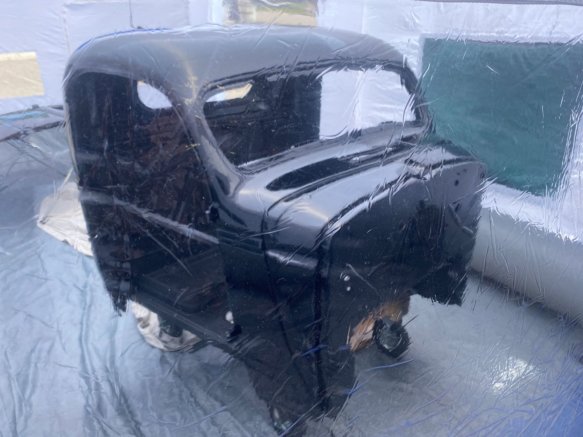

Sure have... You just have to be committed and take your time. Here is my hotrod that I did all the bodywork including chopping the top and all of the paint. Just takes time is all
Old May 6, 2025 | 02:11 PM
idahoz28's Avatar
Joined: Jan 2014
Posts: 266
Likes: 18
From: Pocatello, Idaho
Of course Im the kinda guy that has to do ALL of his own stuff. So I built the frame, motor, transmission, did the interior. You name it. 95% by me.

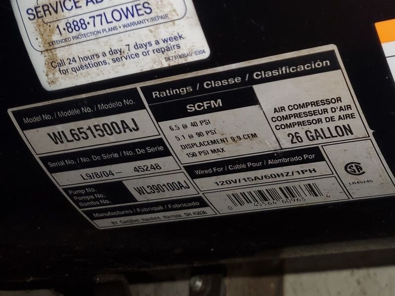

Do you have a decent compressor? That's the other thing most folks don't talk about. I would say at least a 240V compressor is needed for a bit of extra reserve if doing a complete overall paint job, even those lvlp guns...8-10 CFM would be on the lower end of the spectrum, in my opinion.

Compressor is a concern. I have an old 20 gallon (I think?) craftsman oil-free of some sort. I honestly don't even know if it works, it has been sitting for years. I got it for free years ago but the drain valve was shot so it couldn't be used. I replaced the valve a year or so ago, but I haven't had need of it. I've been using my little 2.5 gallon compressor for tires, blowing stuff off, etc. I was hoping the LVLP would allow me to use the 20 gallon compressor if it works.
*EDIT*
I went out to the garage, dug it out, and here's the label. Campbell Hausfeld WL651500AJ 26 gallon (bigger than I thought). The CFM rating doesn't look too bad. Comparing it to the D1 gun specs, it should do just fine as long as the compressor is functional.

I have a 40 gallon oil less compressor same brand as yours. I’ve sprayed trailers with it but no way would I do a car. It can’t keep up.

When you start to work a low end air compressor it creates heat which means moisture in the tank. Unless you have a top of the line water traps and dirt traps that stuff is going directly the paint gun.
Also they make "bulb" type water traps that attach directly to the input of your spray gun.
