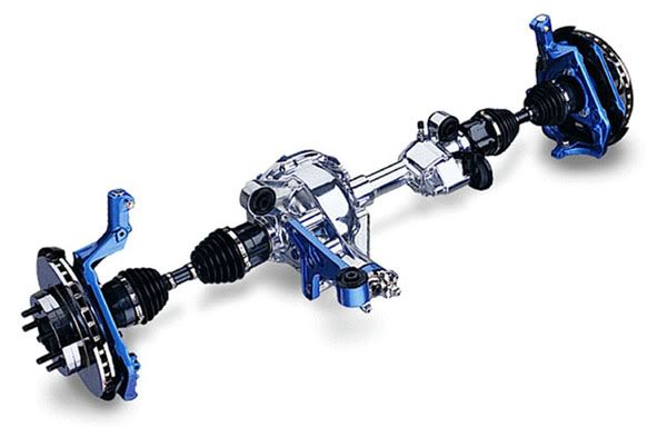

Posts: 6,814
From: Hou. TX.
Let me just say something, when your trying to build something crazy and unique you tend to hit a lot of obstacles. Since money can pretty much overcome any obstacle, let's say that all my obstacles relate to money. Therefore when one road hits a point where it's going to cost too much to fix, then I back up and take another road. The result looks like i'm always changing my mind, but there is always a reason for it.
So now then, I looking deeper into the mid-engine design again for several reasons which I wrote in my mid-engine thread.
The only real way to not alter the wheelbase is to mount the engine sideways (transverse). It will just barely will fit.
The only acceptable transmission is the new G6 6speed manual. After all the Internet searching I've done and then talking to my own trans specialist, I just don't think it's going to hold up to the roughly 450hp I plan to make. Cryo treating the unit plus the cost of the adapter is going to push the cost way out there beyond what I see as practical. Plus there is no LSD for it.
So I'm looking at one of my older ideas. A longitudinal mount with the trans facing the front of the car and then a gearbox (transfer case) to redirect the power next to the oil pan and then to a diff mounted right in front of the harmonic balancer.
I know the T56 trans will hold up to the power. I know the Ford 8.8 IRS diff will hold up as well as has an LSD. All for very little money. There's no adapter and no clutch parts to buy. All I really need to buy is the transfer case. I think I can attach it to the transmission and have the output be low and on the passengers side which is typical of most units.
Now this is all good from a money perspective, but it also means I'm going to have to move the rear wheels back quite a lot. So how do I do that? I'm thinking of making a one piece fiberglass tilting rear cover just like the Lamborghini Miura. Now how do you do that?
I know if I can get it to fiberglass, I can reshape the rear fenders to move the wheel openings further back. Can I just cover my complete black car with a protective layer of something and then lay fiberglass over it to create a plug? Then go in and smooth out the plug like the seperation lines between the fender and bumper, add in the mold of the rear tail lights and filler panel, etc...?
Or should I make a mold of each piece seperate and then make a single plug?
Or make a seperate plug for each piece and then mold all the finished pieces together?
Then what do you do up front? I really don't think the front wheels can be moved back any more than they are now. The brake booster is the biggest obstacle there. What I can do is shorten the nose so the short front overhang with match the short rear overhang. I'll try to do a pic and see what it comes out like.
Any advice on the fiberglass stuff would sure help.
Old Dec 15, 2008 | 07:32 AM
  #359
JasonWW's Avatar
Posts: 6,814
From: Hou. TX.
Here is the updated drivetrain layout:
Maybe I can modify the rear Diff like so:
Now I need to figure out which rearend shape looks better.
Traditional on top and Radical on bottom
What do you guys think overall? Is the body too long? Wheelbase too long? Do the proportions look right?
Overall, I think the radical tail is closer proportion wise and I'm starting to dig the looks of it. It makes the car look more compact and sporty and puts more emphasis on the rear wing.
