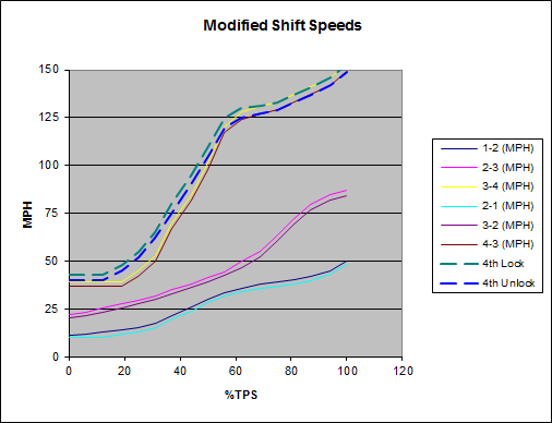

Since it down shifts for no apparent reason, doesn't mean it is. If the kpa changes, and the shift point is commanded real close, it can seem like it. I think its a good thing actually cause if it was the trans, I dont think it would be doing that. So hopefully its just a tune problem. Its possible the up shift and down shift table over laps, and that would happen.

Shift point settings can be a bit of a bear to visualize. I don't allow lockup in anything but OD and here is the visualization for how my shift tables are setup:
I played around with this a bit and keeping lock/unlock above the shift point gives you the ability to accelerate in gear without a downshift. Around 60% throttle I converge them so if you are giving it more than half throttle, you really probably wanna go and a downshift is in order. But at 75 on the interstate, a downshift is not needed to get up to 80-85 to pass someone.
