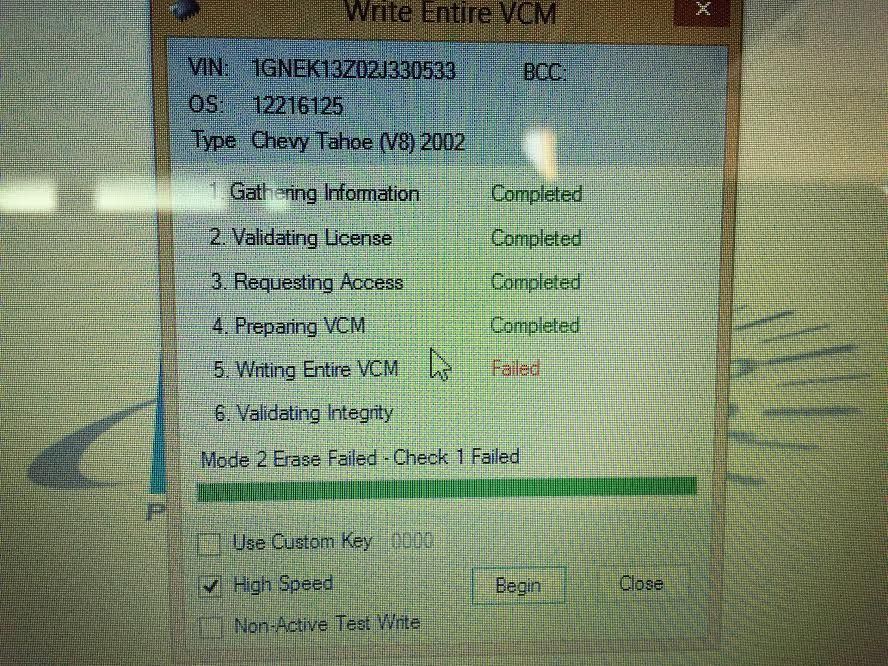

Tried the write entire and not going through. This is what I'm getting.

Hook a battery charger and try again. Don't set it more than 20 amps, low charge is enough

Didn't have any luck with that. But I did find I only have 11.5 volts going to the computer. At the relay junction box I have 12.4. So going to find out what's going on there.

Try a new battery or higher setting on the charger. That error is mostly related to low voltage to PCM
If you can read it without problems, but can't flash, it's a battery issue most of the time
