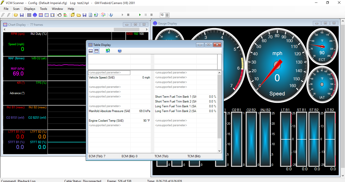

I attempted to scan my car, key on and opening the primary table its filled with unsupported parameters. I can't get hptuners to log anything, I hit scan and nothing but the map shows values. I used my tuners supplied config file, nothing but afr, map, and vehicle speed the rest of the tables filled with unsupported parameters. I switched to the default. Same issue unsupported parameters. Not sure if this is a software issue or somethings up with my car. I know its vague, but any ideas on why its not reading or showing any of these parameters?

ok did some reading, apparently I am missing the majority of the standard pids. All I have showing up are: vehicle speed (sae), MAP (sae), and engine coolant temp (sae).
How can I insert the standard pids required to log the vehicle, or better yet why are all the tables the standard pids are supposed to be located displaying unsupported data?

Not many responses to this yet, but here is a screen shot of what I am seeing

Version 2.24. I hooked up to my other car and the scanner worked fine. It seems there is an issue with the car, I'm just not sure what would cause it and where to start trouble shooting.

Has nothing to do with config files. Find the HP Tuners>VCM Scanner>Vehicles directory and delete all the files. The next time you connect to any vehicle it will re poll the vehicles for supported PIDs

That was the trick! I was able to log the car, thanks man! I was going all through the car with my multimeter until I read your post.
