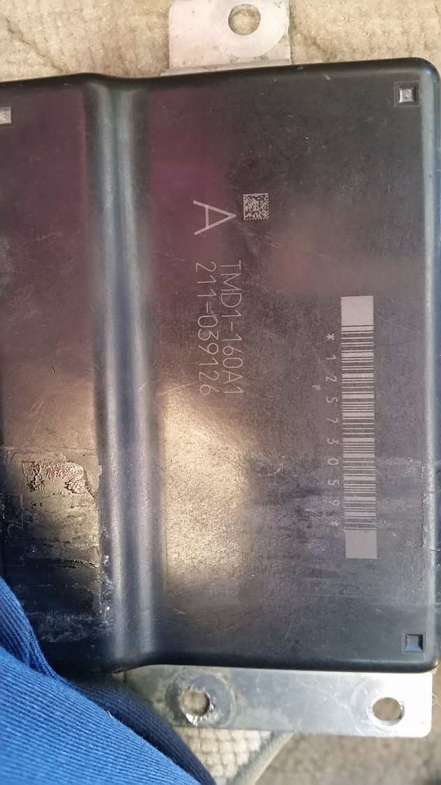

OK so I've been having an issue for quite some time with my electronic throttle body. Need some help. Recently I've been getting nothing but the u0107 code which is saying I'm losing comms with the tac. I started noticing issues at WOT as the engine would cut out around 4k rpm. Kinda embarrassing when I'm racing. I already replaced the pedal position sensor, throttle position sensor, throttle body clip, and harness from TAC to Pedal. I've re-ran every wire to everywhere with this electronic setup. Only things I haven't done yet is replace the 16 wire clip on the TAC and the actual TAC itself. Anyone else have this issue and any luck resolving it? I attached pics of the TAC TAC p/n
The left plug harness has been replaced wth a new one. The right plug is on order

It's off of an 04 suburban with I believe the blue/green ecu. All I know about the TAC is what the pic shows as far as part number and what not. The pedal is off the same. It has been programmed for standalone and tuned. I've had issues with the DBW for a while now but not the u0107. That's the only code I get now. How likely is the actual mechanics in the throttle body the fault or even the TAC?

"Update" so I replaced the connector that was coming in the mail and still no change. When I turn the key on I press the gas pedal and it sounds almost like the butterfly isn't smooth operation. I do it for 2 more times then I get nothing and it throws the code. After I clear the code I go to start it up and it sounds like the engine chokes for a second then starts up at high rpm with no throttle response. My next component to change is the TAC so does it matter which TAC to use? Pedal, pcm, and throttle are from 04 suburban 5.3 flex fuel option, not sure if that matters
