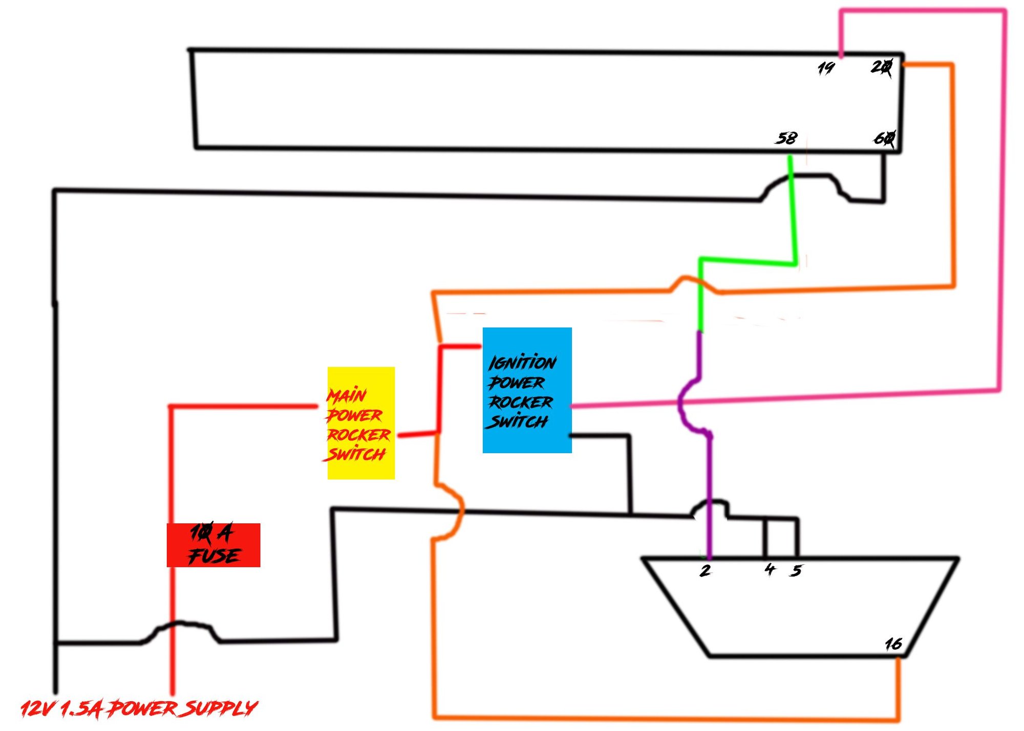

I attempted to build my benchtop harness this weekend. I wanted to use 2 switches, one for powering up the benchtop and the other as an ignition switch. I believe I have everything close to being correct, but HPTuners is reading that the interface is connected, but not reading the "car" to be on. Hopefully someone can tell me what I am doing wrong.
This is how I currently have everything ran. Both switches appear to be working in this configuration.
Benchtop Harness (Not Working)

run a ground to j1-1, 40 not to 60
B+ also to J1-57
some controllers also need ign to J1-75.
not all controllers need these, but all will work if hooked up like this.
efilive has a write up for this. Steve

Thank you for the reply EFIHARNESS!
I hate to admit this, but I picked up a multi-meter today and found that my power source positive and negative were backwards. I switched it around and re-adjusted my switches accordingly and everything is working.
