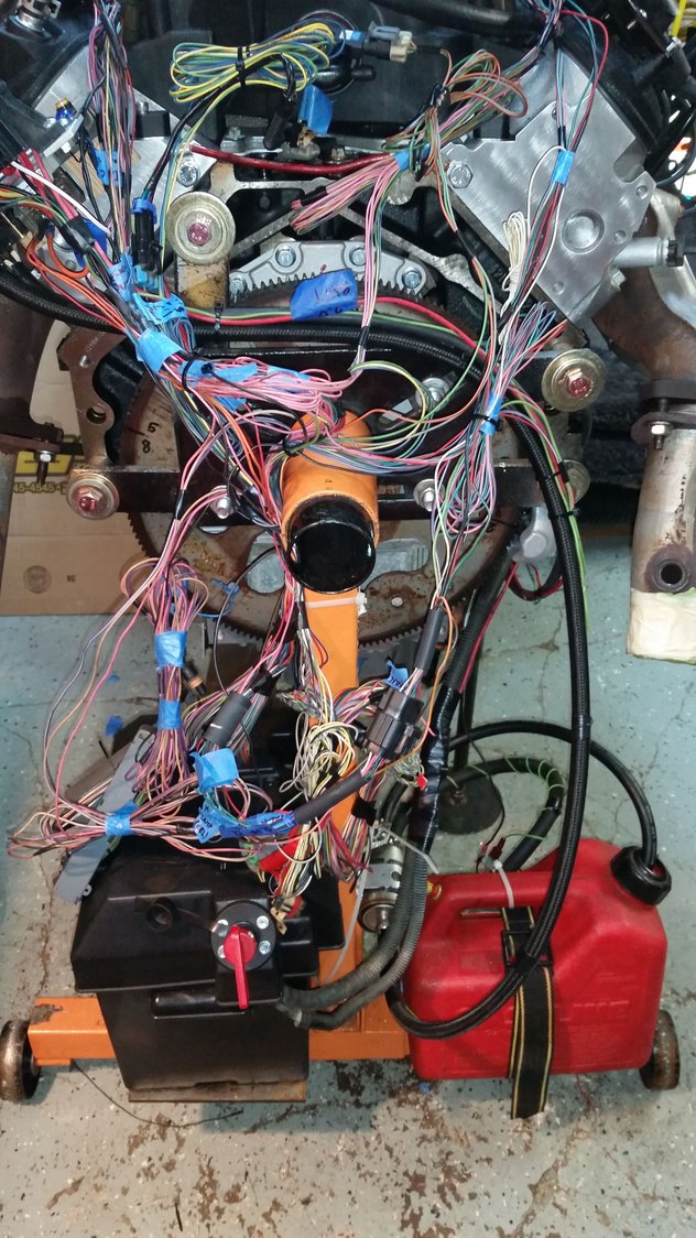

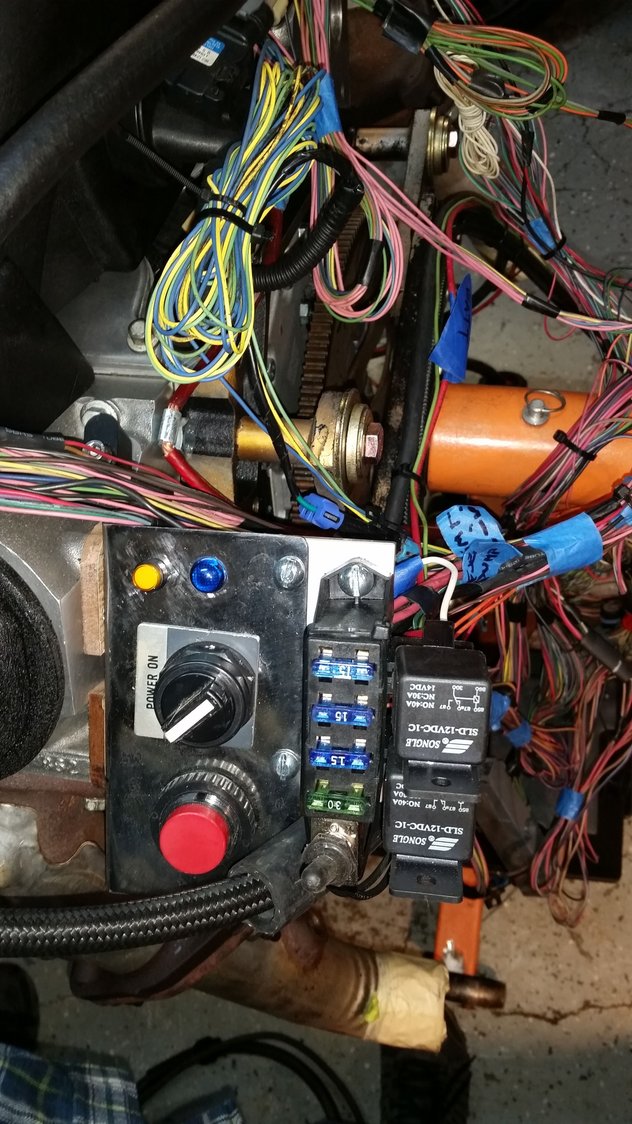

One thing that has been on my mind is my test stand wiring. I have a main disconnect on the battery which kills all power at the battery box. Then there is an ignition switch on the operator panel that when turned on powers up the PCM, sensors (orange and pink wires) and activates the fuel pump.
My question is should the orange wires (PCM power) be hooked to the side of the battery disconnect that stays hot all the time, even after the battery is disconnected?
I wonder if killing the computer when the ignition switch is turned off is killing its memory and causing problems?
