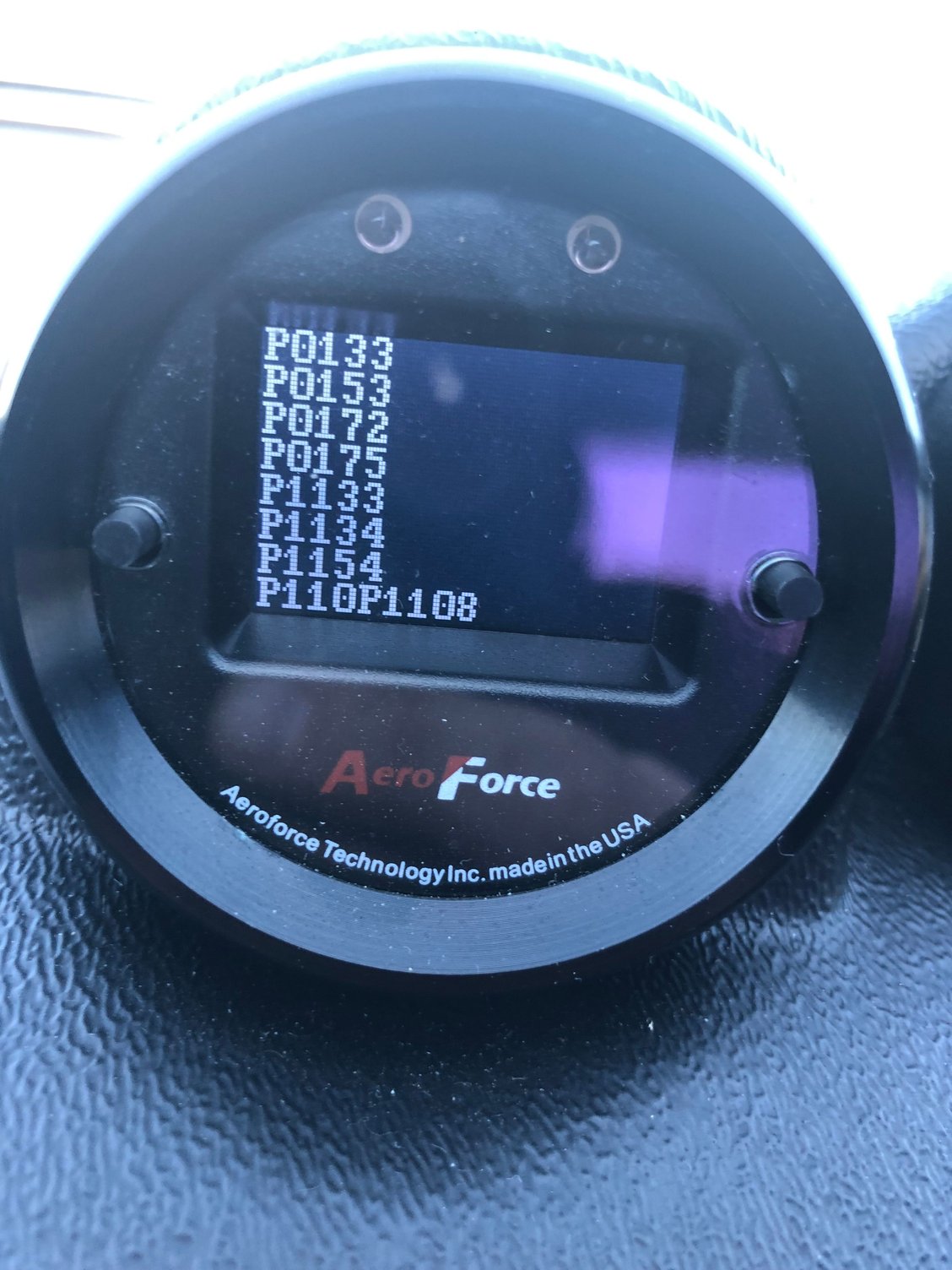

What do y’all think? Tried cleaning maf and cables seem ok. Around the same time this started popping up I also had my sub amp go into protect mode... runs fine

Yes, high probability of a bad ground. How many watts power total does your stereo system consume? It is also possible that your stereo is pulling your PCM power voltages low which confuses it.
How close does your stereo system get to your PCM? Big stereos generate interference that can also cause some of these things.
How many amps does your alternator produce?

about 1800 max total. PCM is under hood, system is opposite side starting at battery.
The other amps work fine for the tweets and mids. Verified the grounds for the system in the trunk and by battery. Also if I disconnect the amps and stereo from power and ground problem persists even after multiple clears.
im wondering if something came loose behind the amp rack in the trunk I can’t see. May dig into that next.

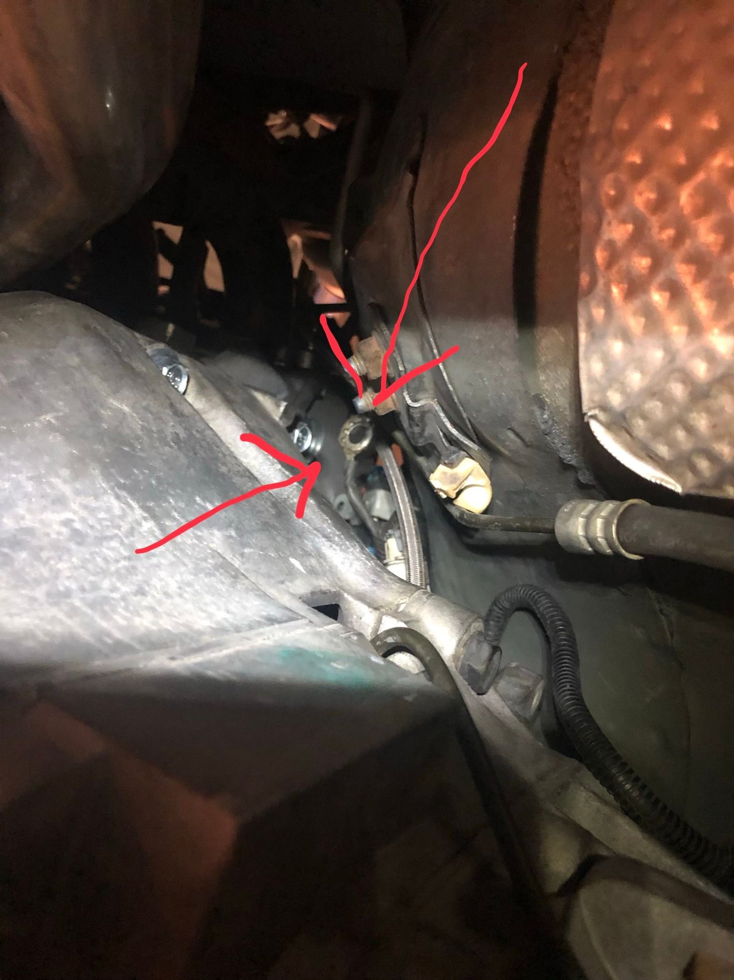

Think I found the problem. Forgot to bolt down a ground wire when I reinstalled the engine and transmission. 2 foot extension and a swivel fixed it.
