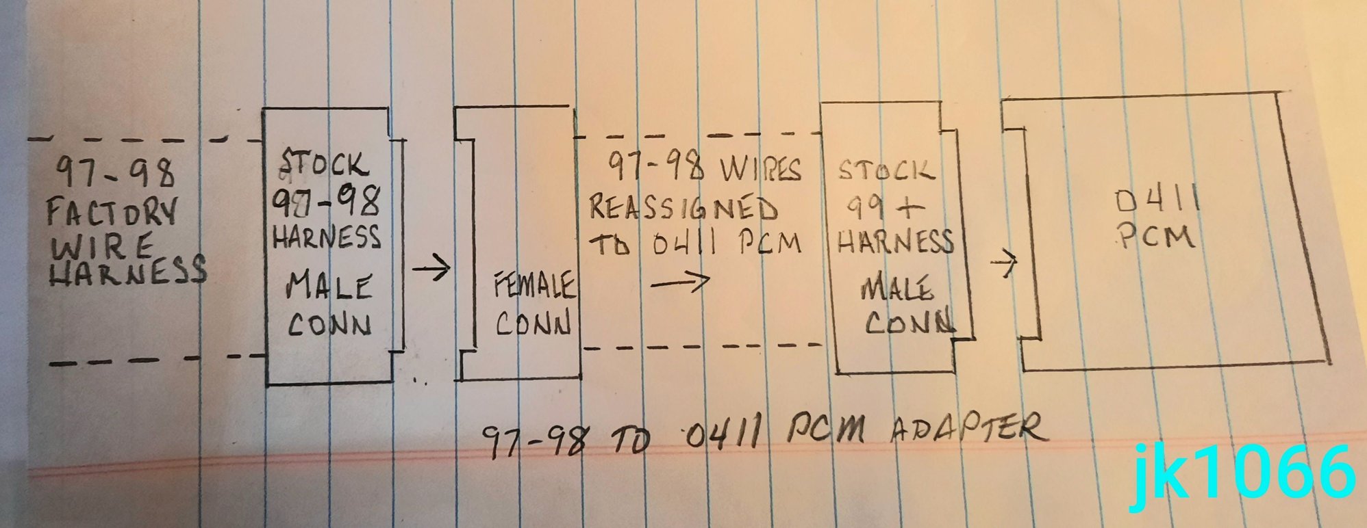

Old Oct 16, 2020 | 01:25 AM
  #88
dlandsvZ28's Avatar
Joined: Jun 2003
Posts: 1,869
Likes: 99
This is what I think would be the easiest build yourself if male Delphi 40 pin PCM connectors were available. The female Delphi PCM connector and housing is readily available. I have been unable to find a Delphi equivalent male connector that would mate to the female Delphi connector.
Am thinking this will be a winter project.
When finished the harness would like the Ford Extension harness in link below.
https://www.ebay.com/i/253287100496?...evt=1&mkcid=28
Old Oct 16, 2020 | 08:14 AM
  #89
JGKadell's Avatar
Joined: Apr 2002
Posts: 1,295
From: Brighton, IL
Basically what I had in mind. A quick drawing to give a visual.
Old Oct 16, 2020 | 08:44 AM
  #90
dlandsvZ28's Avatar
Joined: Jun 2003
Posts: 1,869
Likes: 99
The stock 98 harness plug ends are female and plug into male receptacles on the PCM. So the adapter harness plug ends need to female plug ends that connect to the PCM.
The PCM contains male pins. See link.
https://thejeephut.com/ls-engine-ecm-mount-motobilt/
There are female plug ends on the stock harness. What is NOT available is a kit like below that contains male pins. See link below.
https://www.customconnectorkits.com/...RoCoC4QAvD_BwE
If you were to repin the existing harness IMO it would be easier to buy the kit above and reassign the wires into connectors in the kit than to try to use the existing harness female ends.
However, IMO still easier to build an extension harness that contains four 40 pin male connector plug ends. Either way you only reassign the pins on the PCM side of the extension harness.
