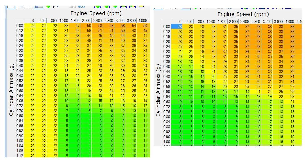

I attached the tune and a brief log of the car idling (Hopefully it posts). Does anything stand out to you guys?
Old Jul 19, 2019 | 04:41 PM
SoCalDave's Avatar
Joined: Apr 2019
Posts: 365
Likes: 133
From: California
I took a look at my '01 Camaro's tune and compared it to your 5.3s tune. Your timing at idle is far too aggressive and it needs to be backed off. Take a look at your tune on the left and my tune on the right.
I also sent you a PM.

Aside from messing with the tune (I haven't touched it yet) I'm pretty stumped. I'm running out of things to check. I pulled the intake and checked the gaskets, and they look fine. The only two things pulling vacuum is the power brakes and the transmission. Both are connected to the back of the intake and look fine. The inside of the intake is slightly oily, more so on the driver side, but nothing crazy.
The clamps on the intake tube are tight, including the ones around the MAF.
I even pulled the front of the engine apart to make sure I didn't install the cam a tooth off, and everything looks good.
I'm officially stumped. Am I overlooking something obvious? Where should I look next? I didn't see anything in the tune that would make it incredibly lean, but then again I'm still learning so I could have missed something super obvious.
