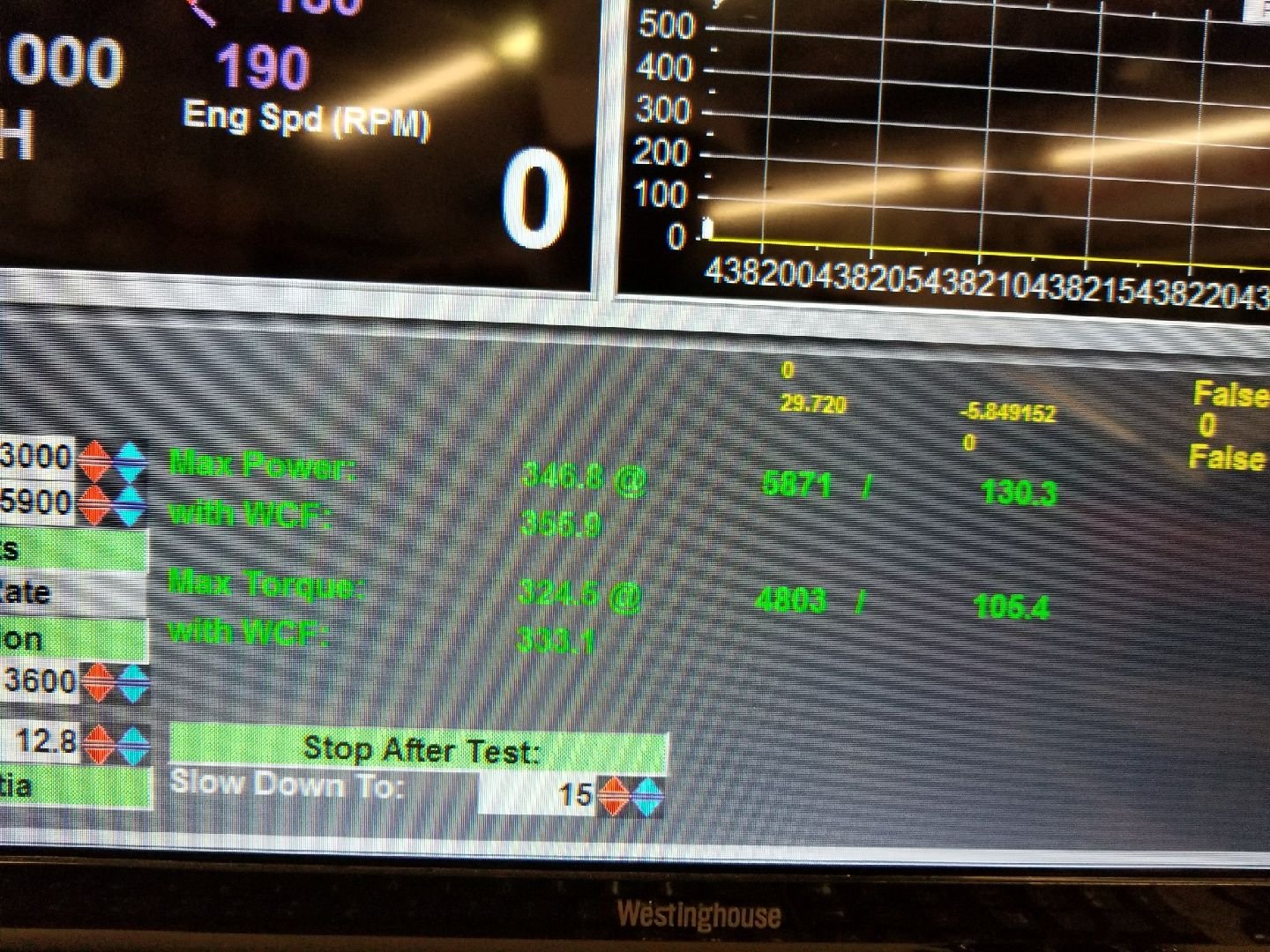

Made 346hp at 5871 with these mods.

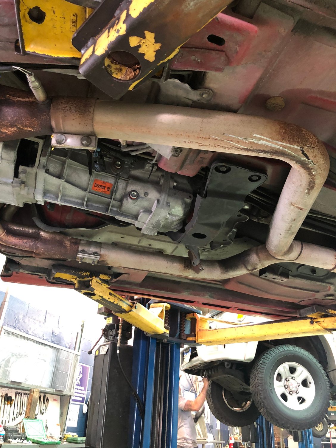

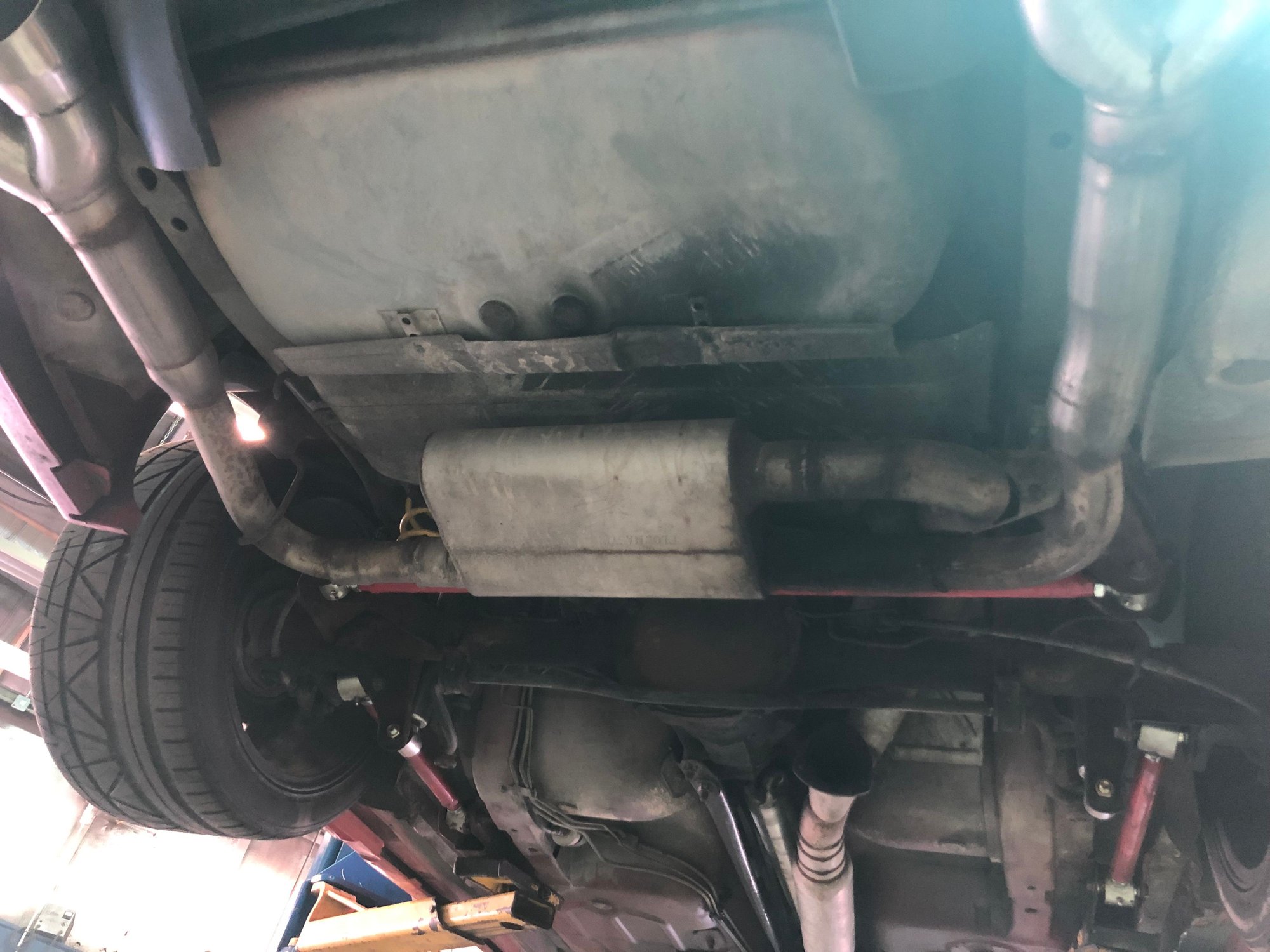

Take a pic of that pacesetter Y. If it is what I think it is, that is a big part of the problem

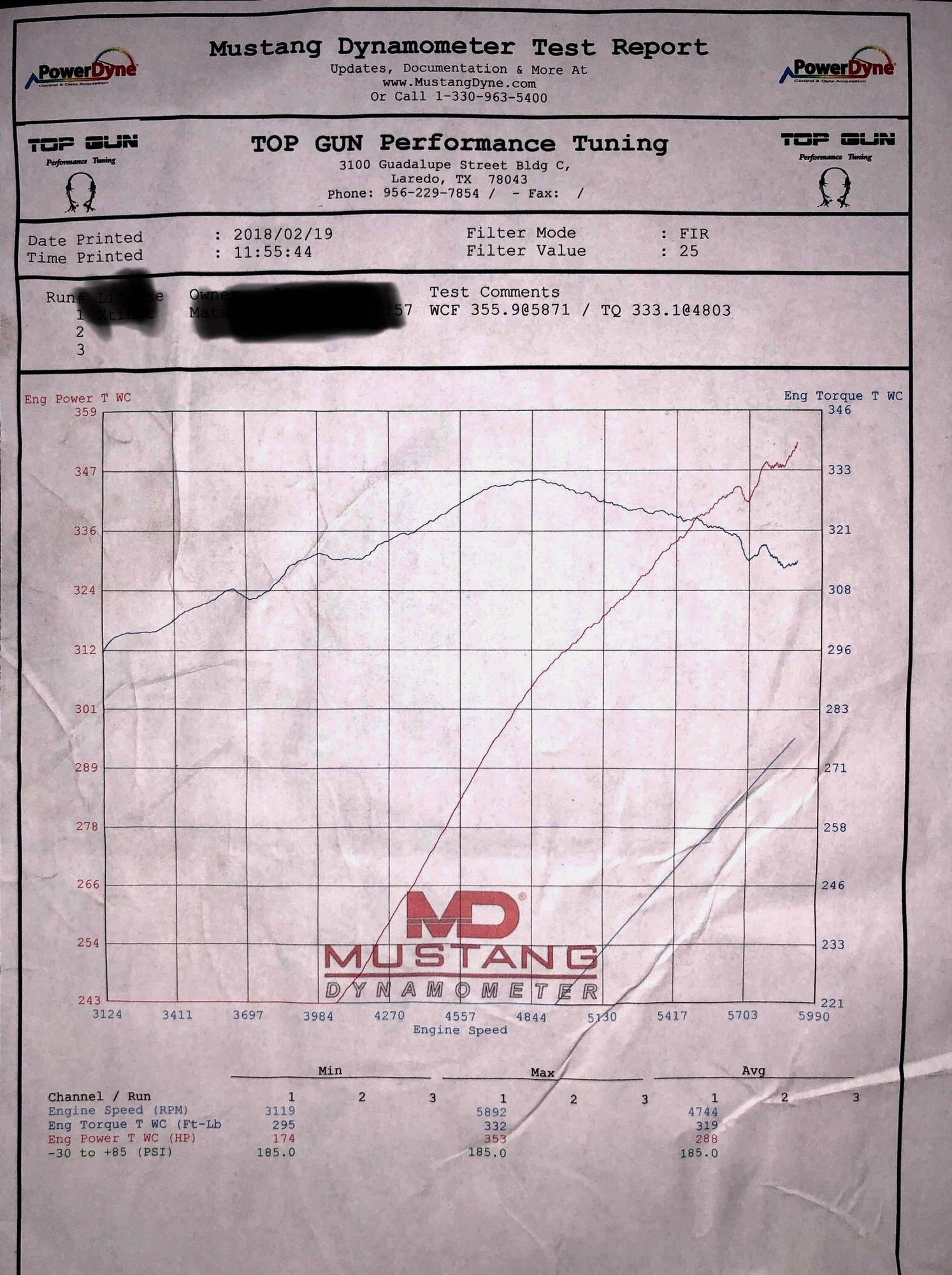

Ill have to post the underside tomorrow when I put it up on a lift to get a clear picture but here is the graph if this provides better data. Cut out was closed, I was told it wouldn’t make a difference, which I could was odd

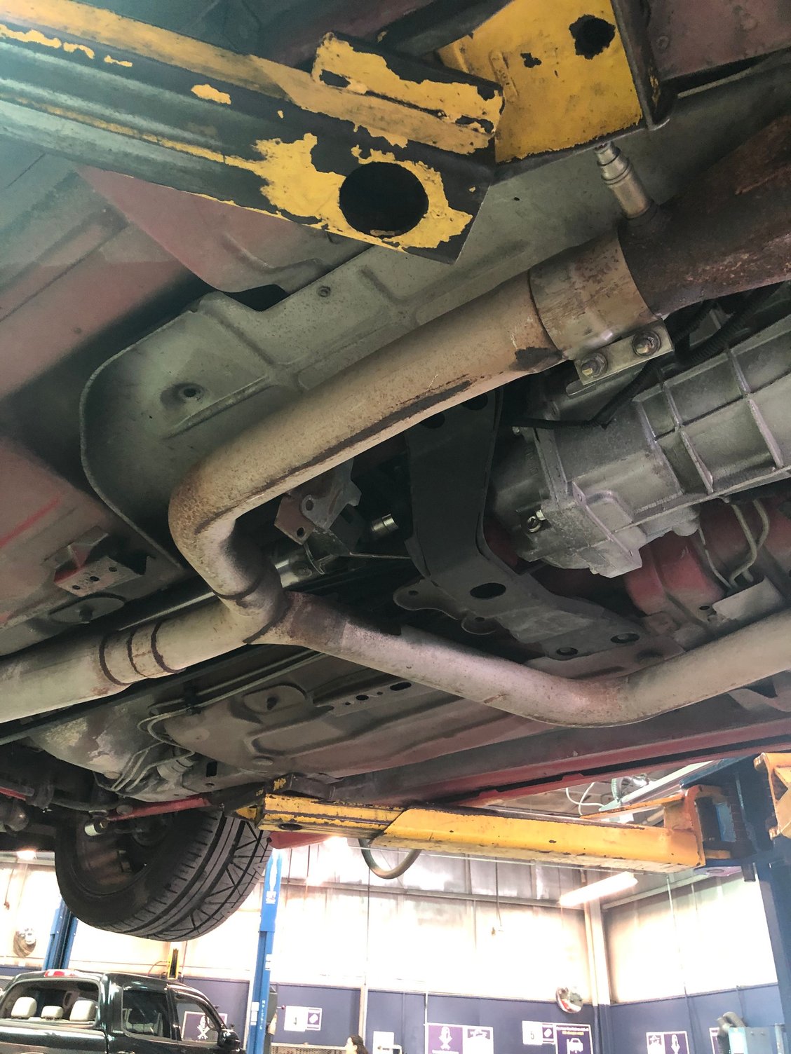

Here is the pic of the y pipe. Exhaust system is pretty rusty

Ok your dyno operator lifted early that is the problem. Look at the power curve. It was still going up.
I would also advise you to look into a flowmaster merge. And either get a refund from your dyno operator / tuner or have them pull it to 6800 rpm.

Is this her first time tuning? Why did she stop? Your power is clearly climbing...
Doesn't make sense. Did the tuner think there was something wrong?

- H/C/I/E and they only spin it to 5800 rpms...
- I also found this to be insanely odd that she said....
"My tuner said she doesnt like much timing due to the load and the low gearing(3.23)"
- Cutout closed..... also some more silliness.

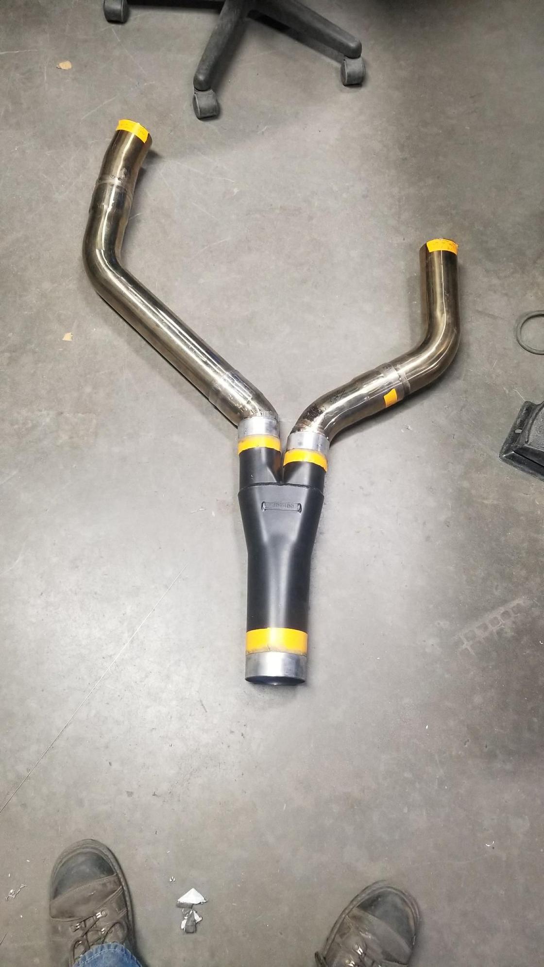

That y pipe merger is also
Get it looking something like this. Here is mine and right after the merger I have a 4in. electric cutout.
we used a merg like this about 8 years ago and picked up about 30 tq.
