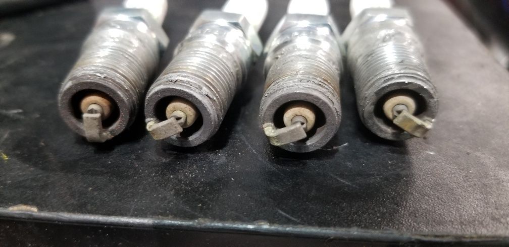

Okay...I guess my eyes are worse than I thought...I am 56 years old BTW...
I definitely see, in the pics, speckled porcelain.
I also actually dug up my old spark plug receipt, and these have actually been in there since the car was turboed, TWO YEARS AGO...
That being said, I definitely look to be getting detonation, but I also found a loose heat shield, on passenger side, above the collector and forward....the smaller one was jingling around...No idea how I didn't see the speckles, or the shield the other day...
Plugs on the shop towel, are from the driver side...
the other 3 pics are all of the passenger side.
Front to back, Right to Left
I put new ones in, gapped at .028", as well as a new more conservative tune, 2 more degrees of retard, and swapped on a 145 amp alternator I've had sitting around for it...My grandson is coming over to visit for the weekend, so I have to get home now...
Any feedback appreciated.

Only way to really know is to install a fresh set of plugs make a hit and thin pull them. Have u made sure your exhaust etc. Isnt hitting anything making false knock?? I had a car a while back i had to disabled knock sensors. It picked up knock no matter what. Ran like a raped ape without them.

I have some fresh plugs in, same ones (BR7EF) like I have had for 2 years now.
I did find that one small heat shield jingling around, near the starter. I went ahead and took it off since it didn't want to get tight and jiggle-free. "Hope" that was the whole problem...
I had an 8* KR issue about a year ago, that was Burst Knock, right after swapping knock sensors...
https://ls1tech.com/forums/pcm-diagn...l#post19987838
I do have a "test spot" right in front of my workplace, so that's the next thing I plan to do...If it's still doing it, I'm turnoing them off and leaving them off, and that'll be it...
