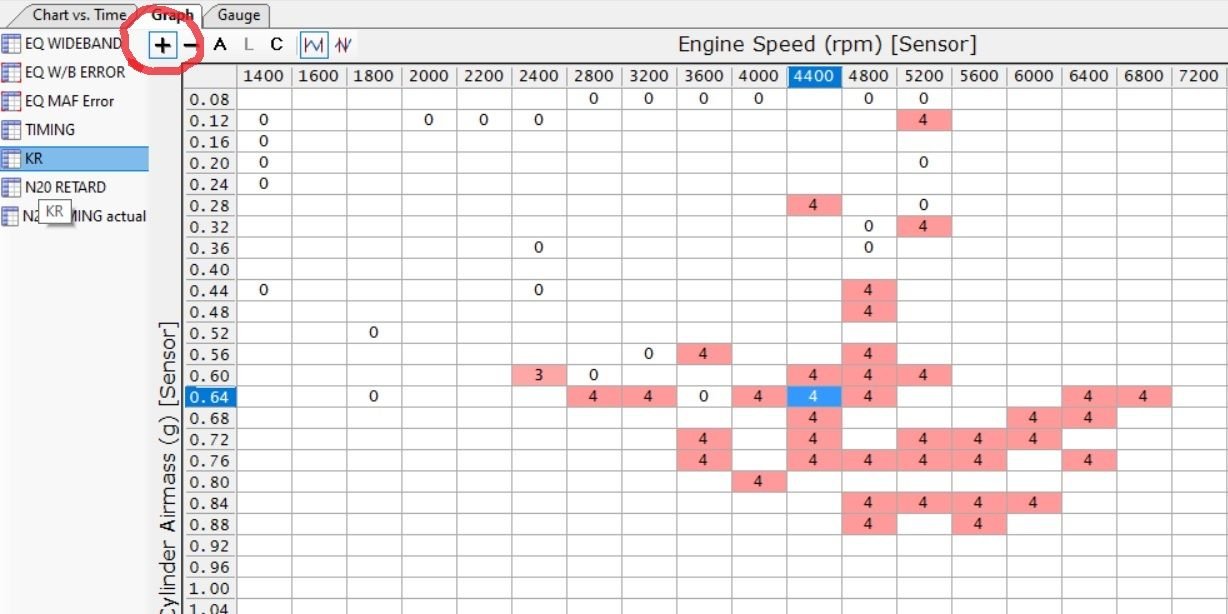

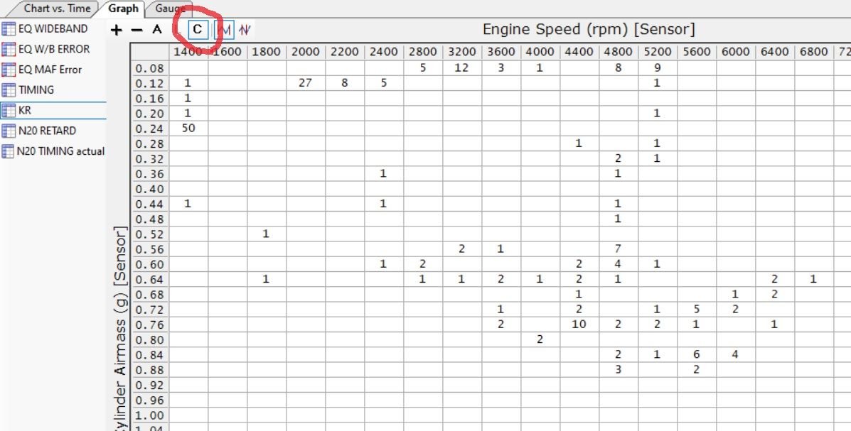

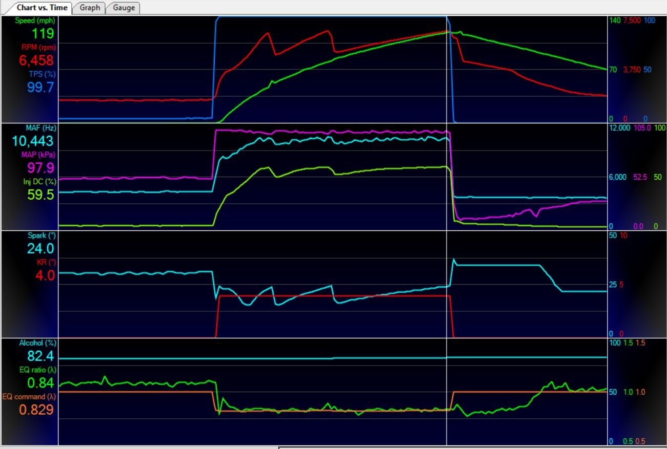

I attached some screenshots below, showing the KR reading on the datalogs

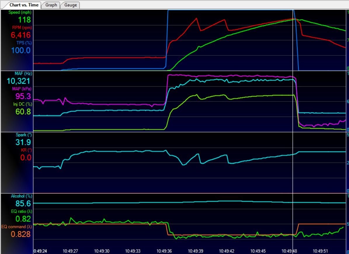

Run 1, zero retard

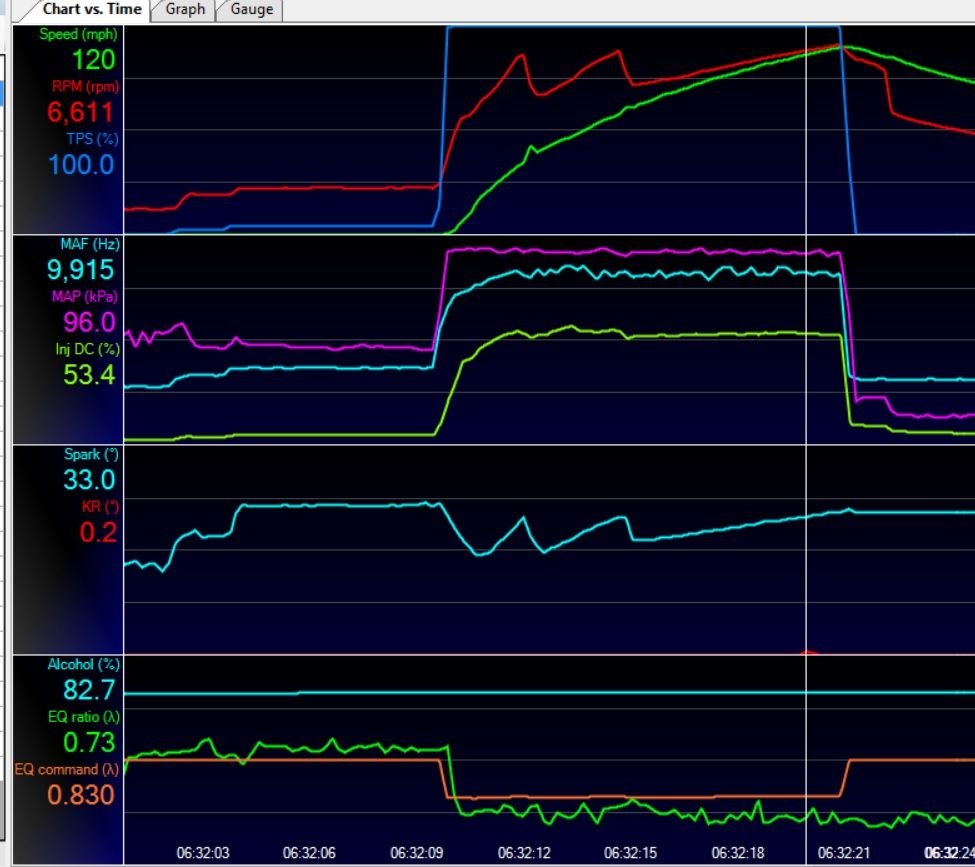

N2O run, a slight, and quick blip of .2 degrees retard, probably registering before the LNC-2000 did it's job of retarding for nitrous.

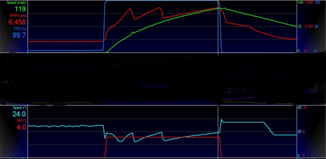

Screen shot of Burnout, also showing KR

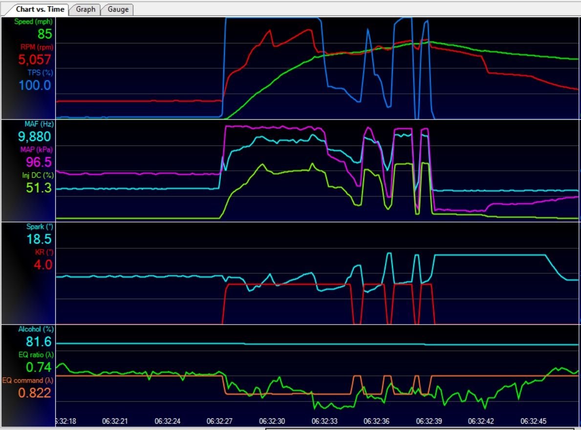

and Run 3, NA, with 4 degrees KR (Don't mind the throttle blip at the end of the KR reading. This was a bracket race, so whomped the throttle there at the end...
My "GUESS" is that the nitrous pass...my 1st with the too tall for 26" tires, 4.11's, got something LOOSE, or out of alignment, causing the KR readings...or I simply have a bad pair of sensors again...
Any feedback, opinions, suggestions, advice, I'm all ears...
RUN 1 N/A, no KR
Next run...N2O pass, no KR
BURNOUT BOX, 4 degrees KR, on and off the throttle...
NEXT RUN, NO NITROUS, 4 degrees of KR, mimic-ing throttle position

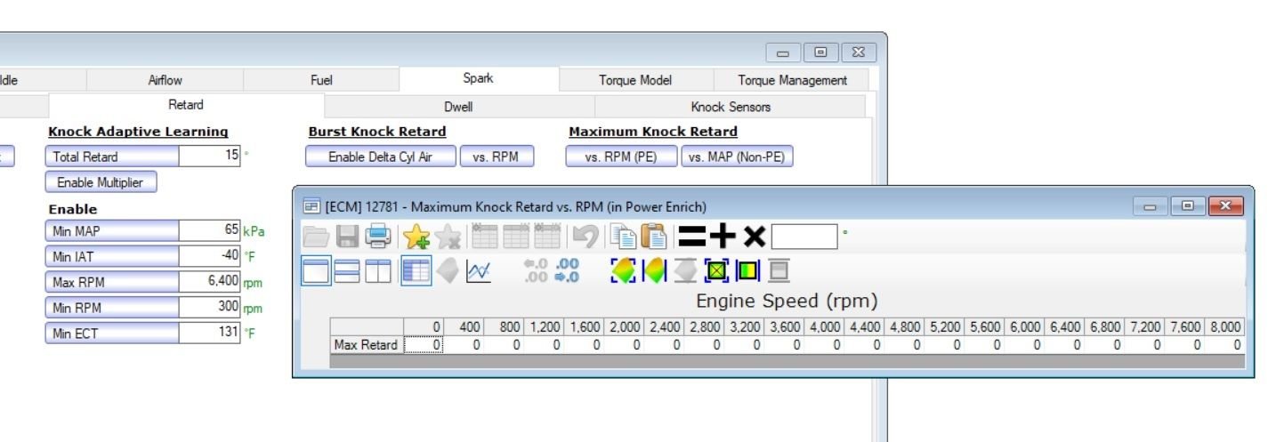

Yes when it throws a code for the knock sensors it will default to the max retard specified in that table at WOT. If you've already replaced them and the PCM still doesn't like them about the only thing you can do at that point is to just disable those codes. Also disabling those codes does not disable the knock sensors and they can still pull timing, etc.

So, if I say screw it, and decide to ZERO OUT the table, it will NOT (i.e; can't) retard at all, correct?
Hi Rel,
Correct. It will still retard the timing, but by 0 degrees. In other words, no timing retard. 0 out the tables and you're good to go.
Just understand the potential consequences of this, as I'm sure you're well aware.
Which is why Brandon is asking if you've checked your plugs (all of them).

The reason I don't believe it is "real" knock is because on the 4 logs it is there, it is instantly there and mimics the throttle. As soon as I go WOT, it is 4* kr. Soon as I let off, zero kr... There is no erraticness or buildup to the 4 degrees...just instant kr with WOT but no nitrous and on straight E85.

Then same exact KR (matching 100% TPS position) logged for the next 4 passes

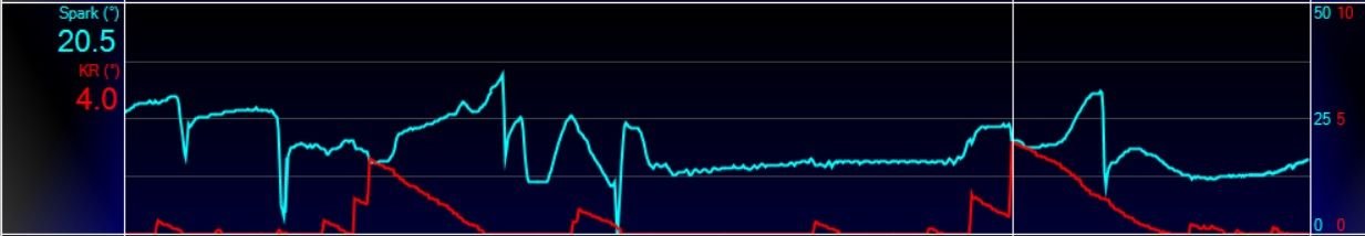

I was under the impression that REAL KR shows up as "steps" or sawteeth, on a datalog, like my truck did when I first got it...
2008 Silverado KNOCK RETARD stock, un-tuned, NON FLEX
TRUCK:
Not like how this one is showing up?
CAR:

Originally Posted by rel3rd
P.S. Not trying to be a hard head...just puzzled as to why the 4* is in direct correlation with the throttle.
Mostly puzzled as to why it would be doing it in the burnout box, with virtually no load whatsoever??
When it goes into PE it will trigger a static max timing retard with a pending knock sensor code as a fail safe, I can't think of any other code off the top of my head that will cause this same exact condition. This is the last time I'm going to repeat myself.

I just figured since 28* was what it liked on the dyno (and the track), with 93 unleaded, a safe bet with the extra octane from the E-85, was to simply add 3* until I could get back on dyno. It ran 2 mph faster and 2/10ths quicker doing that, FWIW.
Assuming the car has too much timing, even though I have made several passes with zero KR as it is configured right now, any opinion why it could, or would, even see KR in the burnout box?
I grabbed a screenshot of the KR Graph. KR is locked at 4*, as it's MAX VALUE, it's MIN VALUE, and it's AVG VALUE, even in all the cells that only had just ONE hit? That doesn't make sense, does it?
