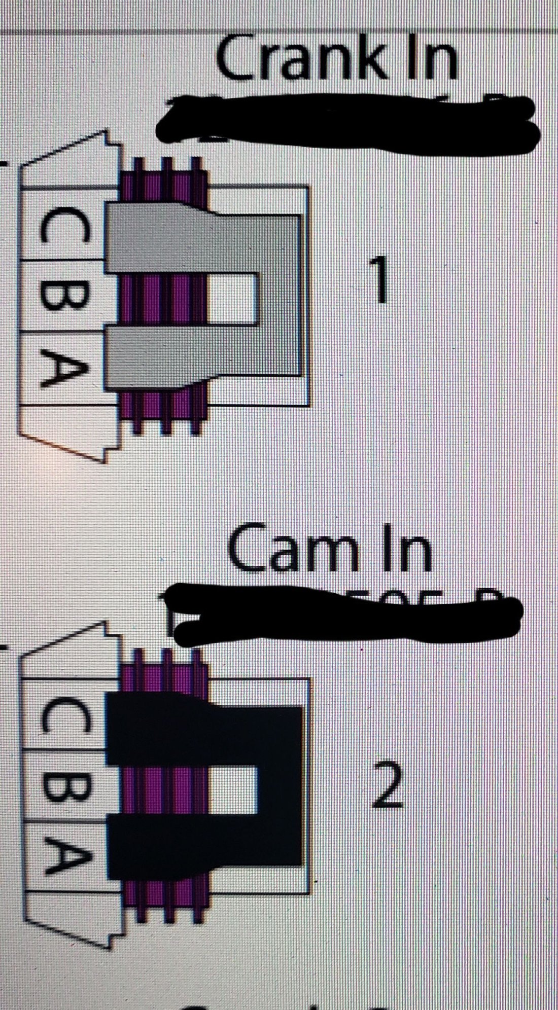

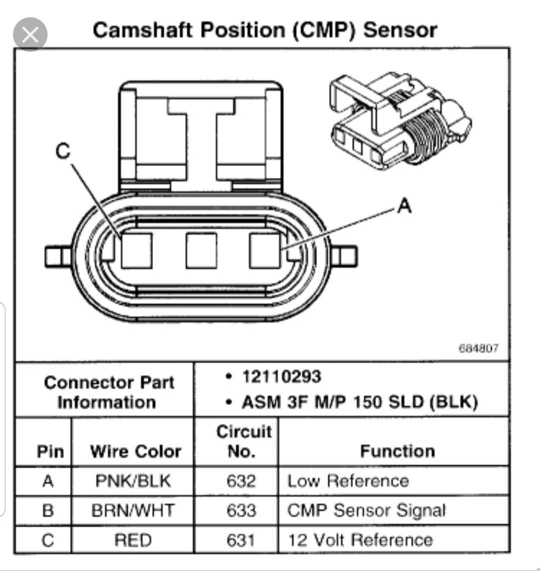

need some help have good cam n crank sensor not sure wiring is correct this is a gen 3 lq4 2005 silverado
cam A brown/white signal
B pink/black ground (low)
c red 12v
crank A signal
B ground low ref
C 12 volts
is this how gen 3 cam and crank are labeled at the plug or is the cam like this
