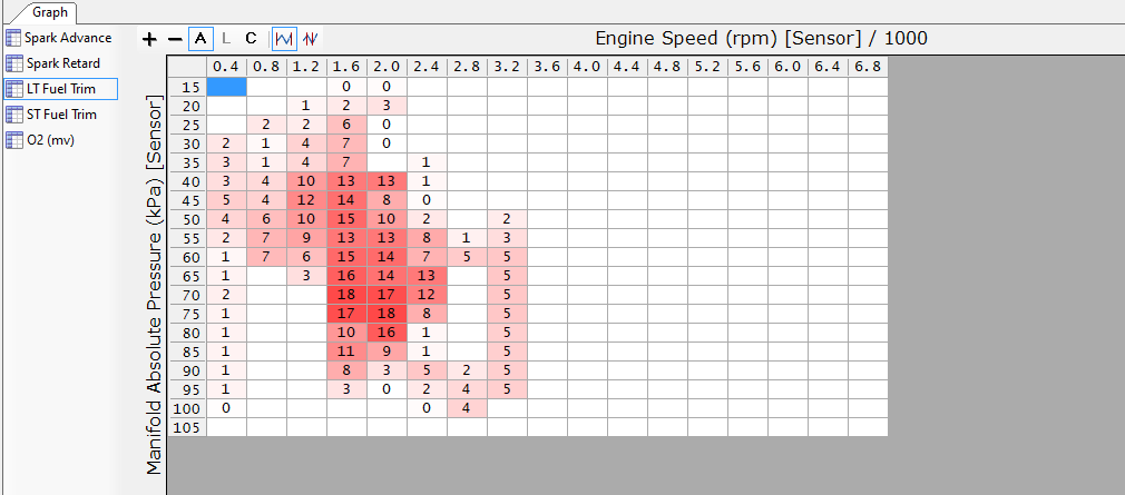

i did notice while logging that the LT was 10-15 maybe a little more in the red.
i'm going to edit VE to add fuel.

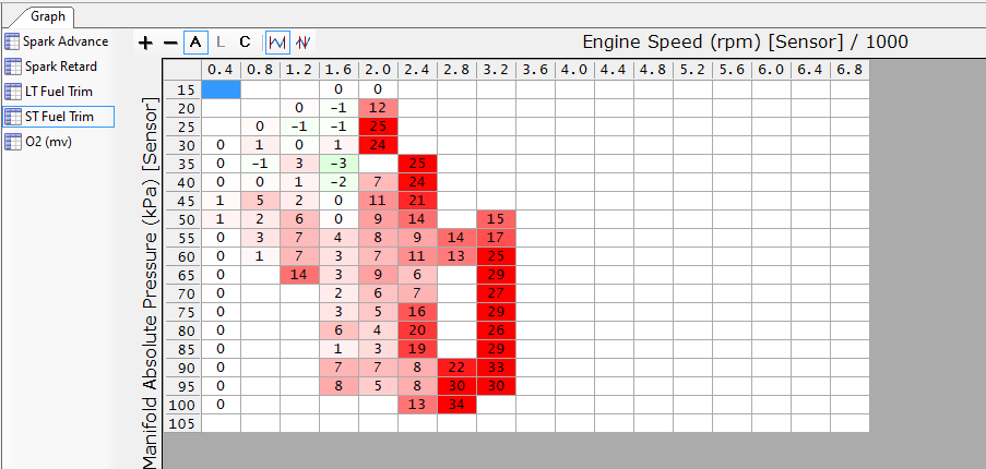

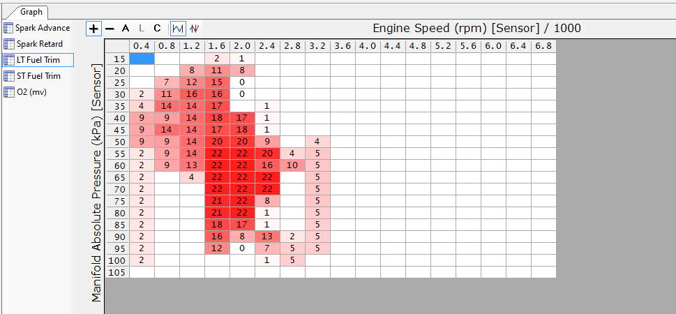

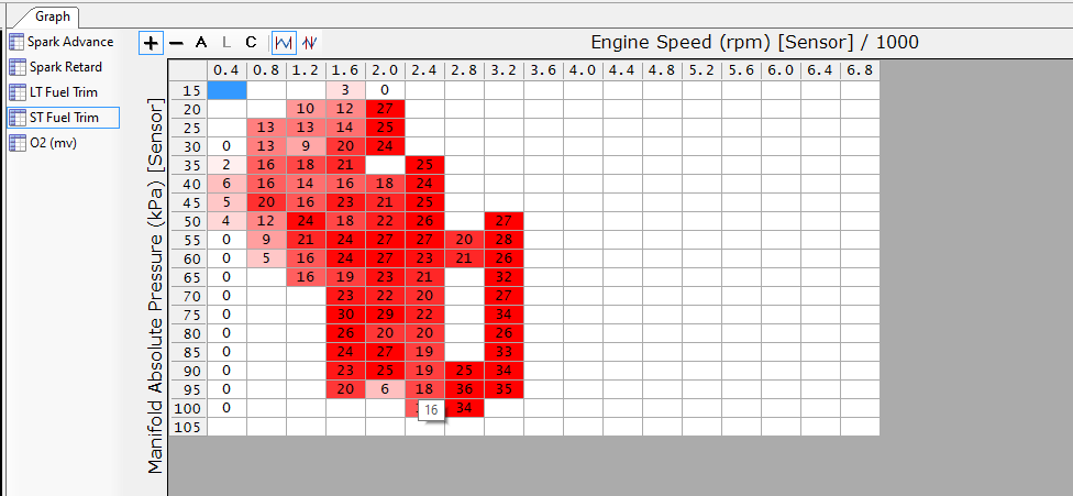

ST are bad too.
LT average
LT max
ST average
ST max

i added 15% fuel to the primary and secondary ve table and the flat spot is gone, the LT its 0-+3
but the ST is still +20+ really high. but it runs smoother.
