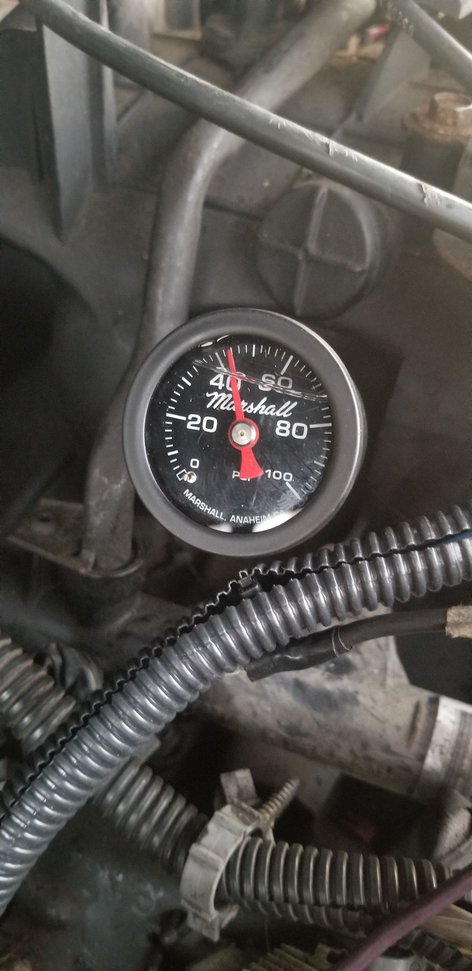

So I installed a fuel pressure gauge on the rail where the 1/8 NPT connector is with a schrader valve. The fuel pressure while idling is around 45 if I leave the vacuum line to the regulator in, and 58 with the vacuum line pulled. Fuel pressure is constant when revving the engine cold. The problem arises when the engine warms up, after driving it around for 10 minutes or so. I put it in park and went under the hood and revved it. The fuel pressure was dropping down below 20 when revving the engine. So I'm really lost now, and advice would be greatly appreciated.

Make sure you have 12 -14 volts on the fuse going to the fuel pump.
It seems like your pump or regulator is failing, it should maintain 58.
Check your fuel filter it may be clogged. ether way you did find your problem. Motor not getting enough fuel.

I did check the voltage and was getting 12-13 volts, and the fuel filter is brand new along with the fuel pump. It just doesn't make sense for it to be the regulator because it was fine when I pulled it out of the truck it was originally in.

When you turn the key to activate the pump (without starting the motor) than turn the key off, does it still show 58, if it drops than you may have a bad check valve on the pump or the regulator is gone.
Show us a the video of the gauge under pressure "turning the key, wait 5 seconds than off" it should hold a long time.
