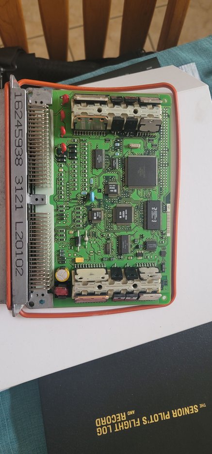

Old Feb 28, 2021 | 11:56 AM
Mad_Scientist_565's Avatar
Posts: 48
Old Feb 28, 2021 | 01:16 PM
B52bombardier1's Avatar
Joined: Dec 2017
Posts: 1,475
Likes: 270
From: Bossier City, Louisiana
If the written words on the PCM connector ends (not the wires) say "Red" and "Blue", its a 512k PCM. If the words are "Blue" and "Green", its a one megabyte PCM. I don't understand why they pull the stickers off.
The 0411 PCM's and the 896 PCM's are both 512k byte devices but the 0411's are said to stream parameter ID's a little faster - seems to be the same to me.
So, an electronic 4L60E trans with a 350 cubic inch engine - likely an LS1 or an LS6. And most likely a drive-by-cable throttle body but I suppose it could be drive-by-wire. Which is it?
If you are running a drive-by-wire throttle body, I'm less sure here. I know the P59 devices can run drive-by-wire and some can do both wire and cable driven throttle bodies but only certain part numbers.
What did your EBay seller tell you about the tune?
Rick

Old Feb 28, 2021 | 01:37 PM
Posts: 48
this one doesnt havent anything written on it . but i am sure its a P01 411. it doesnt have all the extra hardware on the back a p59 does and it does have the IAC chip.
