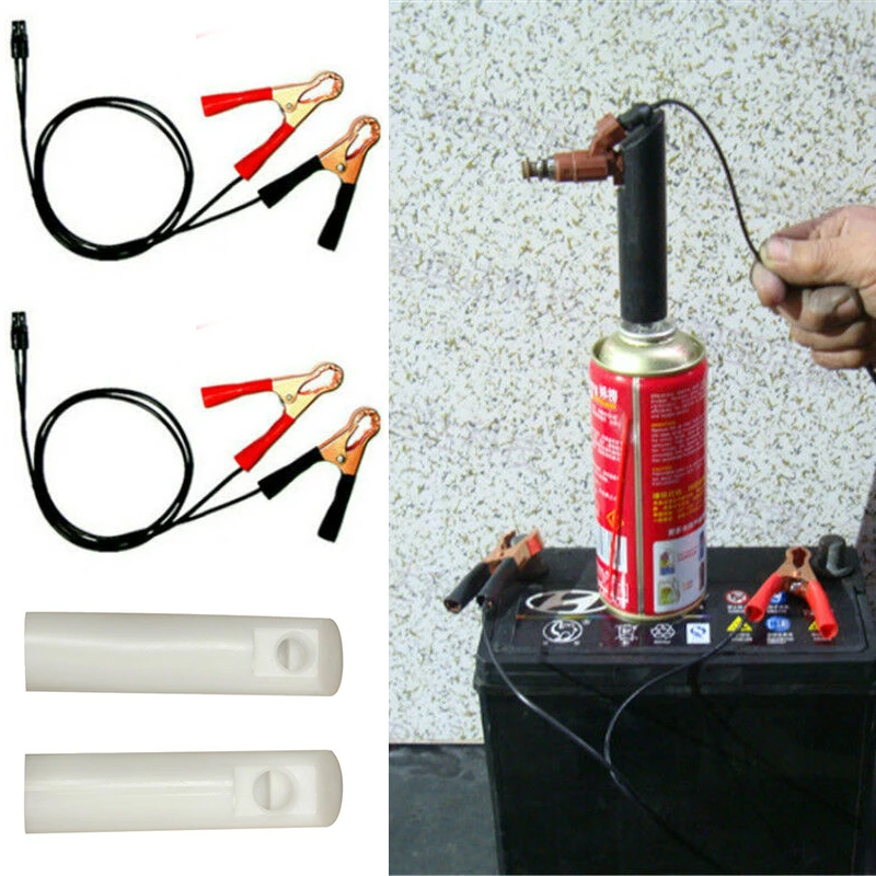

Tonight I removed all injectors and cleaned them with a neat contraption I found on amazon. The spray patterns looked good even before cleaning. No dirt on the screens

I would also get your injectors cleaned in a real injector machine after seeing the inside of your tank. I have the deal you posted a picture of and also a top of the line injector machine, cant compare the two.
