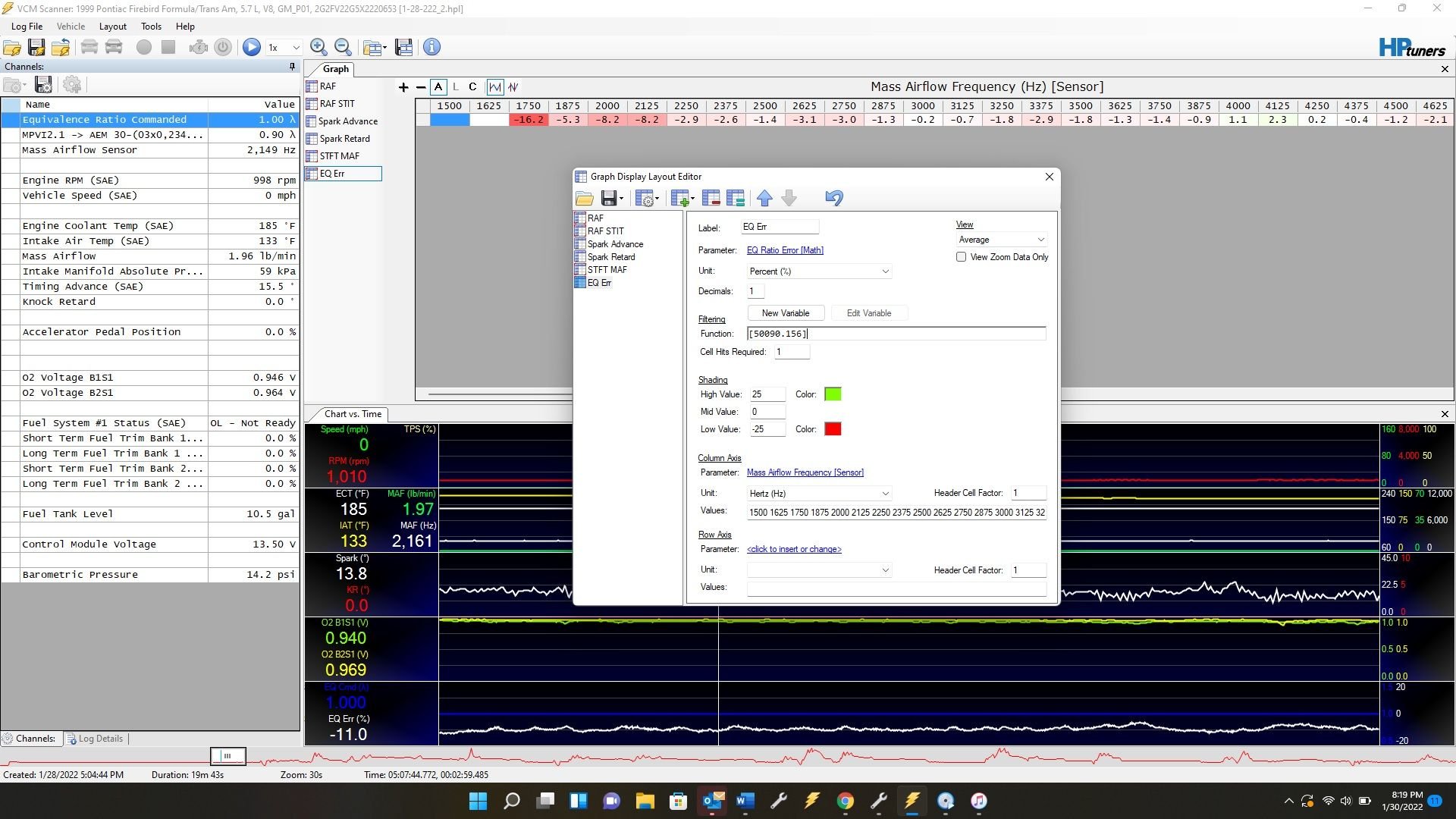

This is the way I do it.
Go to your chart and add EQ commanded
Then add EQ Error, it's under 'Math'-'Lambda/AFR'-EQ Err
Then open up a new graph, select EQ Err
In Column axis, select MAF frequency
Copy the MAF column from your tune, past into the graph.
It will show the EQ Err in each cell of the MAF
Old Jan 30, 2022 | 08:23 PM
LilJayV10's Avatar
iTrader: (39)
Posts: 9,711
Likes: 999
From: Evansville,IN
I set it up off your log file and it works like it should.
If you have any other questions let me know.

What does function [50090.156] do?
Old Jan 31, 2022 | 07:21 PM
LilJayV10's Avatar
iTrader: (39)
Posts: 9,711
Likes: 999
From: Evansville,IN
You can actually ignore that, I deleted part of it but not the whole thing for some reason.
It's a filter.
50090.156 is the TPS, what I had originally was 50090.156 >90%
I was tuning WOT, with the >90%, the histogram won't start populating any data until the TPS is above 90%. It just cleans the histogram up and makes the copying/pasting easier because it filters out all the idle/part throttle part of the log.
You can add all sorts of filters, TPS, RPM, boost, etc.
