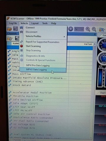

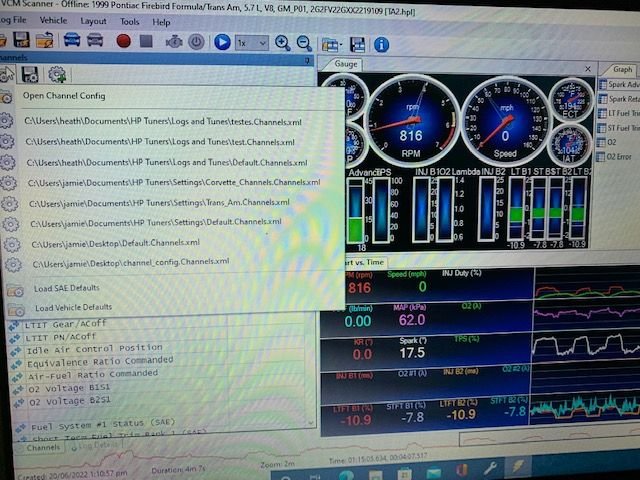

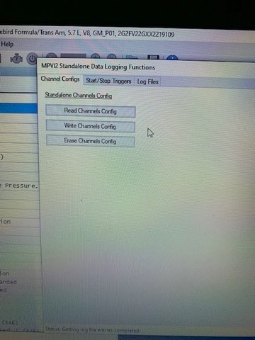

Here is a mini HOWTO for standalone logging.
First, connect the MPVI2 to your laptop's USB port. Launch the VCM scanner, open the channel config or create a new one. This will be what you want to write to your MPVI2 for stand along logging.
Open the MPVI2 data logging config.
Select "write" so that it will write the channel config to the MPVI2.
Lastly, go log! If you have the default setup for triggers, it will automatically start logging when you start driving.
