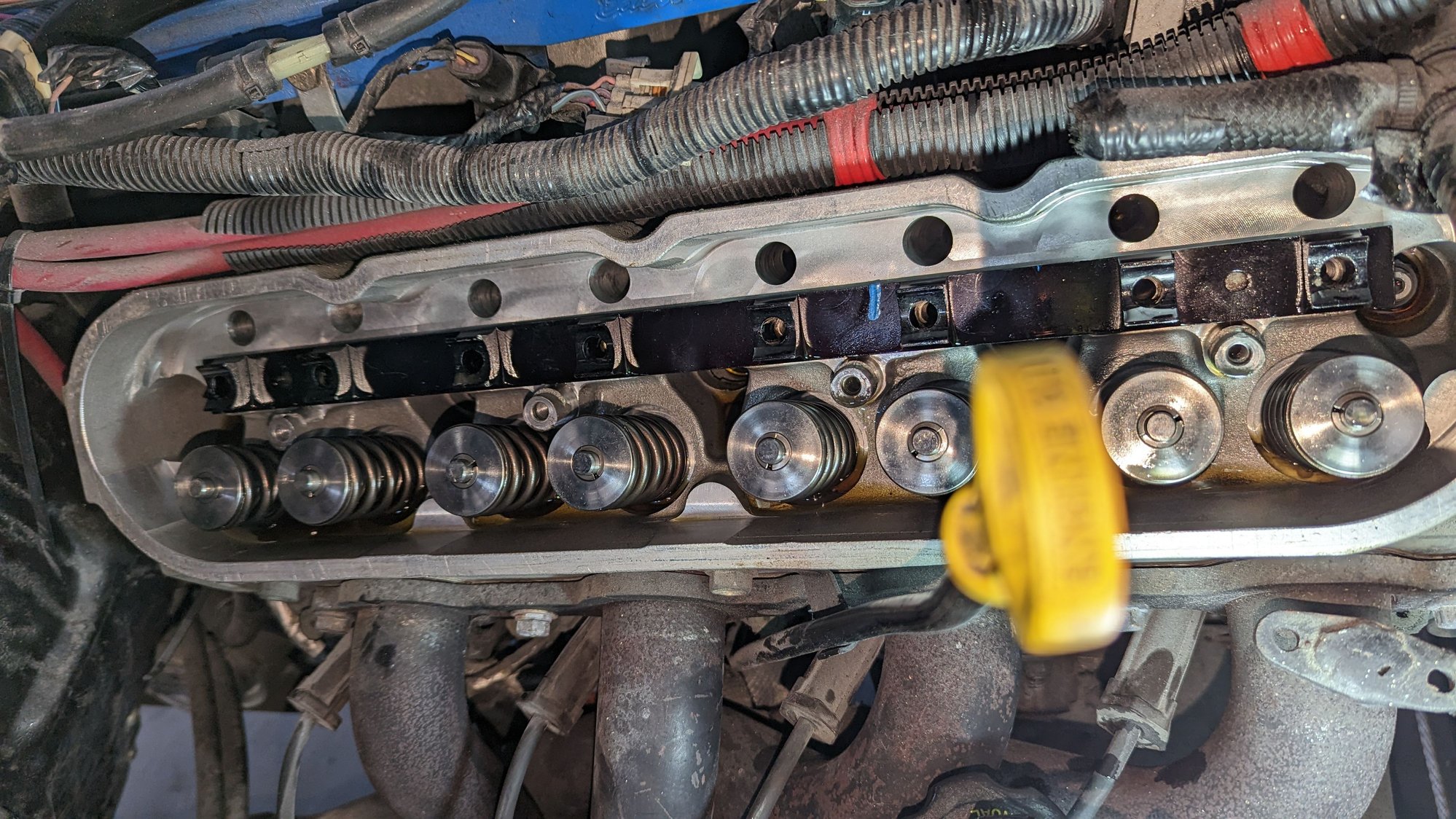

Been building this car for 10 years, now finally ready to tune and drive it. Than this happens before hitting the road. Never did head removal, springs before but being retired I have time to get it right.
Any idea what it is?

Slightest touch of the gas peddle the knock gets louder. Other problem is that I'm 1,500 miles away from my tuner and he doesn't remember what model springs he installed 10 years ago. So I have to figure out how to correctly measure them.

That dosen't sound like a rod knocking it's sounds valvetrain related to me. I'd probably drain the oil and inspect the oil filter first and from there I'd remove the valve covers and check the pushrods. What all has been done to the engine?

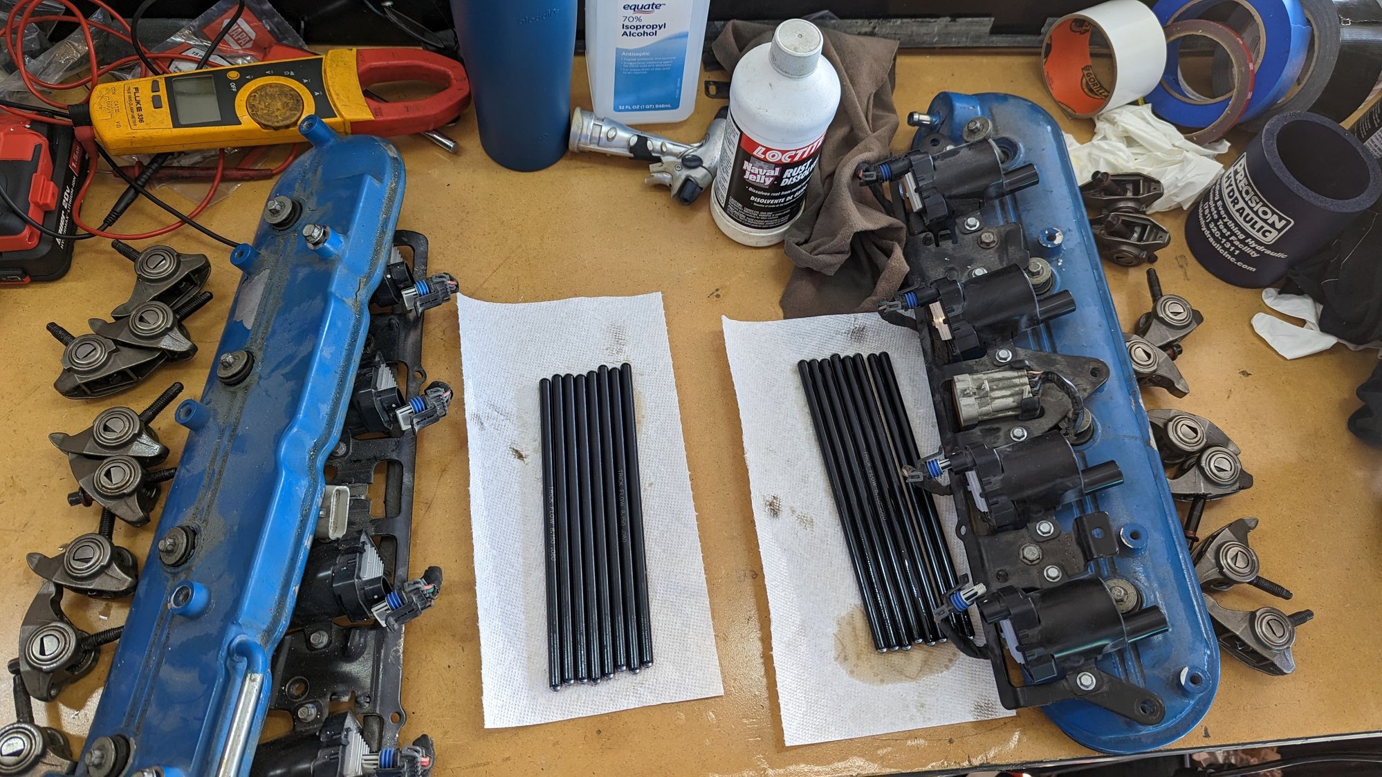

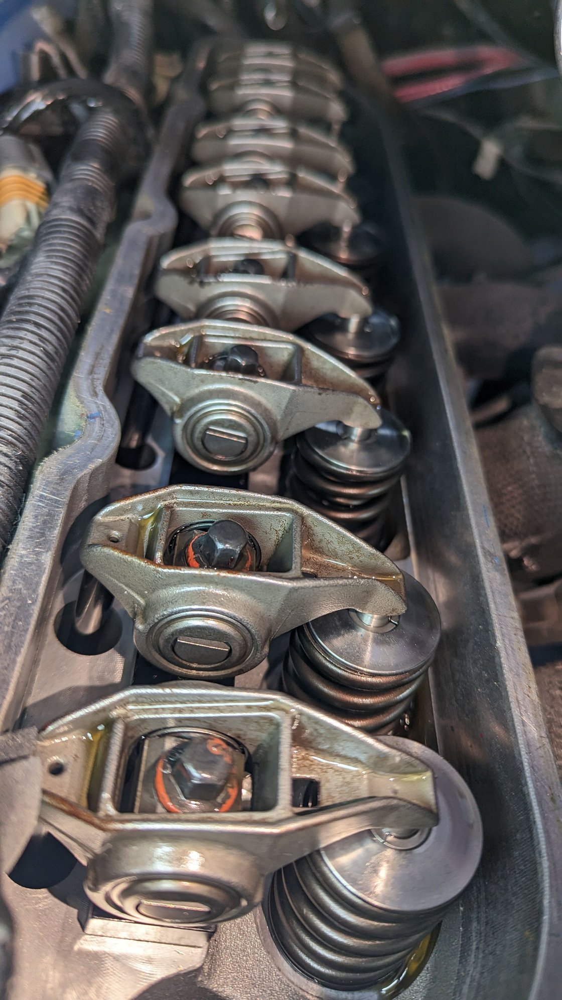

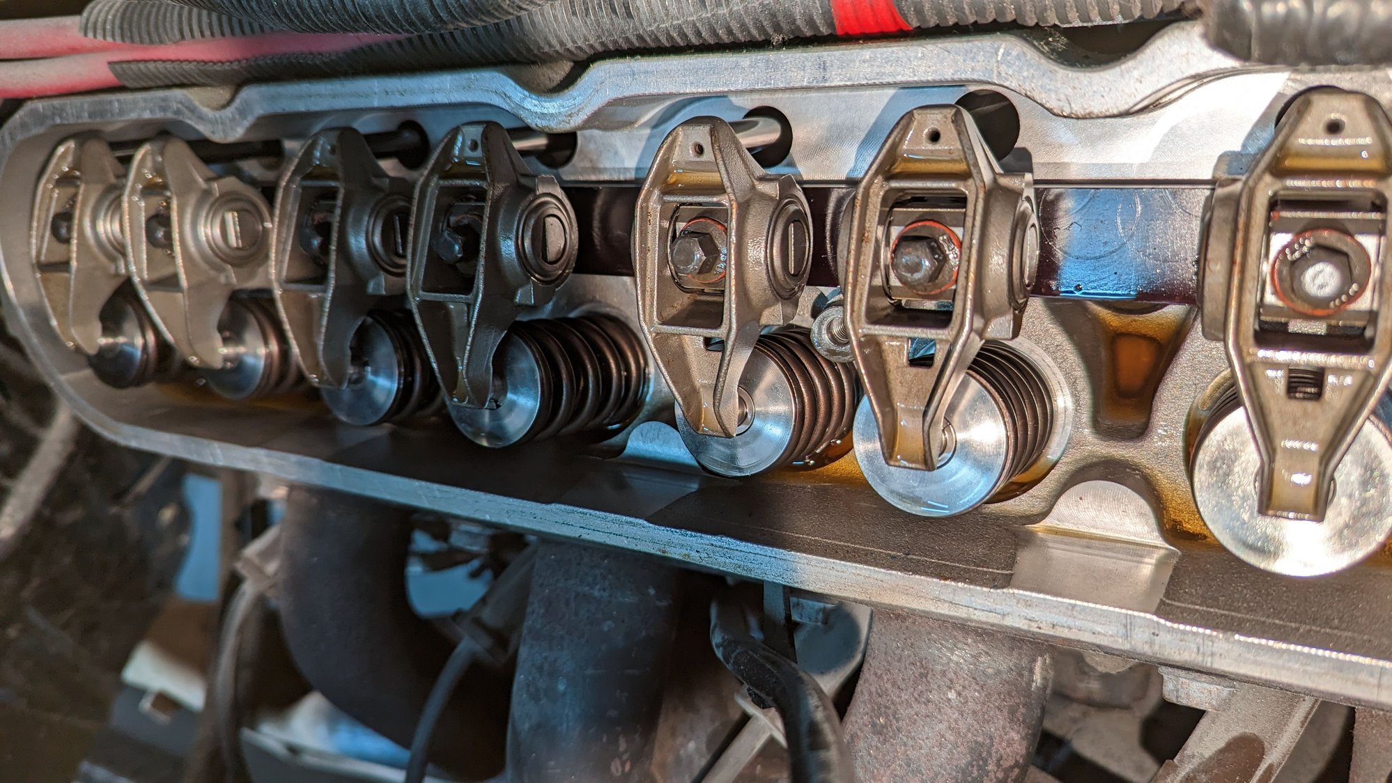

That dosen't sound like a rod knocking it's sounds valvetrain related to me. I'd probably drain the oil and inspect the oil filter first and from there I'd remove the valve covers and check the pushrods. Push rods are straight and like new. Rocker are perfect, At glance the double springs look good but that doesn't mean the small on the inside is not broken. Next I'll do a compression test before removing heads.

Did you check all those rockers thoroughly? You may have lost some needle bearings which would account for the noise.
Wouldn't you normally see the rollor bearing?

If you're lucky you'd see needle bearings on the top of the head under the cover before they make it in the pan. Many people will ditch those caged needle bearings and install a bushing style trunnion and CHE makes the best one if you ever decide to upgrade. Those LS lifters are very forgiving and don't quote me on this but they operate in the .070 preload range. Many people use the OEM style lifters and those plastic trays that hold them but I'll always use link bar style lifters for a performance engine. BTW I noticed the PR length was 8.15 on your pushrods did you verify PR length?

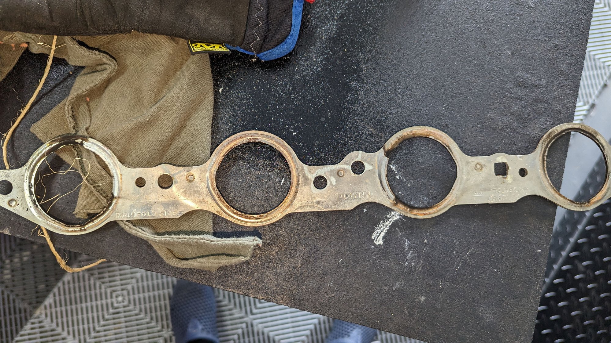

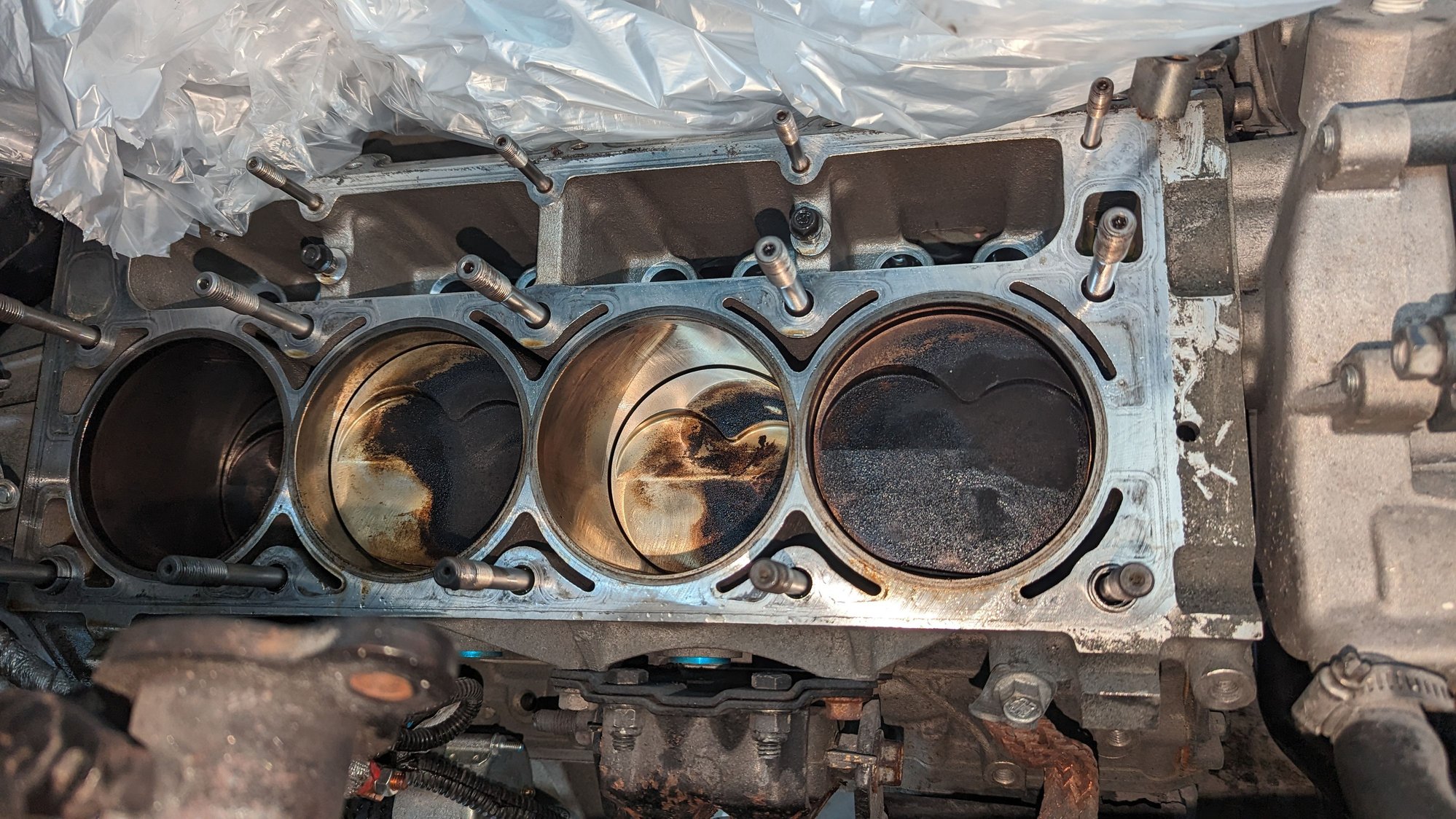

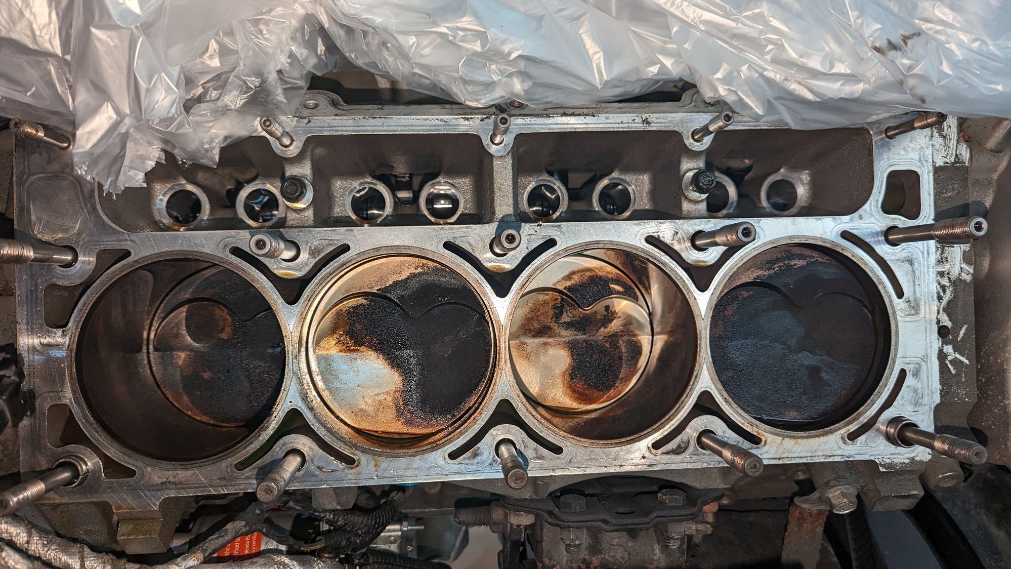

Many possible causes for knocking. Headers had a small leak, possible sucking air back into the chamber. All the carbon on the pistons and heads may do it also.
New rockers should be here tomorrow. I have some major cleaning to do.
Do I need to replace that style of head bolts?

Those look like ARP studs to me which are reusable. Just make sure they're in hand tight and use ARP fastener lube on the washers and nuts to reach proper torque.
