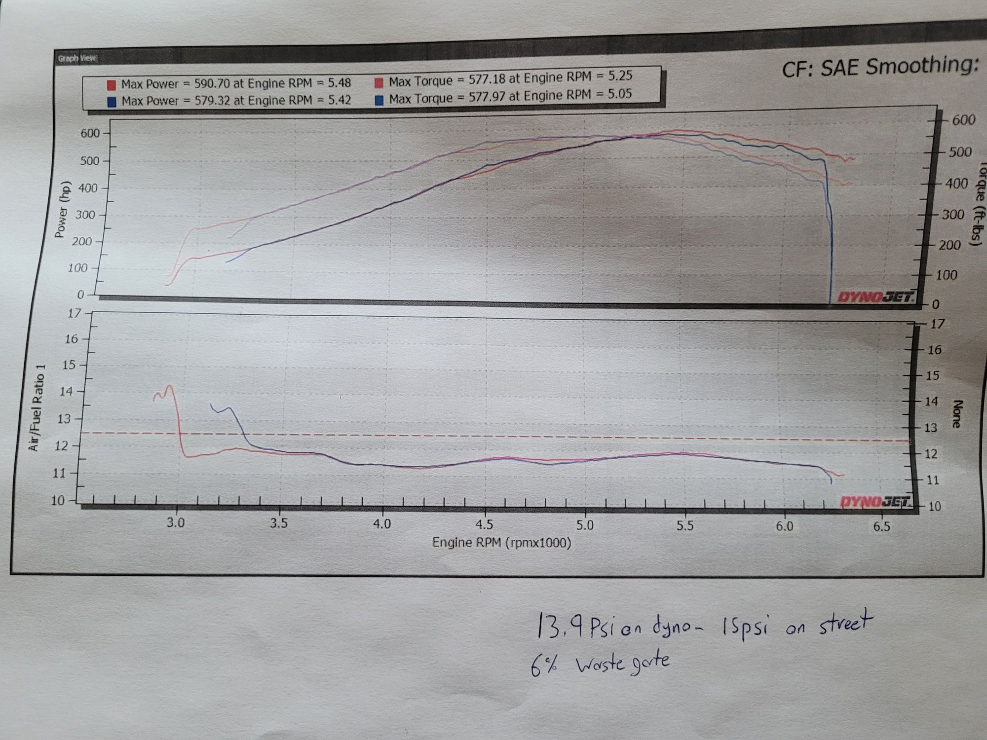

The 2nd post has an awful lot of assumptions. I know you never posted a tune which is why I said it would be a total guess without one and the log is missing all sorts of information. It's only 7 degrees on one tiny spot and that may be just fine in bringing the load in 4th gear because I have no idea what kind of boost it's running, and no dyno graph showing the curve, etc.

Weird I swore boost was in there, it's on 15lbs. And this was the dyno sheet.
