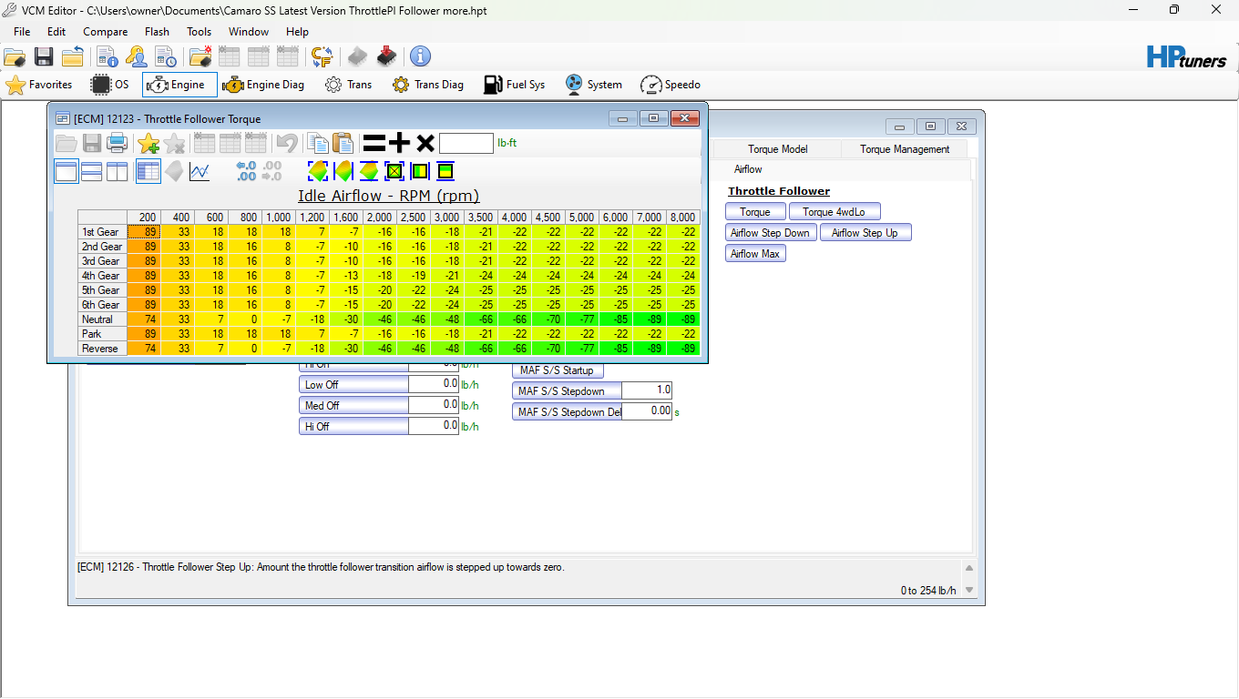

Go to idle--throttle follower--torque and change the numbers to what I have in my tune. i have a larger cam and no surging.
Your VVE table needs some work also. It is "not smooth" in the idle and off idle areas. Also, Both open and closed tables should be the same. Also do a little work on your MAF table. Be sure and make a copy of your tune before you make the Throttle changes, so you can revert back if it doesn't help.

So I played with the torque follower table with no noticeable change. I also disabled the CT downshifting in case this was caused by transmission tuning. This also did not change much of anything. I'm really starting to wonder if this is caused by the rich condition (about -25% according to my wideband) I have at low RPMs and idle on decel. I have not really done any MAF or speed density tuning at this point because I just assumed this was an idle issue. What is the correct order to tune idle, MAF and speed density tuning? Should you get the idle good enough to drive then do MAF and speed density and return to perfect the idle after?

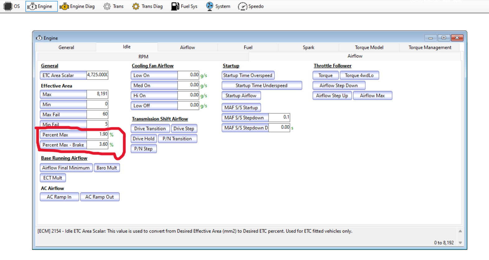

Yes man, when you have an aftermarket camshaft, getting the afr on its point becomes critial, especially on idle. And it becomes more notorious the bigger the camshaft is. There is also a parameter you want to modify that determines how open your throttle body can get in order to maintain a good idle control.
