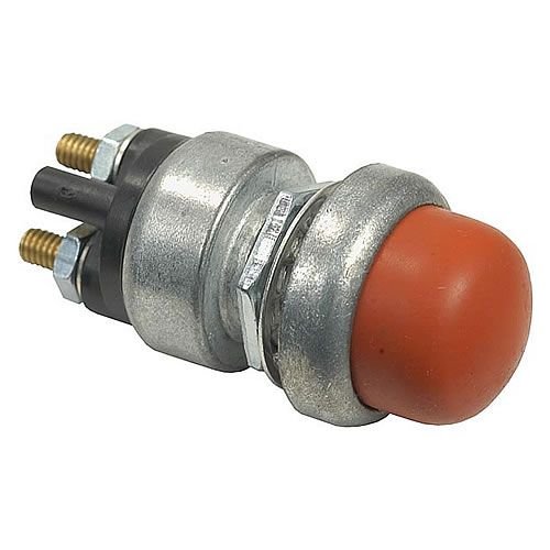

Analog Solution: 50 amp momentary START switch. Wire direct to starter solenoid with 10 gauge wire. DONE.
